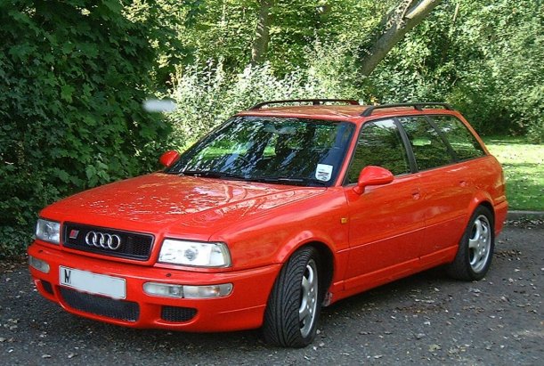

hi all
i hve recently purchased a RS2 in red! the metal strips that hold on the ext. door trim are all fairly ropy. my question is, can i replace the metal strips or do i have to get the complete door trims?

you have to replace the complete trims and have them painted it is also worth replacing all the clips. It is fairly common that the metal strips rot within the lower door trims and it ends up being disproptionately expencive to put right as the trims are about £70 + vat each from Audi and then there is the painting cost.
Having said that try VAG Parts www.vagparts.com or GPC VW & Audi www.gpcvwaudi.com where the may cost you about £55 + vat each
From my invoice I think the part part numbers for the front doors are: 8A0853959AGRU & 8A0853960AGRU. The clips are: 443853909A and you need 10 of them (for the front doors only). Do check though.
Or you could always take the metal strips out and glue the trim back on. :D I didn't do it this way.
HTH
Angus
p.s. nice car and welcome
