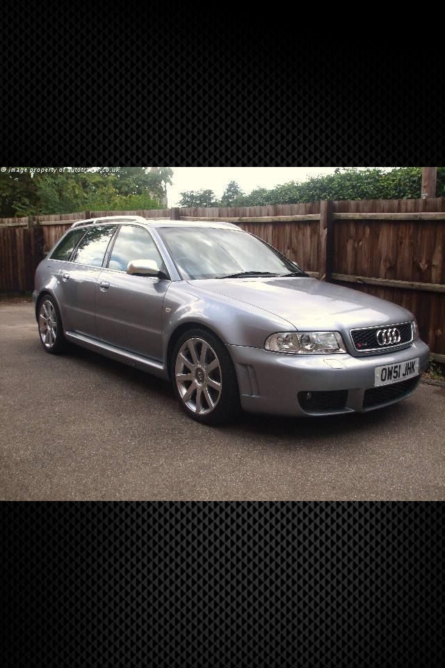

I was gna go see that the next day but when i called at 11am it was gone!!!
Is this it? I remember it was fcukin mint?!!!

Which MTM one? Avus, 85k?]
Yes I did buy that one and yes it's mint, the stonechip film is excellent and makes the car more of a keeper in my book.
I had an MTM stage 2 car in 2007 & 2008 and it was good but I am trying to keep this one stock.
