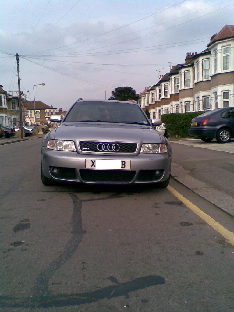

Interested in a brake upgrade, currently using stock brakes on a mtm 420bhp,

your brave! :) i changed mine within 3 weeks of buying my car and its not even mapped. standard brakes are a joke.
