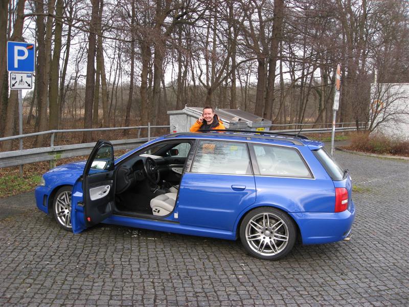

And bofore any commands about those wheels they are only for winter tyres :oops:
