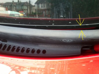

I am getting serious amounts of water in my passenger footwell. I think it happens when the car sits still, so what I am getting at is in theory it cant be a hole in floor, because this seems to be a serious amount of water literally inches deep I discovered today, so I am guessing this must be draining into the footwell from above. I notice the plastic trim on my passenger side window (Please see attached a picture) is not sealing against the window (the arrows show the gap) as the plastic screw that is meant to be holding it tight is f**ked so it hangs loose. I think my last mechanic messed about with the trim fixing my wiper motors.
Is the trim not sealing properly causing the problem? If so, where the f**k is it getting into my footwell? Or, am I looking at the wrong thing here? Just seems too much of a coincidence to me both the water and the trim issue being on the same side of the car.

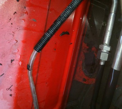

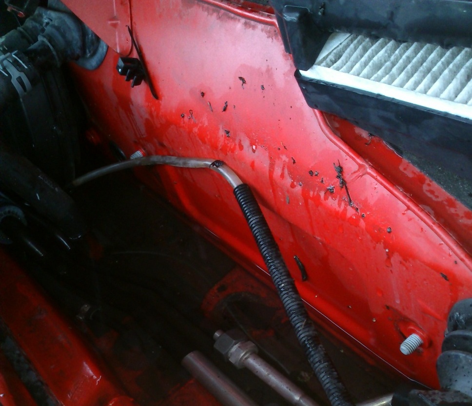

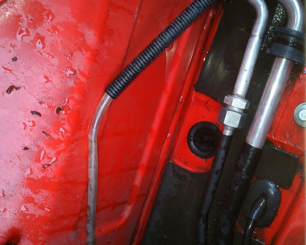

Ok, you were correct, so many thanks....look at the state of my grommet under the battery...!!
Blocked Grommet....
3 or 4 inches of water under my servo....
Water under servo
After a nice clean though.... :)
Cleared.....
I know my pics only show the grommet under the battery, the one under the servo was a git to get to with my hands, so I got the missus to get her hands dirty for a change....she did a fine job!!
So many thanks for your assistance!!! I have taken out my rear seat and front passenger seat now, lifted the carpet, now an overnight drying out process with a fan heater from B&Q! :)
