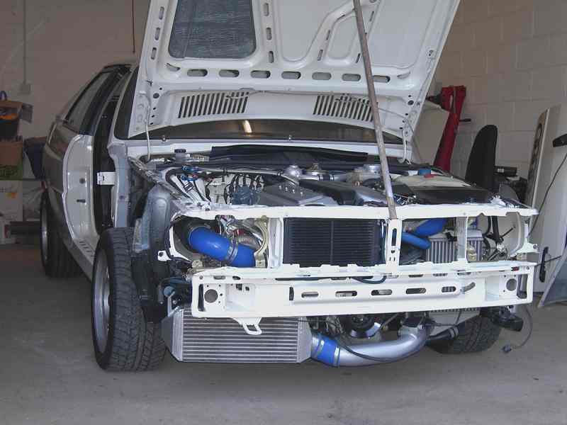

How about if i stuck with the standard intercoolers and added .5 water injection jets to the exit of both intercoolers. Air speed in theory should stay up with standard intercoolers and water has a dramatic effect on cooling if applied correctly + you can add a bit of alcohol...
I have carried out lots of tests on air speed vs lag i.e small intercoolers vs big and the best i have found is two small in line as attached. this also has water injection in both intercoolers. It runs 2.3 bar of boost and you only see 15 degrees rise in temperature from cruising to full boost with virtually no lag..

Now that looks like a bit of seriously modified kit !!!!!
RE: What would i expect to get if?
Tis.. to much really.. 0-100 in just over 8 if you have the nuts to keep your foot in.. no electronic help with this old girl.. Managed to do a set of tyres in 700 miles, try getting 215 50 15s..
The whole aim was to keep it looking standard, which it does when its in one piece...

Woohoo now thats going some!!!!!!! It looks like a no expense spared top quality job,well done that man,look forward to what you do to your b5
