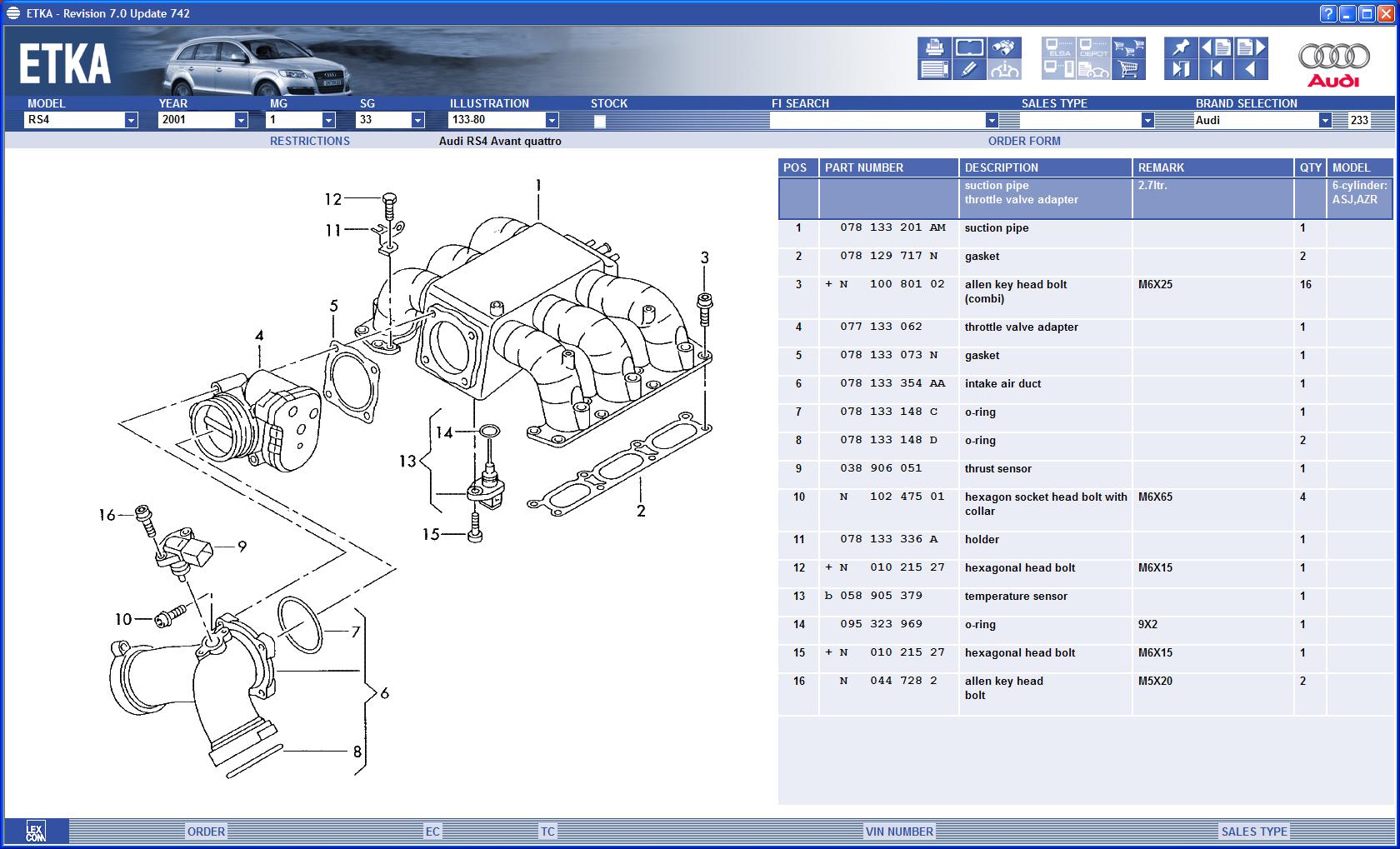

I have a boost leak from one of the inlets on the 'Y pipe', does anyone have the part number as Audi state you can't buy the seal, and need to replace the entire pipe???
Hoping someone can help, please see exactly which seal is required in picture below

078 133 148 D o-ring, costs about € 2,25 ex VAT. This is the one between the Y-intake duct and the pressure pipe.

See also attachment:
