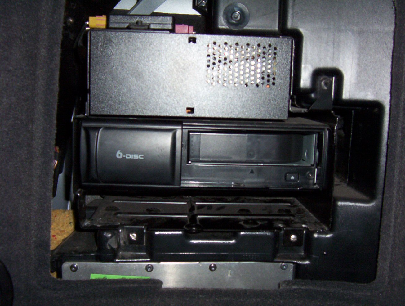

Do you have the TV diversity receiver box located in the rear quarter panel? It's the black box above the CD changer in this photo.
Sorry for the delay! Just picked the car up last night!! Well pleased with it to say the least. Its a mint original car with low miles and nice colour etc so very happy after looking for ages!!!
Right, back to my issue. There is a big gap above the CD changer so I guess the tuner is missing.
I need to have a look behind the panel, but do you think the wiring will all be there and just a case of connecting the correct tuner? Do you think the Nav plus will just recognise it and will work OK?
