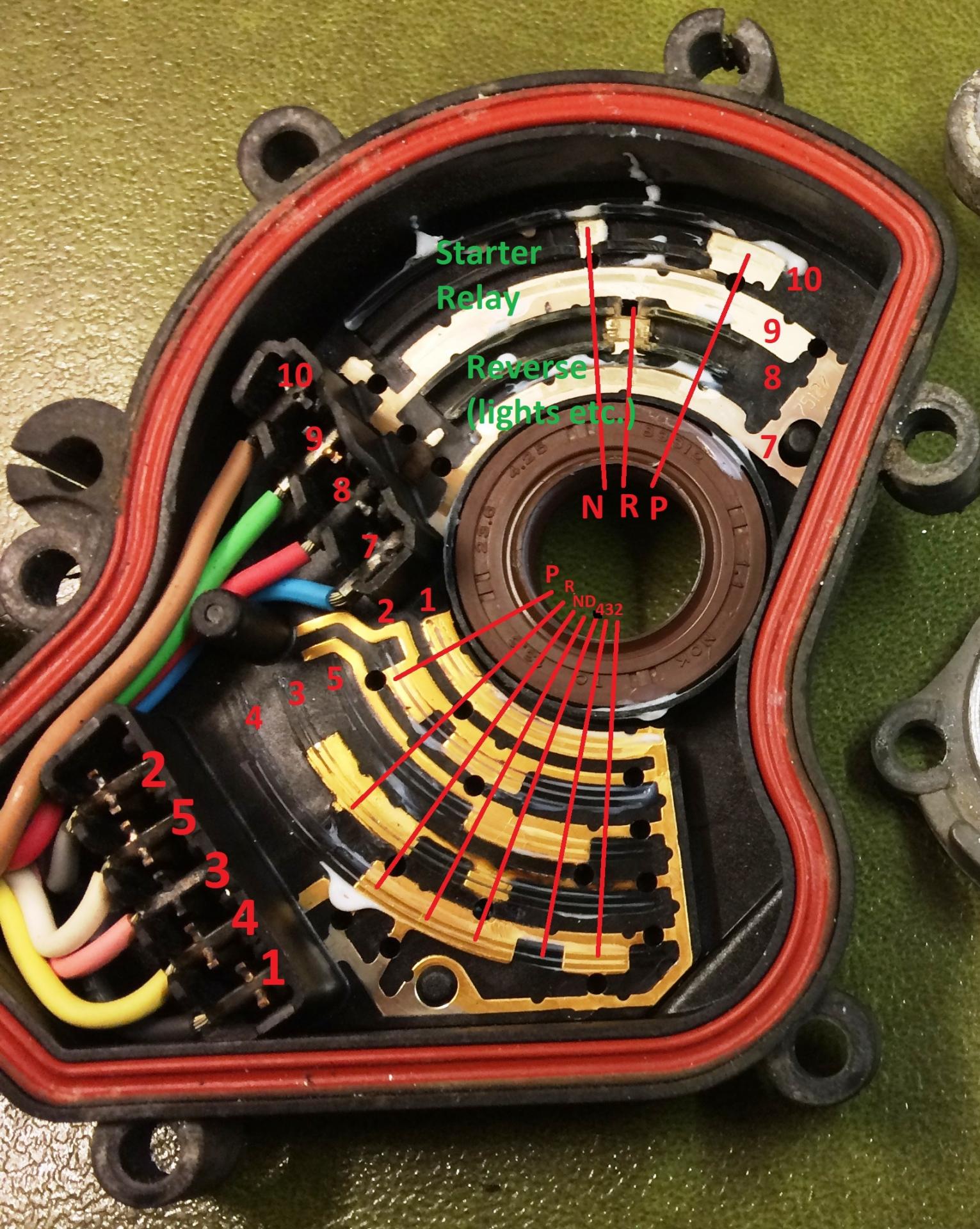

Re: F125 Switch or TCU - or something else?
It has the tracks/pins labelled. Something I did when bored a while back……….
Looks so '70s tech.
You should see the twin arms that move over those tracks! Very 1940s.....
By the way I think pin 6 is not just unused, it's actually not present in the F125 cable plug.

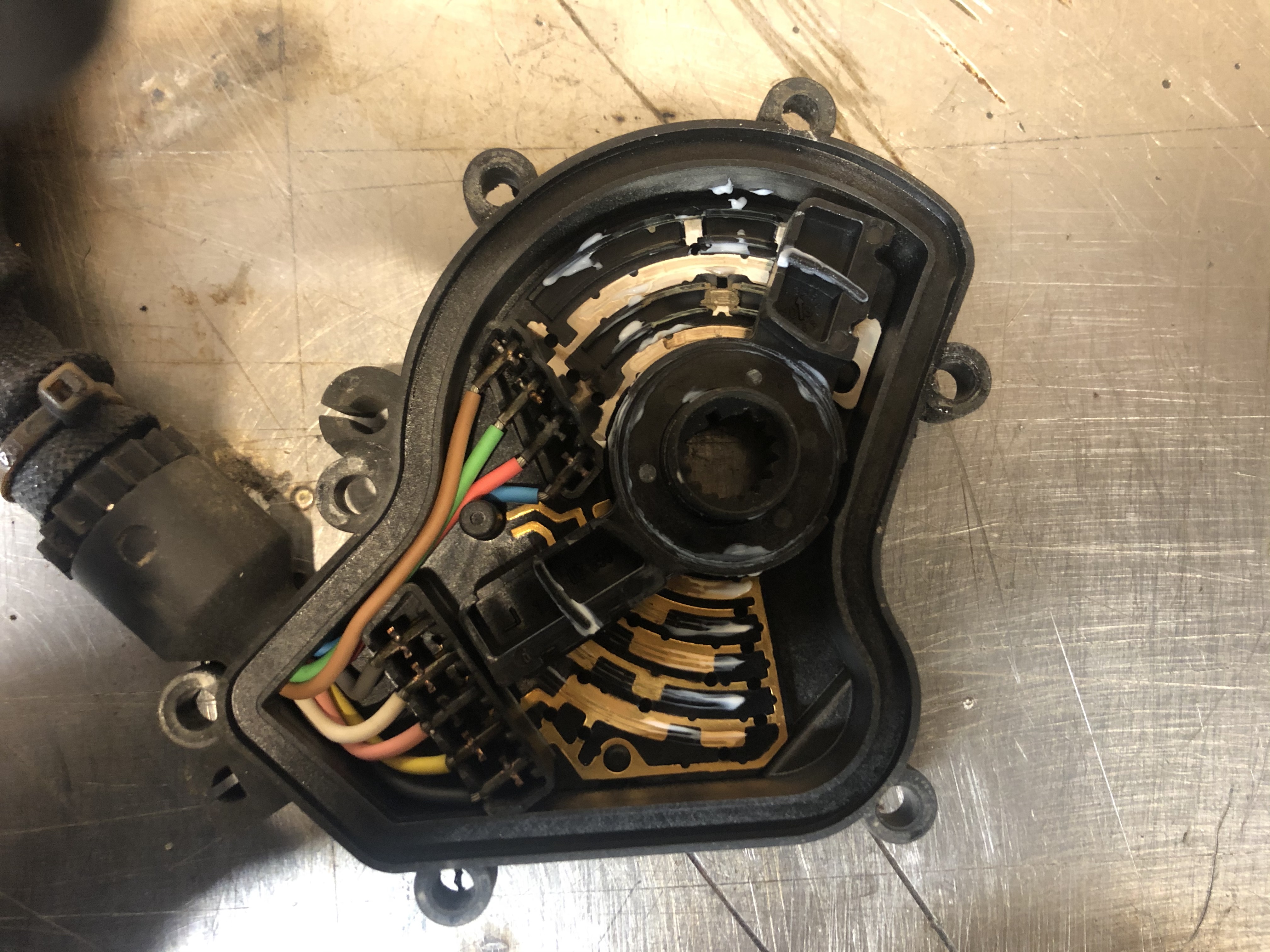

Here's the inside of my failed one, too. I assumed it was pin 8 that was causing the error?
Did consider cleaning it up & refitting - but the cost of the the switch compared to the aggro of replacing it wasn't worth it.
