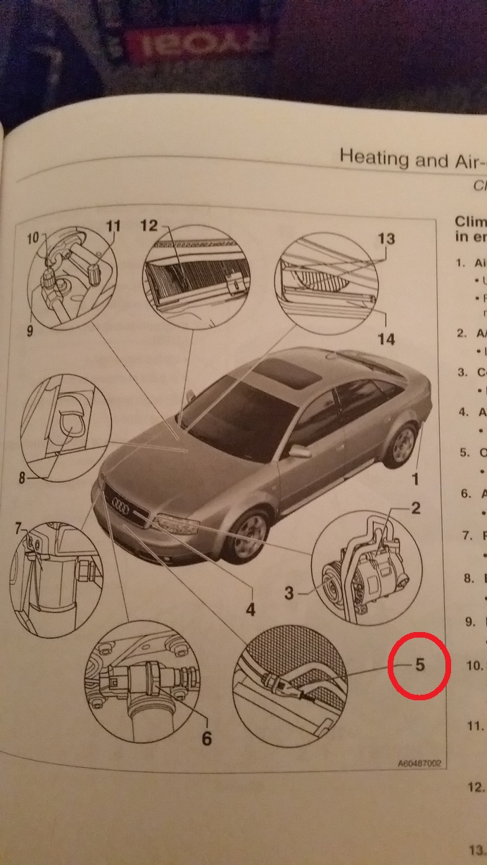

Anyone have a diagram or photo showing the location of the sensor. I've had a hunt all around the front of the car and I can't see anything that looks like it could be the ambient air sensor.

Nobby
Posts: 1981
Location: Oxon
Re: External temperature sensor
Post by Nobby » Tue Mar 01, 2016 5:31 pm
Have a look at this guide. The sensor slots through the plastic duct around the bottom cooler. The photo of the front of the of the car you can see just a circular black dot on one side (its not on the other side) above the bucket of coolant. Its quite low down though, near the bottom.

Post by ahoooga » Tue Mar 01, 2016 7:26 pm
From the Bentley manual that's;
2 inches thick,
500 odd pages long,
considered to be the 2nd most important reference for repair ( after VCDS),
costs a fortune
Item Number 5 - Its THAT important, the picture is the only mention of it in Bentley :piss:
You'd get more accurate temp info by sticking your head out of the window to see how hot/cold it is.
