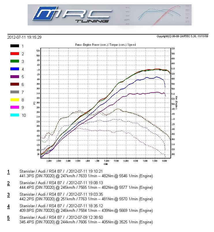

Done my 2 weeks ago at MRC. Stock dyno run with broken solenoid - 345PS, 405Nm.
After carbon cleaned, manifold polished, cold air intake fitted, full Miltek non-res valved with 100cell cats installed and Stage2 remapped i got 444PS and 482Nm
Thanks MRC!
Thanks MRC!
Cleaned, ported, cold air intake, full non-res 100 cell Miltek, MRC St2 = 444PS&482Nm)
