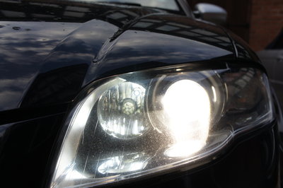

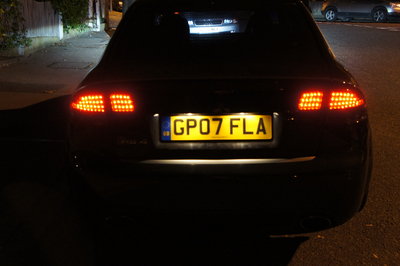

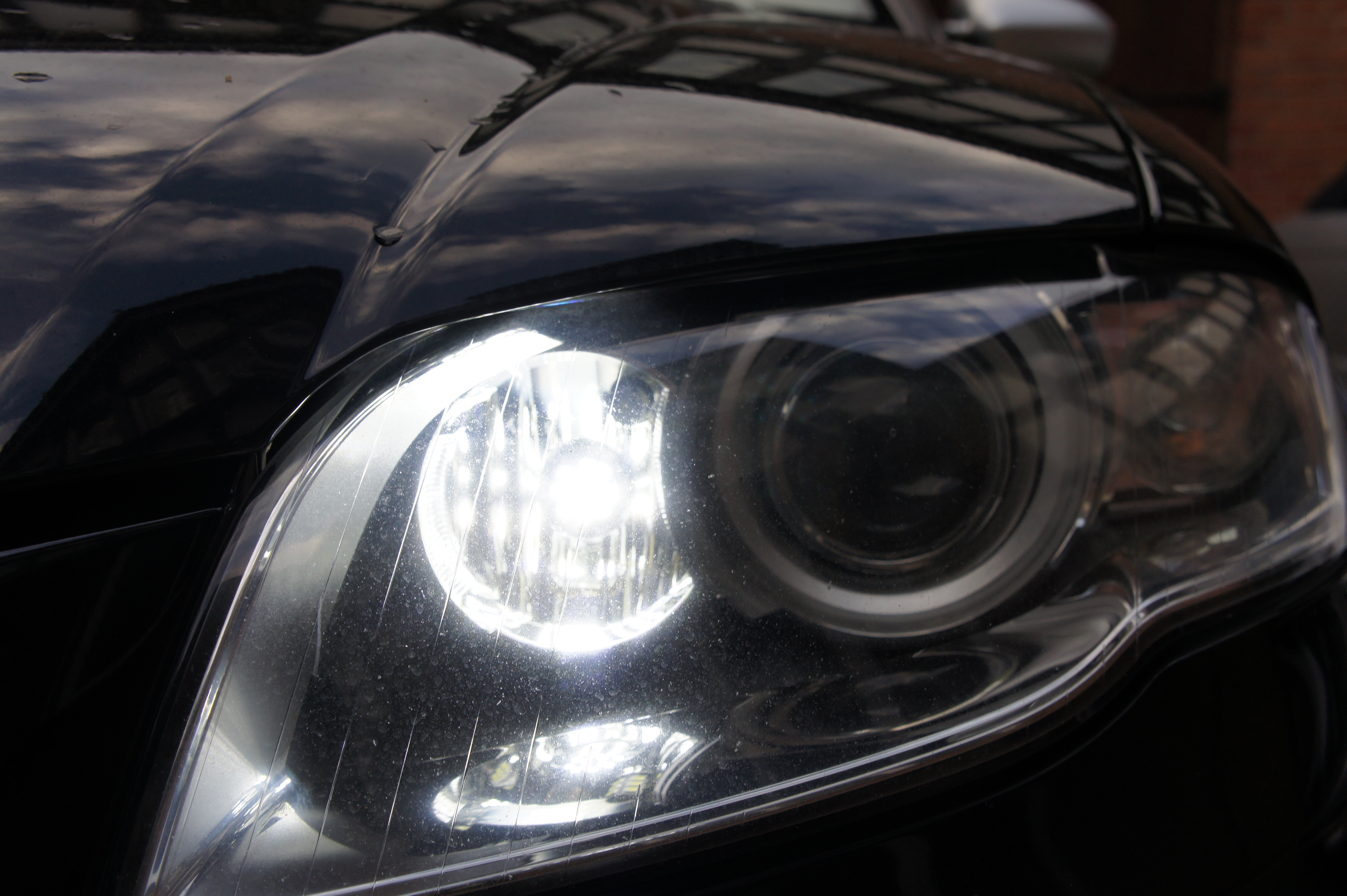

Here are some piccies. I have more but my number plate is showing still (need to blur it). The number plate shown doesn't exist anymore.
Rears lit:
LED DRL lit:
Dipped (xenon not LED) and LED sidelight (note; the LED DRL can be seen unlit):
