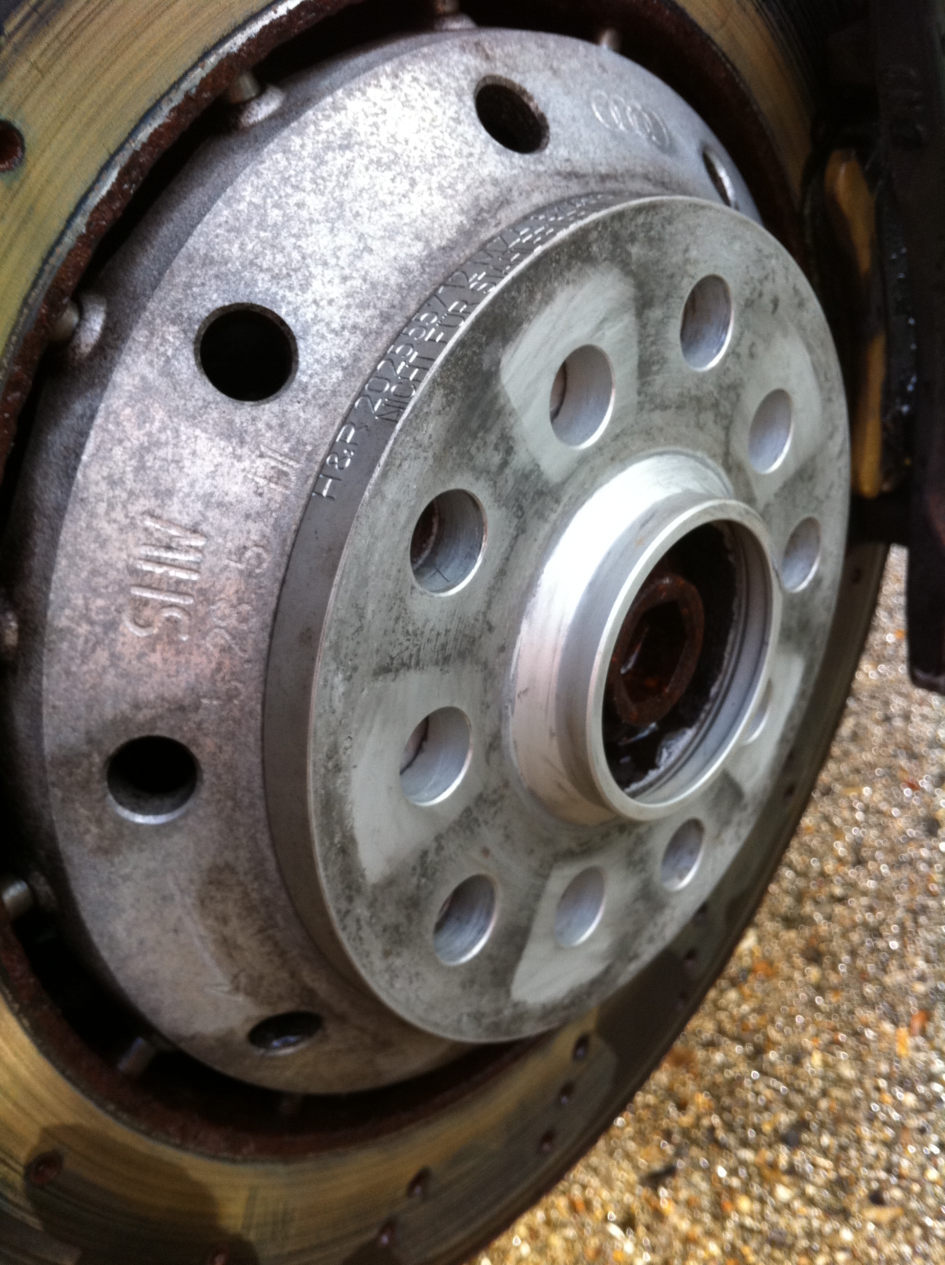

Whats the best way/method/product to clean the rear break disc bells on the RS4, tried a few products with no results.
Ignore the spacer in the pic.

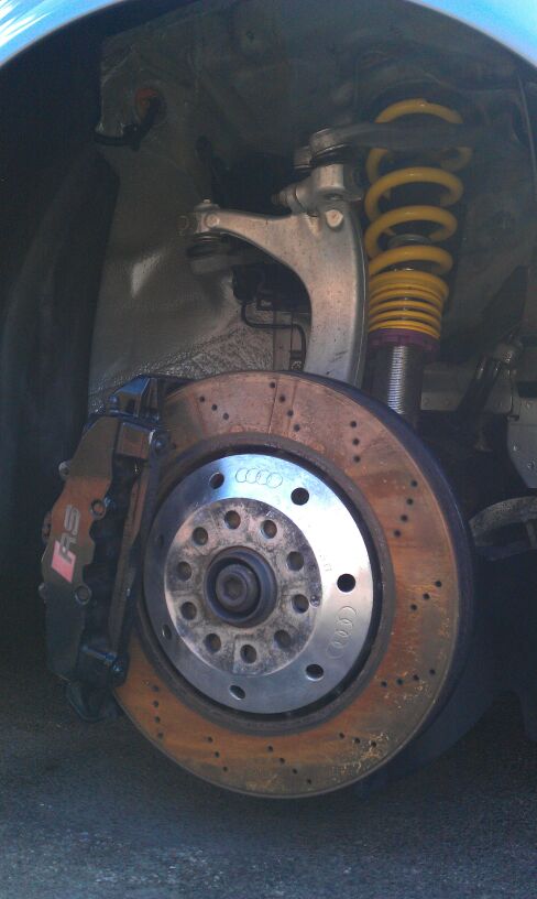

I used a grinder with wire brush attachment. Came out with a nice chrome like shine.

Btw have your spacers siezed on the hub?

Thanks for replies guys, will the buffing it out.
Nope spacer not seized, there hubcentric so sit on the ridge of the main hub.

sonny wrote:Nope spacer not seized, there hubcentric so sit on the ridge of the main hub.
Mine have lol, even after a healthy amount of copper grease before I fitted them.
Might have to get a bit physical & pry them off

Here's a pic. If the resolution is bad, look at the RS6 Reflectology pictures in my gallery.

Now that does not look to shabby mate, will have to do mine in the week I think. What grade of wire brush do you use?

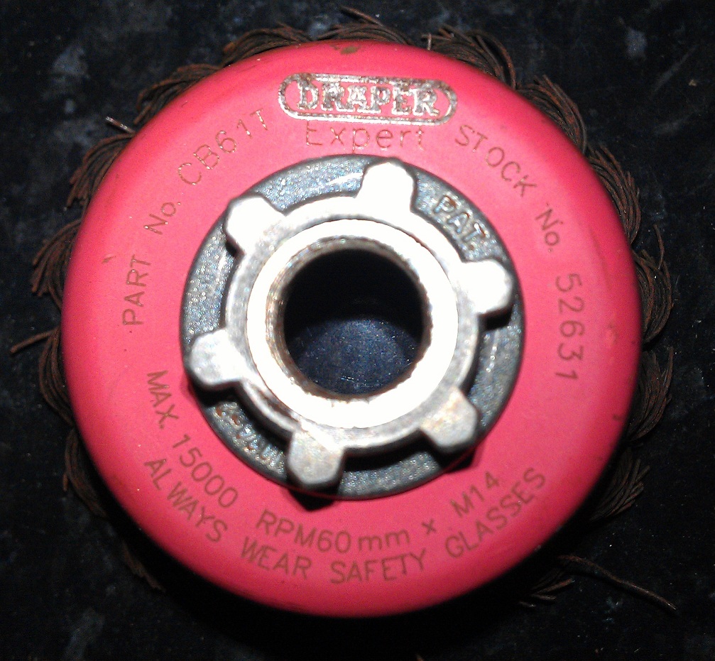

Had to go digging in the garage to get the details. Draper Expert CB61T
Draper Expert CB61T

Didn't take that long. The trick was to go easy and let the tool do the work. I estimate max 20-30 mins per corner.
I didn't get chance to deal with the upkeep as it went to it's new owner before it needed upkeep.
If I was doing it properly (or another way), I might consider someone who could machine and polish a clean face.
