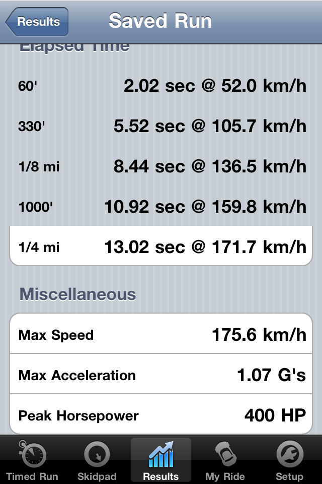

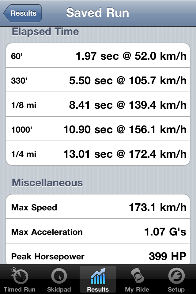

yesterday when i was channging oil and filters i discovered a broken (squeze) vacuum,that one that operate the airbox powerflap.I replaced and today i wanted to see if my car is improved.i have 116.000 km on the clock( cca 72500 miles) and i believe is a little laisy compare to my first tests from 2010 (45,000 miless)
A perfect day for that : 15 degrees celsius(60 fahrenheit), dry asphalt,
those are the results 1/4 mile in 13,01/ 13,03/ 13,02 / 13,02 and 0-62 mph 4,75/4.77/4.76/4.75 Trap speed cca 108 mph.
