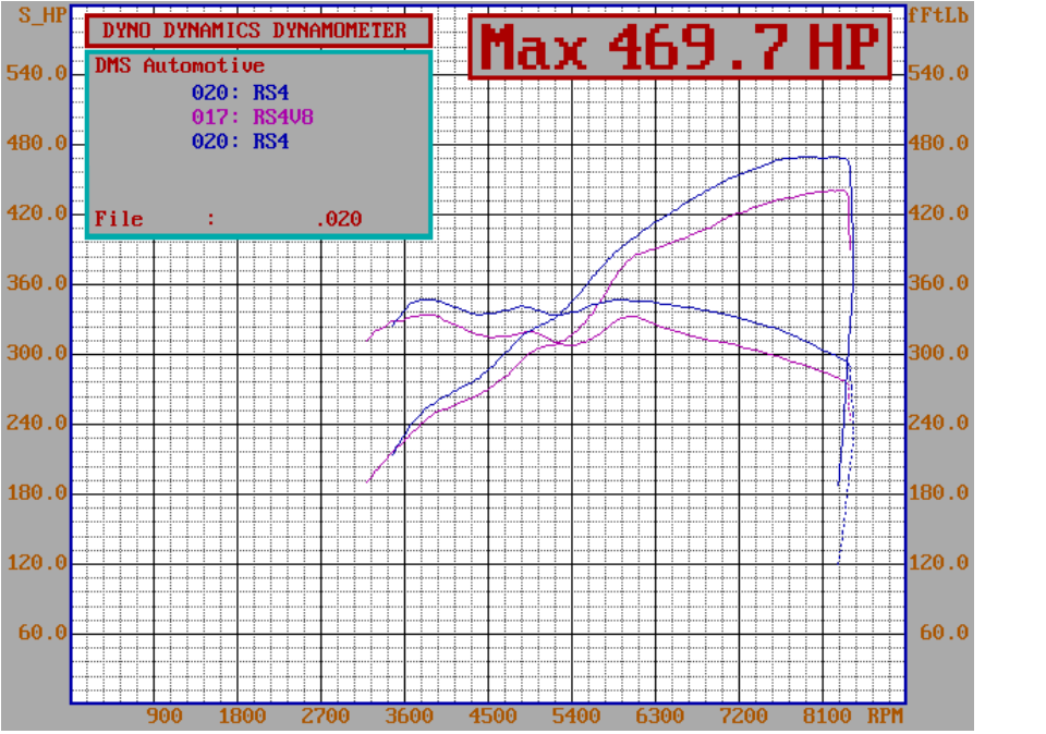

470 HP/348 ft lbs (B7, RS4)
Dyno'd on 20" using new Carbon Fibre Ram Air kit and inlet manifold spacers, 30hp jump.
Kit includes Pure Carbon Fibre Ram Air Duct and Race spec Auxiliary radiator (direct replacement).
The great thing is that the fans only reach 60mph, so true ram air benefits aren't fully realised on the rolling road.
I can confirm the radiator maintains OE Oil temperatures on the track (Silverstone) and Maximum Oil temperature was 130 degrees, the same as having both OE auxiliary radiators. On the motorway the Oil temps averaged around 96 degrees, climbing to 102 degrees Oil temperatures when I pushed on

it was rolling roaded at corten miller,
thanks guys thought 380 was bad but you have made me alot happyier, the CAF seems to have made a difference in induction noise and the Exhaust seems marginally louder, it also doesnt seem as hesitant anymore but it all could be my imagination, i will have to get out and do some logs this week,
do you think i should do a carbon clean with those figures?

Welcome to RS246 RTS BRAT. some good figures there. What is the race spec aux rad, MRC was talking about putting in a smaller Aux rad as a replacement for the OEM one, have you done this?
What is the Carbon fibre ram air duct, is it like a GruppeM system, and is so how did you overcome the hot air issue?

The duct is similar in concept to the one shown in Rick's post, with no hot air induction issue. The radiator replaces the remaining auxiliary radiator in the other side of the car to ensure that Oil temperatures are controlled. It's an effective peace of kit that uses all the standard radiator mounts and is attached directly to the OE duct.

470hp from just a cold air ram Pipe and airbox? What other mods are in place ie port polished manifold carbon clean up Exhaust remap etc?

Work carried out prior to Inlet manifold spacers and Ram air duct (not Pipe), that completely replaces the Auxiliary radiator;
Milltek Resonated cat back, HKS 200 cell cats, Induction manifold port and polish (Kept variable veins), carbon clean, ECU remap, Gruppem induction kit.
All of these upgrades only yielded 445ps (=438.90 hp), MRC advised me that was all the expected from a car with Cats and variable veins. They also ensured that the auxiliary radiator was cooled prior to conducting the final runs, as the initial runs only yielded 405ps. So I know hot air was not a factor.
More importantly the upgraded radiator keeps the Oil temperatures at least 6 degrees cooler in traffic than the OE radiator could. On the track (using only OE radiators, and with the auxiliary radiator removed), the Oil temperatures quickly rose to 142 degrees after only three laps at Silverstone.

Did it dyno 470 at MRC?

470bhp with 200 cell cats still in place? Sorry mate I don't see how u managed that
The car was Dyno'd again with DMS, and confirmed 440hp (=446ps) with MRC map.
I then had it Re-mapped by DMS (I have both dyno charts from DMS and MRC (Hard copy only, but I'm sure MRC would be happy to supply a soft copy))

Everyone has been a sceptic until they've seen it... and it's HP not BHP
Ok here's something tangible; I can hold station with a GT3RS.....

So your car has 438ps ar mrc?

I've just converted the exact Horse Power and Torque figure:
Horsepower to PS (Metric HP)
Horsepower: 469.7 HP = 476.22 PS
lb/ft to Nm (torque)
Foot Pounds: 348 lb/ft = 471.29 Nm
I hope this makes more sense now?!
lengster1Top Gear Posts: 1943Joined: Sun Nov 21, 2004 3:00 pm
Top
Re: My Rs4 Project
by Dannyrs4 » Mon Sep 26, 2011 8:09 pm

Why i have my own that made 460ps at mrc,i only asked to clarify as you claimed 470 but low torque figures didnt add up,but if your car makes 438ps like mine used to it explains the torque being down

I don't see how your cai is so much more effective than the ones all ready being used that's my point

Very interested to know the differences also. My car did 464.6 and 513nm back in Jan with no cats and stage 1 manifold.
Had another clean, stage 2 manfifold and spacers done, only did 450 and 500nm's last Friday at MRC. Ambient temps were obviousley
alot higher and borometric pressure was lower but still hoped for more.
Top
Re: My Rs4 Project

Dyno chart!!

Dyno before and after!

Interesting, you will have to take some more pics of the CAF.

So what was the spec at mrc and then at dms? Are you saying there mapping added 30hp? Dms quote up to 439 for just a map yet many here have done way more to get that genuine figure,in my experience custom mapping after several mods can add up to 20-30 Bh but dms are stating they've seen up to 60 gains given most cars make 380 in healthy stock condition,I'm genuinely interested as I have a fully sorted car myself and if there's a much better map out there or carbon duct I'm up for it,but I'm wondering if its a dyno thing as its a very very good output for a car with cats still fitted and a stage 1 inlet manifold,on the same basis I could get mine up to maybe 500 with a dms map and carbon duct?

It's the exact same as what we all have from Mrc a cai system but in carbon so I reckon the go faster carbon fibre has done it :) sorry for being a doubter but with cats etc in place it sounds bollocks to me. Btw I run 450bhp on a dyno dynamics rolling road and I've got a supercharger, they struggle to pick up the b7 torque split plus your dyno doesn't mention which mode you ran in ie shoot 44 centre diff etc etc I can dig out mine it tells you all of if, what was your afr reading also?

This reminds me of when I bought a supercharged Corrado fitted a chip & pulley. The original tuner/dyno claimed 195 bhp but when I accelerated hard the knock sensor kept intervening whaterver petrol was used. Took it to the old AMD where dynoed at stock bhp but more torque, with the ignition so advanced the knock sensor kept cutting in. It was re-chipped and pulled a genuine 180 without knocking and was much faster so unless I see back to back dyno runs without any adjustment of "correction factors" I take many of these claims with a pinch of salt too - especially on an NA vehicle...
I guess stopwatch timed runs would be the other way to evaluate but usually so much has changed (weather/atmospherics, road conditions, tyres, suspension) between the runs again is hard to be 100% sure.

The whole ram air effect is pointless - under 120 mph there really is no noticeable effect. Even on supercars where the entire intake has been designed around this kind of thing you are looking at say 10-15 hp at 150mph.
A nice way to illustrate just how little "ram air" has any effect just turn the engine off, plug in a pressure gauge to the airbox and then re-run the 60mph fans. You won't see the gauge move or even flutter.
It doesn't matter even if you do have a perfect ram effect - you've got to slow the air down in the airbox. There's just no way using the force of driving through the air you're going to increase this at any legal speed.
Rather than dyno's which I always take with a pinch of salt I'd rather see some Vag-com logs showing airflow with and without the intake.
