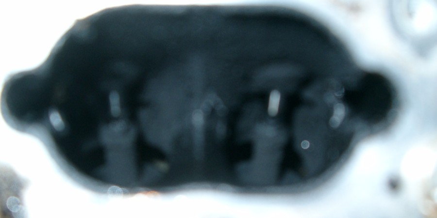

So last Tuesday the Revolution team set about cracking open the engine and fitting the enhanced IM. I will post some pics up later of the level of carbon in the valves but suffice to say there was a fair bit. Bear in mind that this was a car that 2 weeks ealrier did 400PS / 394.1 bhp so more to the discussion that carbon build up can exist without being totally detrimental to the car, particularly on one with 85+k on the clock. Whilst the manifold was off the guys took a borsecopr and look at random chambers and they are all clean as a whistle so good news there.

As caldy said Arthur, no cleaning as yet. I wanted to see what porting polishing did and cleaning as separate processes because everyone I have seen who has had this done previously have had the two done toghether so you cannot distinguish which produces what. Now ideally we should have perhaps cleaned, dyno'ed and then ported / polished but the guys at Revolution are researching the best cleaning material to do this and the IM was already available. If and when we get to cleaning (not sure I want to given the car now does within 7 bhp of rated on a dyno and more torque) then the p/p will skew the effect of actual cleaning by a factor but it should give a good representation.
These are the pictures of carbon in an 85k mile car
Some other pics;
Donor IM before surgery
Laborious work.....
And the result...

Post by ArthurPE » Sat Jul 23, 2011 11:36 pm
mine looked almost the same...50k miles
after cleaning I can discern no difference in speed (3k to 8k), all runs within 1/10 of pre-cleaning, same road, same load, same temps, or efficiency, MPG has not changed even a tenth...now I may have a picked up 5 HP or so but that is easily lost in the noise...
