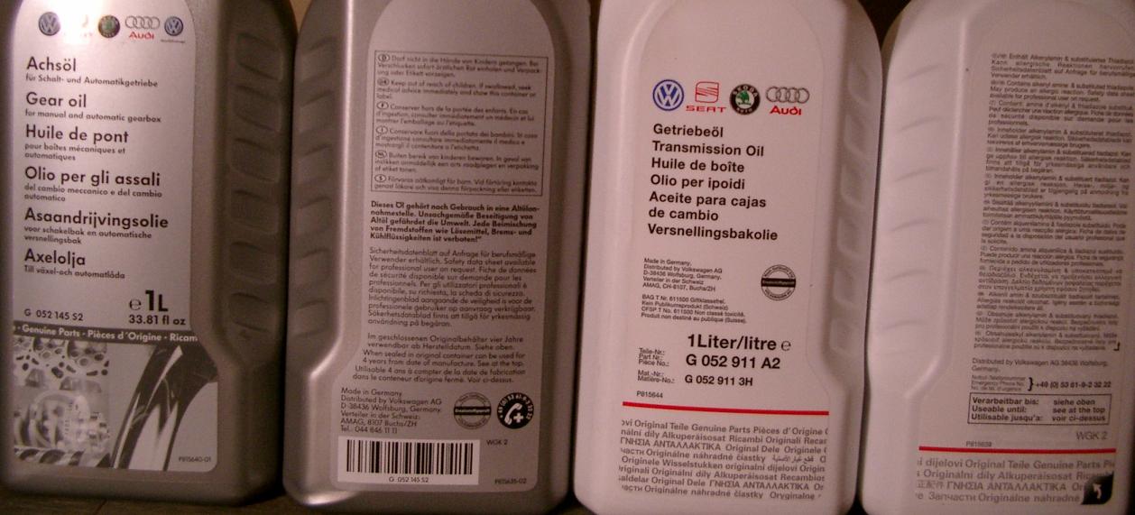

3.2 liter (75W90 fully synthetic GL4 or GL5 suitable for synchromesh transmissions) GL5 seems to be recomended due to better hi pressure performance
0.9 liter (75W90 fully synthetic GL5)
iirc 18 lb ft, someone can verify that
no
the qty and type of lube were given to me by Audi...
here's the oem stuff
