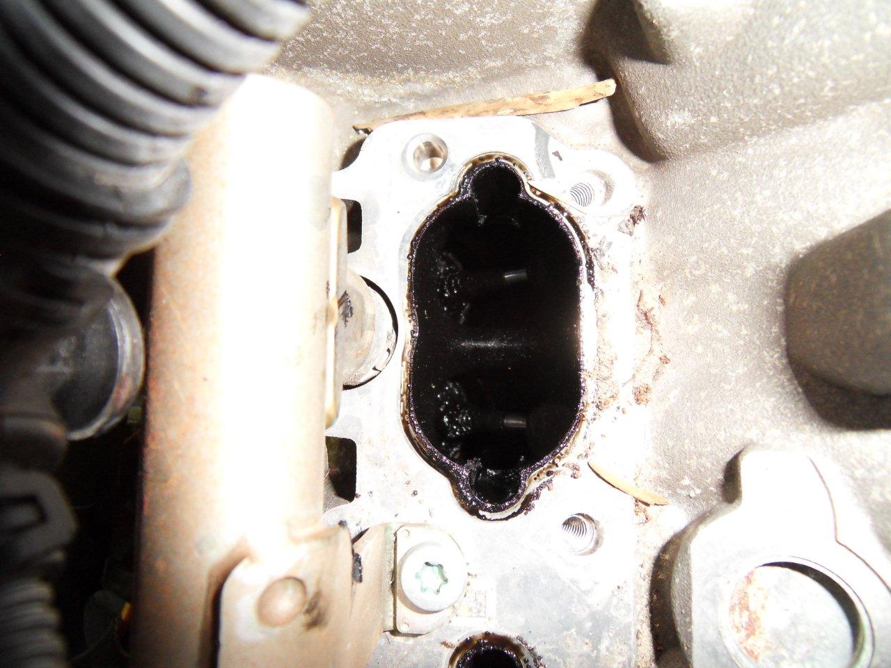

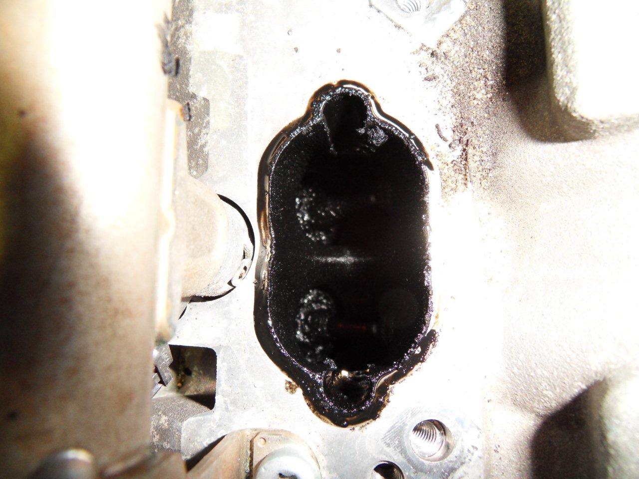

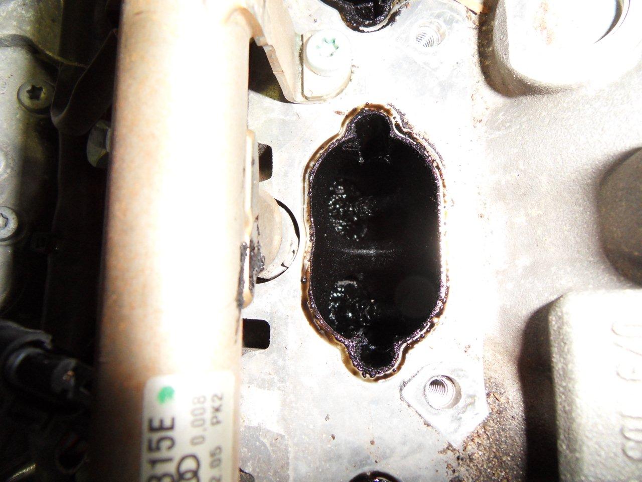

Hi chaps, my car is at MRC at the moment and Doug took the time to send me some pics of my inlet ports. Thought you'd be interested for reference.
30,000 miles on the car and standard before you ask...

Really interested in this as im considering how much further tuning to do to mine,What work are you having done? The full monty? Full exhaust inc race cats,remap,ported inlet manifold and cleaned valves?Mine is in need of a remap as i have a full system on it,but how far beyond that i go im not sure,im a little uncertain at spending approx £600 to have valves cleaned if they return to pretty much that state in a few thousand miles,pippyrips old car seemed to have lost a little power since it was done but i believe it was tested on a different set of rollers before.

I'm guessing it probably does degrade again over time, but one of my concerns was that the previous owner drove the car very gently and it might've been more clogged than normal.
I'm having the clean-up, flowed ports, new fuel and air filters, plugs and oil plus a remap to get it running nice and crisply. I'm leaving the exhaust standard for now but will probably have some 100 cell downpipes fitted once they're in stock (if anyone know's someone who has them - new or secondhand - then let me know). I've no intention of changing the rest of the exhaust.

With the inlet work, de-coke, air filter and map it went from 372ps (286@the wheels) to 426ps (about 420bhp I think) on the same dyno. I'm gobsmacked to be honest... Sonny had a little ride in mine today and said it felt nice.

Zorbs, gobsmacked you should be, I was really surprised how well your car pulled, it really showed dividends having the work carried out. esp as its a 06 model with 30k on the clock. The car performed very well, a lot faster than mine, and I had the MRC and current Audi software maps added. showed that the work you had done made the difference.
