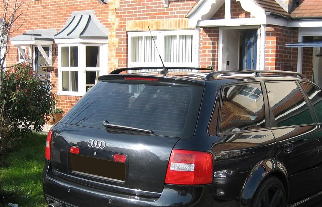

A must do mod for any RS to get rid of that 70's look and smarten up the back end no end
Pic courtesy of Pau1

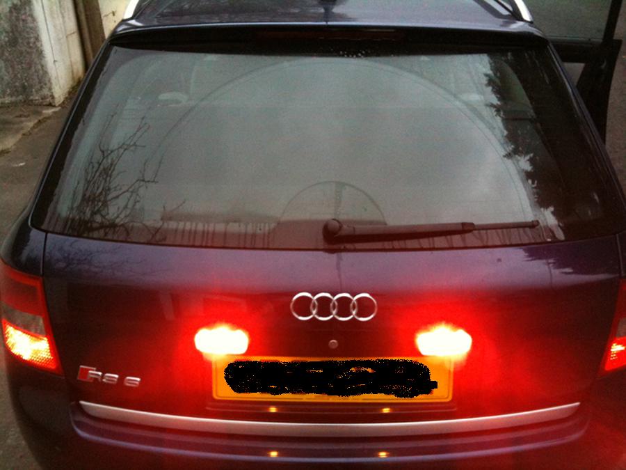

Any pics Rich?

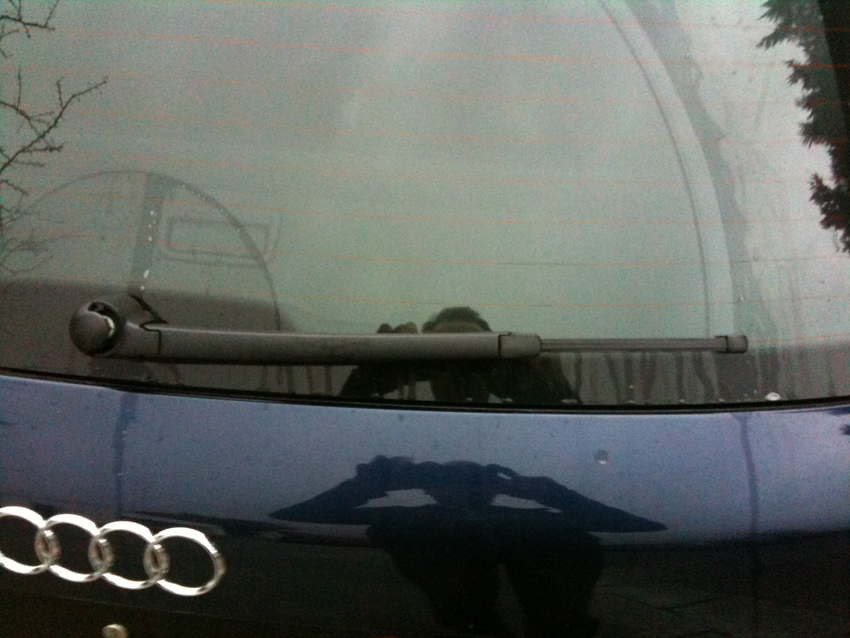

Finally managed to get some pics of the Aero wiper (and both the rear fogs !!)
I used a Touran wiper as it had a cut out for the jet so made it a simpler swap.
Golfather looking at Your pic You used a different wiper arm which looks better than the Touran one, did You have to modify the jet or cap on the arm?

So how does your rear washer work ?
03 Mugello Blue Avant, Silver Leather, Carbon Fibre, Alcantara Headlining, MFSW, Electric folding Mirrors. H&R Coilovers, Hotchkis ARB's, Res Miltek, APR R1's, ITG Filters, RNS-E, OEM Bluetooth, Digital Freeview and Headrest Monitors, Aero Wipers, Rear Aero Wiper and R/H parking Mod, Rear Fog mod, Valentine 1.
It Dribbles rather than squirts !!
Ohh Err Missus etc etc !!
So You've sacrificed practicality for good looks then !
The wiper arm You've fitted is the one where the jet is meant to follow the arm ?
Is there no way of making the washer jet work correctly as it really is a better look than the one I used.
If not then I think I'll stay with what I've got for now as its a good compromise between function and form !
