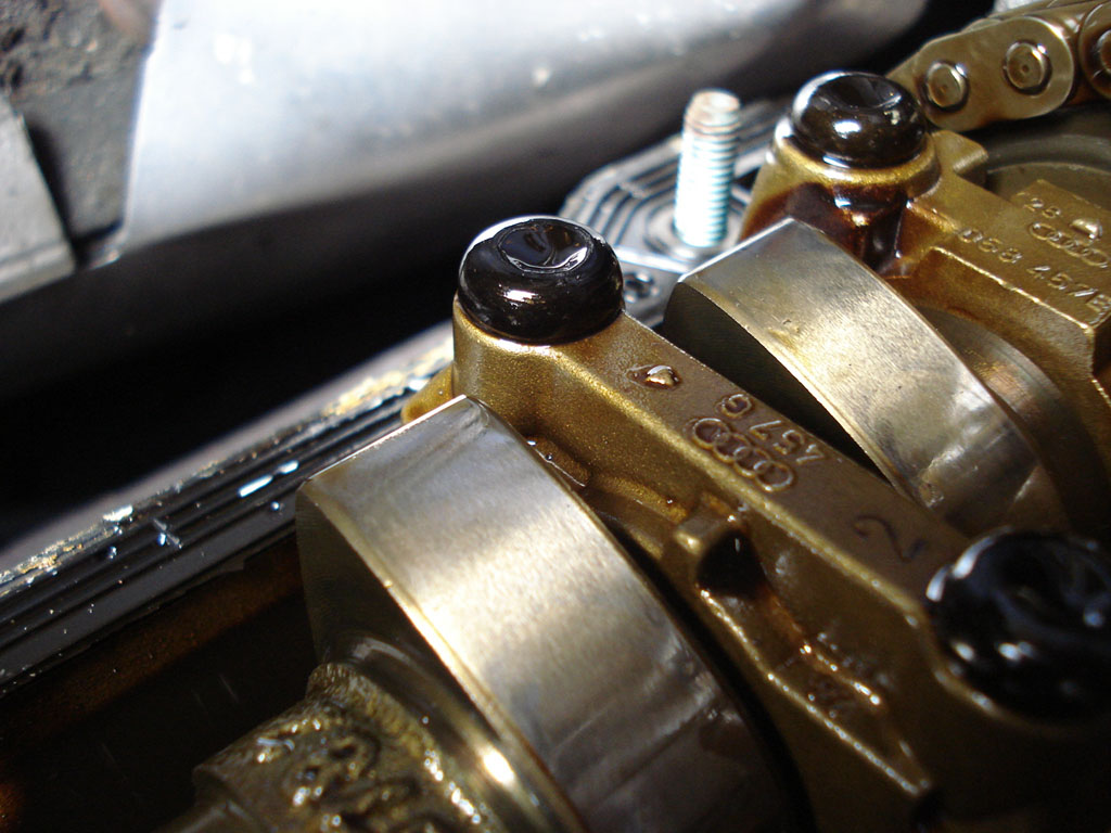

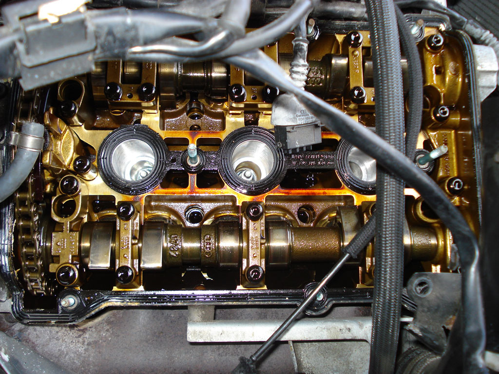

Took the cam covers off today on my car.
For reference it's a;
2001 AZR engine (i.e. the later one)
104k miles genuine miles (bought from original owner).
No modifications including no remap.
Largely motorway miles and school runs.
None of the lobes shown any significant wear, in fact the offside bank look better than the nearside which is unusual.
Pics below;
Last pic is of the offside rear exhaust lobes which seem to be the weakest

No idea if the later engine IS free of problems, that's one for a specialist mechanic to comment on from case histories, I am just stating what mine is for the record so maybe we can build up a pattern.
The cams are the same part numbers for early or late engines so if there is a difference in durability it could be that from a certain date the cams were made in a stronger manner.
rtd, mine's a March 2001. the engine code is on the logbook, data sticker in boot, barcode on cambelt cover or stamped somewhere on offside front of engine just behind the timing belt cover.

Mine was on longlife but never did more than 13k between oil changes. It did have a new MAF but only recently.
OK, so engine code/build date isn't a deciding factor, wonder if remap or stock may be the answer?
And just out of interest, has your motor actually been on the road since you have had it or has it been operated on all the time? Maybe you can start enhoying it soon?
It's only been worked on for a matter of hours so far, finding time to work on it has been the issue for me and my RS4 driving mechanic friend.
I do yearn to drive it but know it's worth getting it right first so I don't have any nagging doubts in my mind about cams, oil cooler pipes, boost valves, rattles, etc etc
