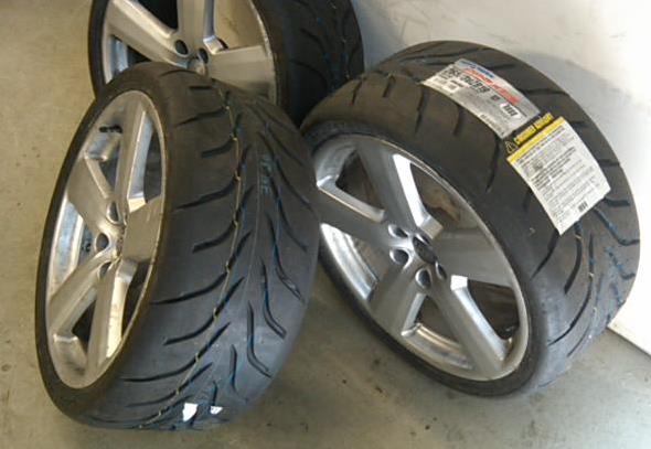

Post by 500bhp » Wed Apr 01, 2009 8:16 pm
Just fitted the 265/30/19 to my RS6 today.
So far they are outstanding with H&Rs and Hotchkis ARBs.
Like a 500bhp GoKart.
