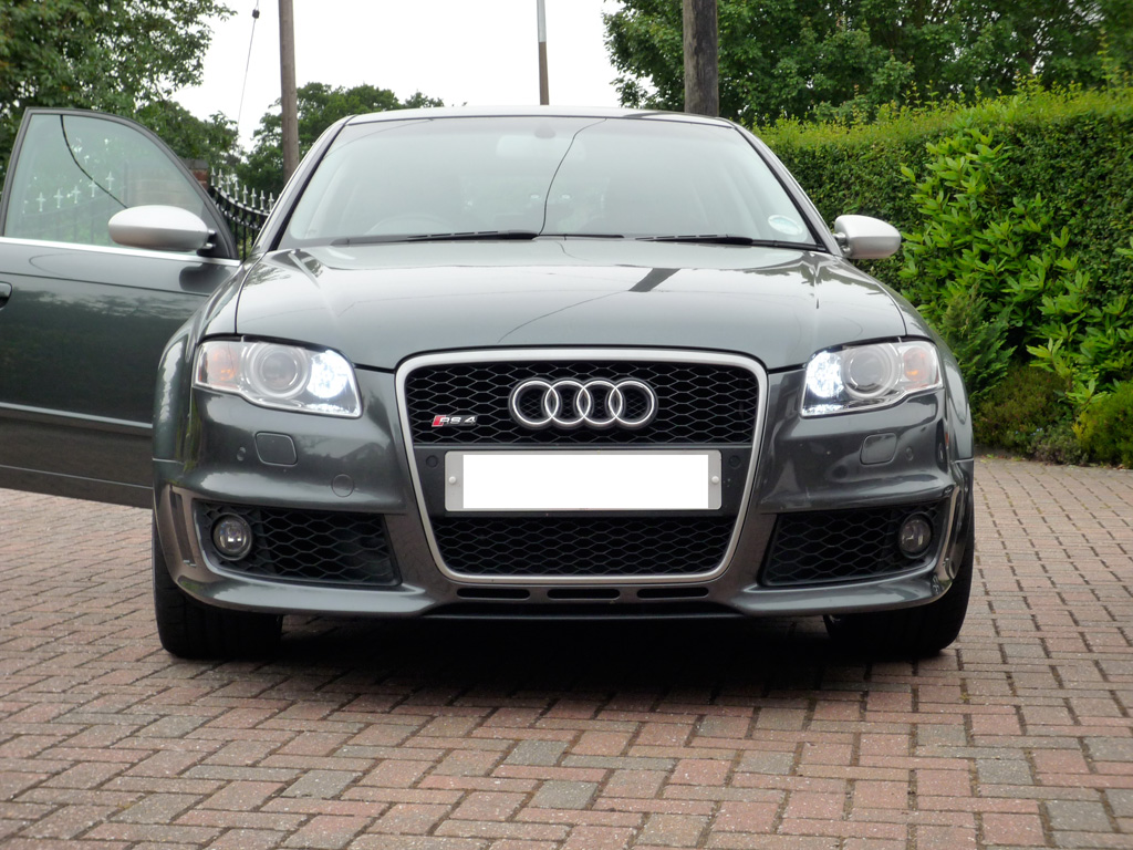

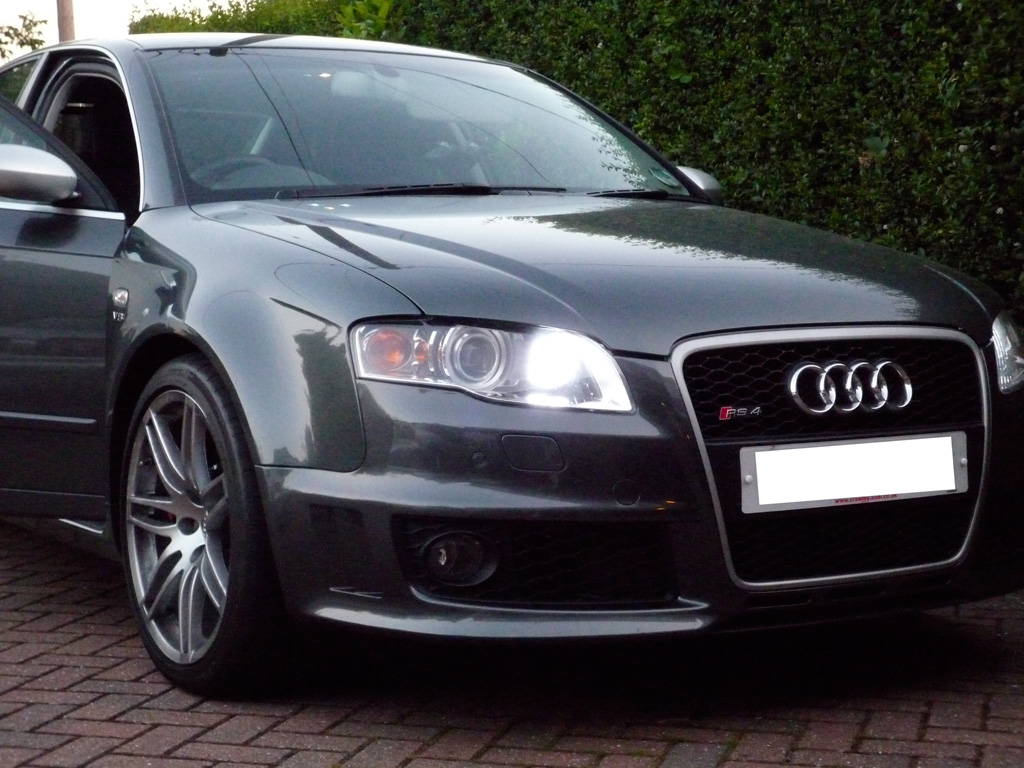

For those of you interested in having LED DRL bulbs, here are my latest - they finally do look exceptionally bright and very distinctive. One of these pix was also on a very bright day.

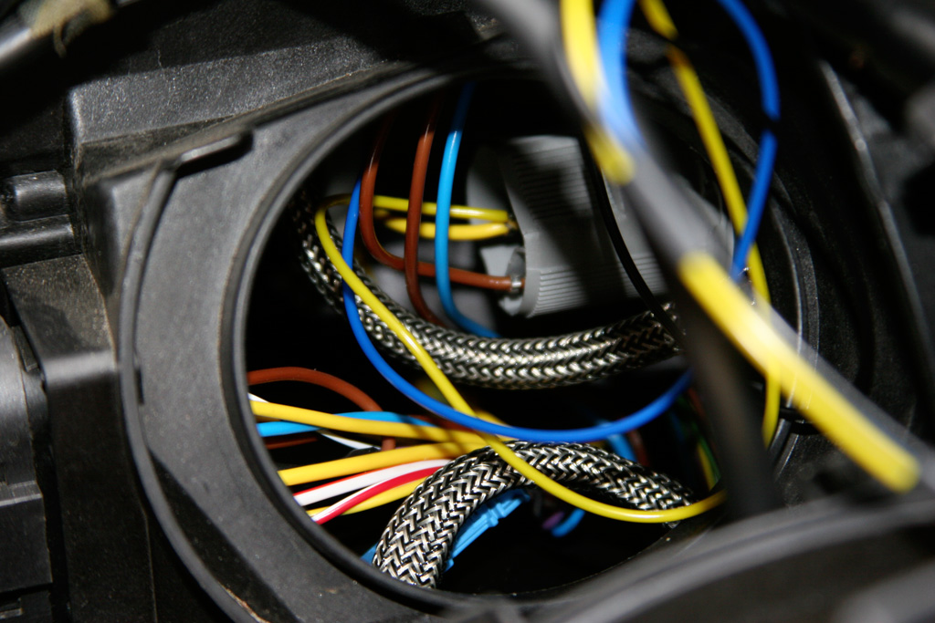

Also a couple of pix of the wiring and ballast resistors, neatly (imho!) housed in the headlight cap.
Shout if anyone's interested in more details...

only thing I would worry about is the heat off the resitors inside the cluster. they get very hot!!! have you had any melting issues??

There is NO issue with heat from resistors if you size them correctly.
The mistake people make is assuming that the resistors need to take the full equivalent current of the existing 21W bulb (which in fact runs derated anyway). I conducted extensive experiments to see how high a value i could use which still kept the bulb failure detector happy.
I used 50W 24R for the DRL and 25W 68R for the sidelight bulb. It was testing them that showed they don't give off so much heat that it would be a problem, hence installing inside the headlight on the cap thus avoiding sealing and untidyness issues. The heat dissipation for the DRL resistor is hence ca. 8 watts, and for the sidelight ca. 3 watts (at worst case 14V). Not exactly high, and more importantly, in each case less than HALF the recommended dissipation for the resistor without any heatsink.
Also, remember that for the most part there is airflow albeit limited when you are moving.
The DRL LED bulbs are from www.v-leds.com , their 60M-SMT bulb.
Wiring not scotch locked - cos if ARSEY thinks LEDs are chav, then even worse is using SLs on a car like this - wires soldered to connectors on lamp holder, and colour matched.
