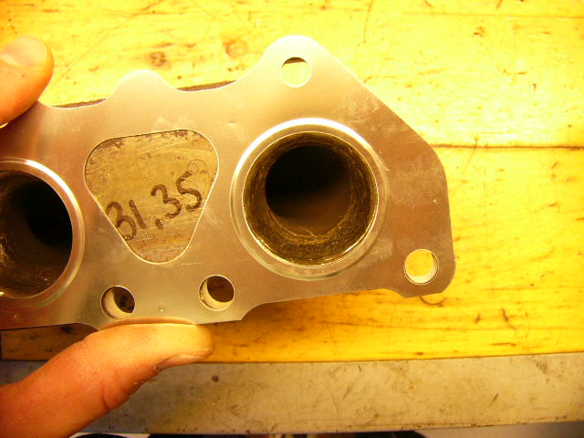

I have some ceramic coated manifolds from VAST.. But they dident have some ported and pollished on stock. They just told my that I was safe if I just get the weld ridge knocked out and open the holes to the exhaust gasket. But is the pipe also welded inside the manifold?

it needs welded again - get a good tig weld so it is a nice flush finish.

Post by matias » Sun Jun 15, 2008 1:41 pm
So it needs to be TIG weld the same place as OEM?

Post by Doug_S2 » Sun Jun 15, 2008 1:56 pm
yes

Post by matias » Sun Jun 15, 2008 2:13 pm
@Doug.. Would I have a problem if I dont weld it aigen? Could it be that it would crack and send some metal to my new turbo,s :oops:
Do you have some pictures of yours ported stock manifold?
