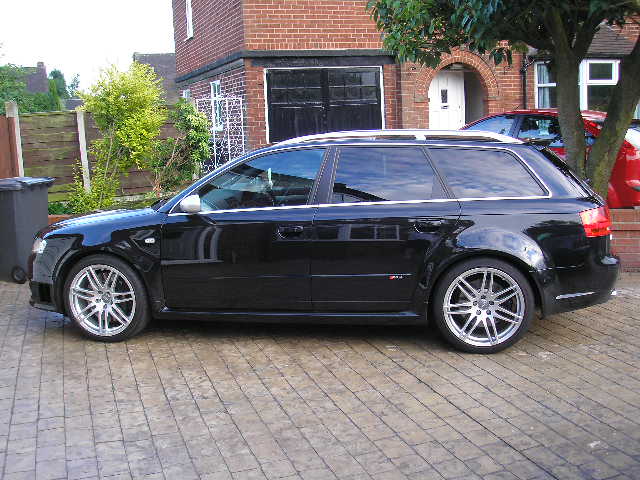

Just posted a couple of pics in my gallery, car looks pretty well after being cleaned with the mequairs shampoo.....
berry100
Posts: 115
Joined: Wed Oct 13, 2004 10:24 am
Post by berry100 » Sun Jun 24, 2007 8:15 pm
Here's me best pic so far :oops:

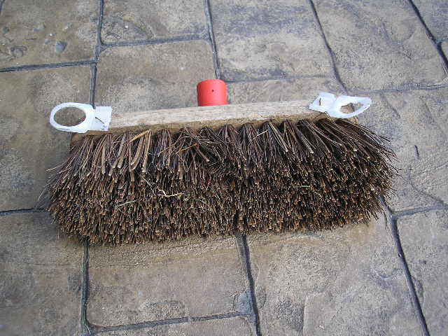

Post by berry100 » Sun Jun 24, 2007 8:21 pm
Oh and a picture of the offending item in question :lol:
Had I not caught him in time, gawd knows how much of the car he could have done :shock:
