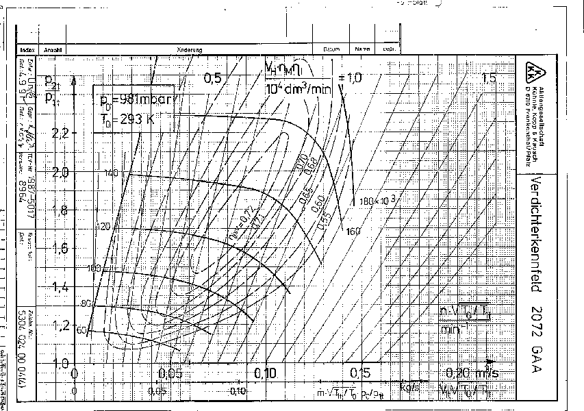

As Fastech state on their site - yours is a Racing version. That means the remap compromise will be at the expense of reliability. 510Nm is not a particularly high peak (I had 515Nm at stage 1 and now have 560Nm at stage 2). However 345PS (which is about 340bhp) peak is high for a stage 1. I assume that you don't have a free-flow exhaust system, because if so then it means that their remap tries to reach 340bhp on a standard car by using a lot of boost.
If this is true then maybe you don't have a boost leak, but either way your turbos are being stressed.
