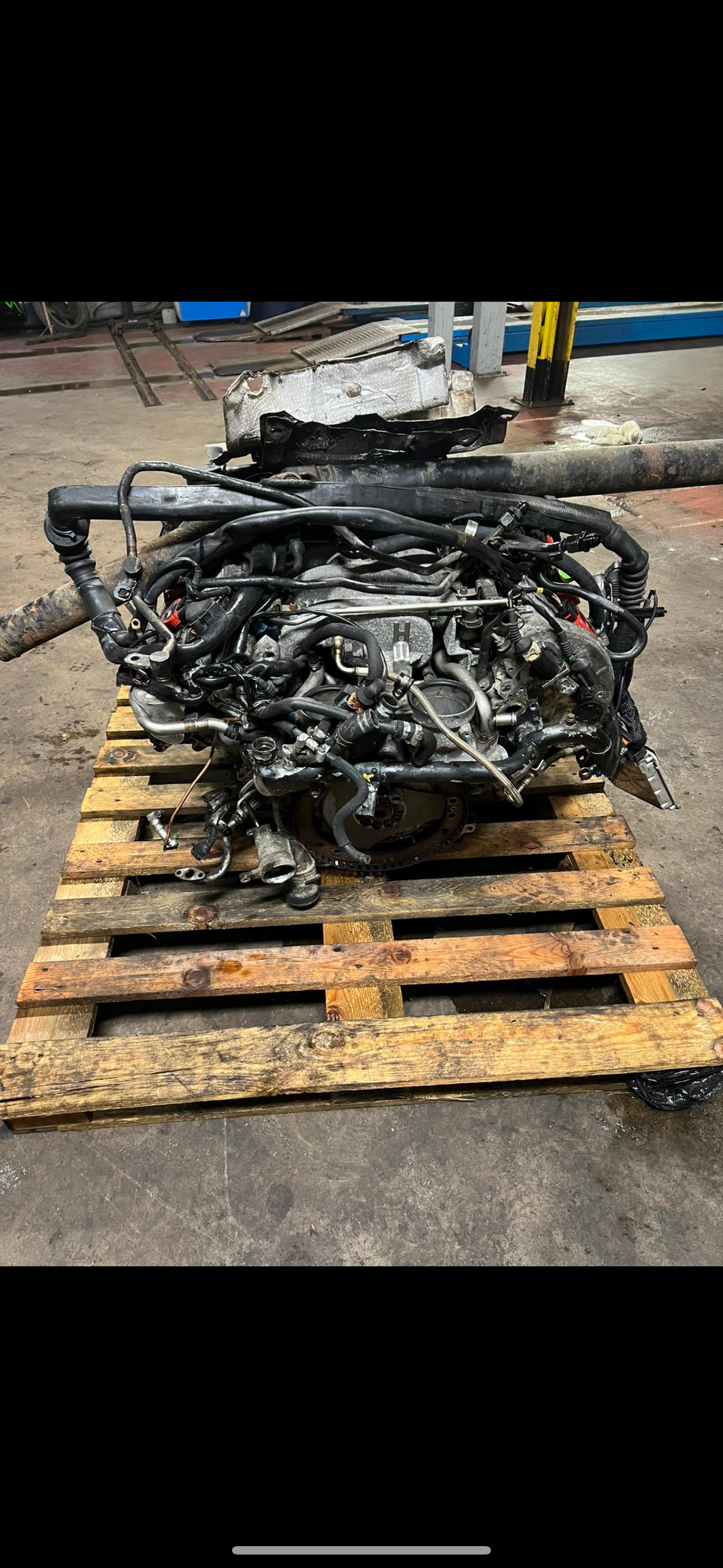

We have progress. Engine is out, standard gearbox is off (being collected today from the person that has purchased it).
My prop shaft is off and also sold, in readiness for my carbon fibre prop.
The JXB prop shaft bearing carrier has also been sold.
If anybody want any standard engine parts send me a message.

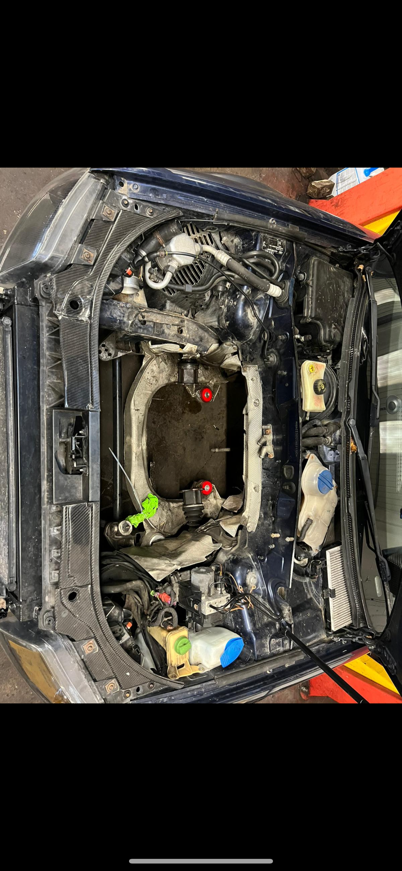

Gearbox, torque converter and turbo all removed.
The gearbox and TC was collected yesterday by the new owner to keep another RS6 on the road.
Turbos are getting sent to TTE and turned into their mighty 960 turbos

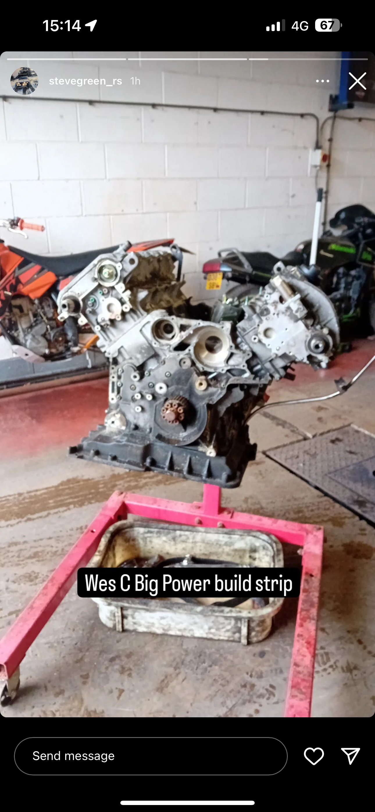

All of the ancillaries have now been removed from the engine.

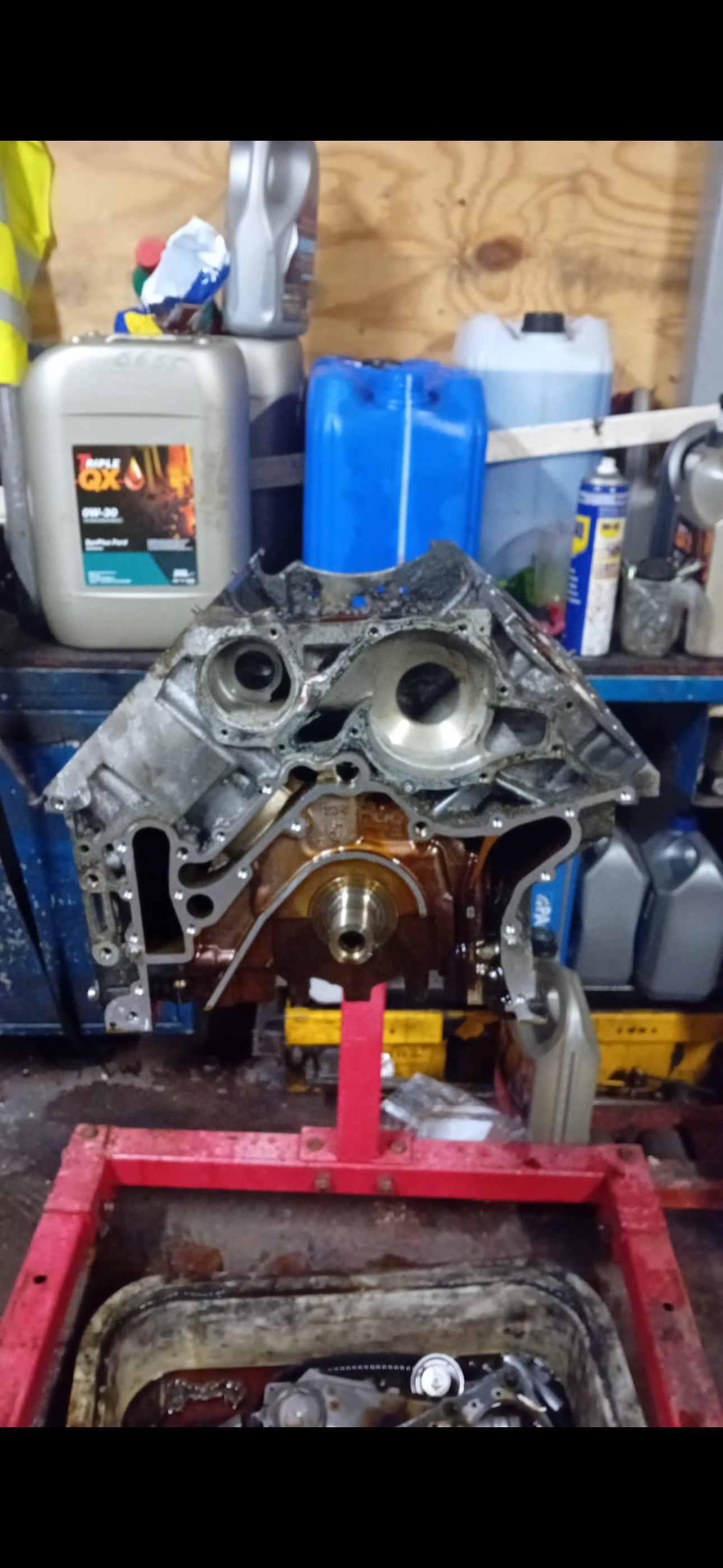

Re: Engine build and 6MT swap

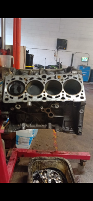

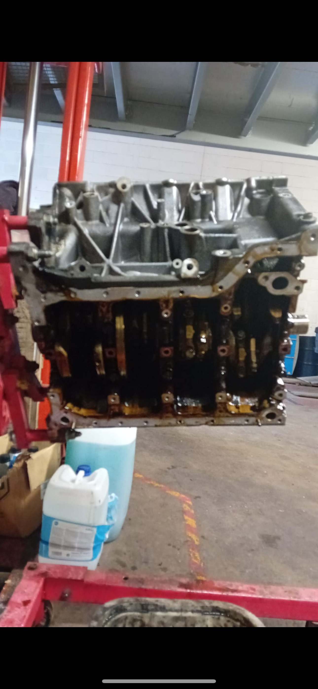

Everything else has been removed from the block. Apart from the crack, rods & pistons.
Its was taken to the machine Shop today along with my new forged rods and pistons. The bores are being re-honed and the crank, rods and pistons are being lightened and balanced before reassembling.
The bottom end was dropped off at the machine Shop. Then upon inspection they aren’t 100% happy with the boars. The boars are Nikasil coated from factory and they have some signs of wear, so we are having them re-nikasil coated.

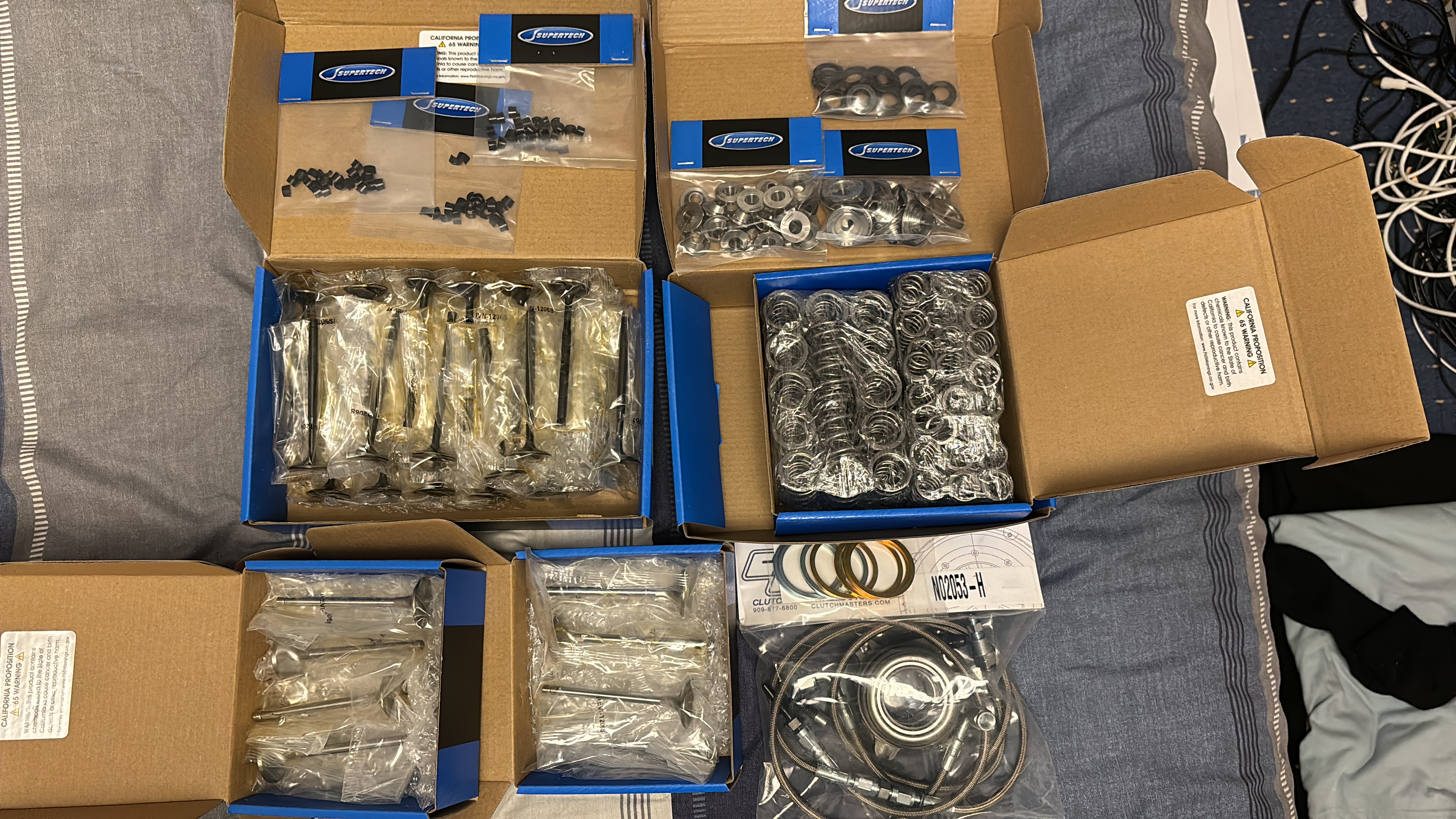

I also received another parcel this week with all my valvetrain components.
