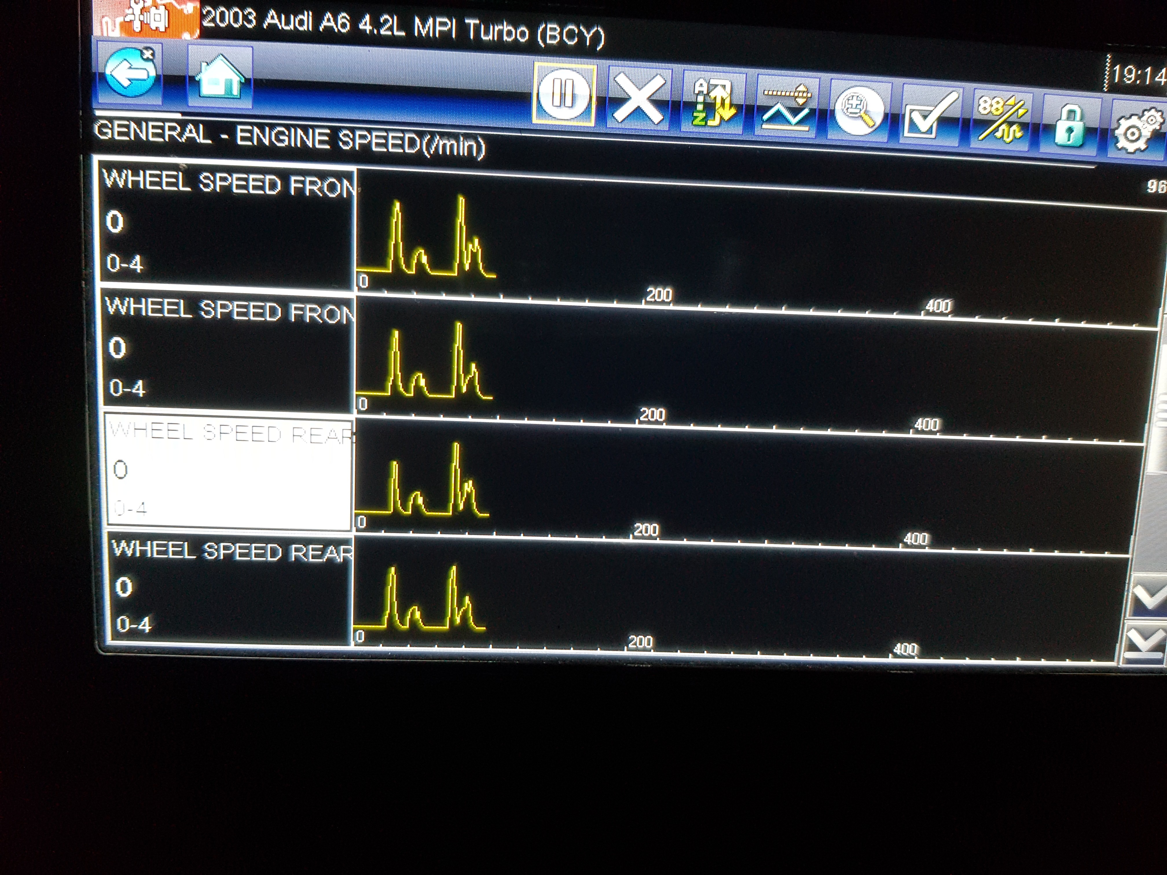

I also have an issue with the ABS and ESP warning lights coming on all the time. The diagnostics said it was the rear left sensor. I initially made some jumper leads to cross connect them under the seats to see if the fault swapped sides. It did. I replaced the sensor but the 2 warning lights are still on all the time. I checked the live outputs from all 4 ABS sensors and am getting the same speed readings from all 4, so I think the fault is not with the sensor but something else. To be continued

With the new sensor fitted, the live readings for all 4 were the same.
I cleared the codes, but comes back as soon as the car starts moving

Not having any joy attaching photos of the read out....try again
