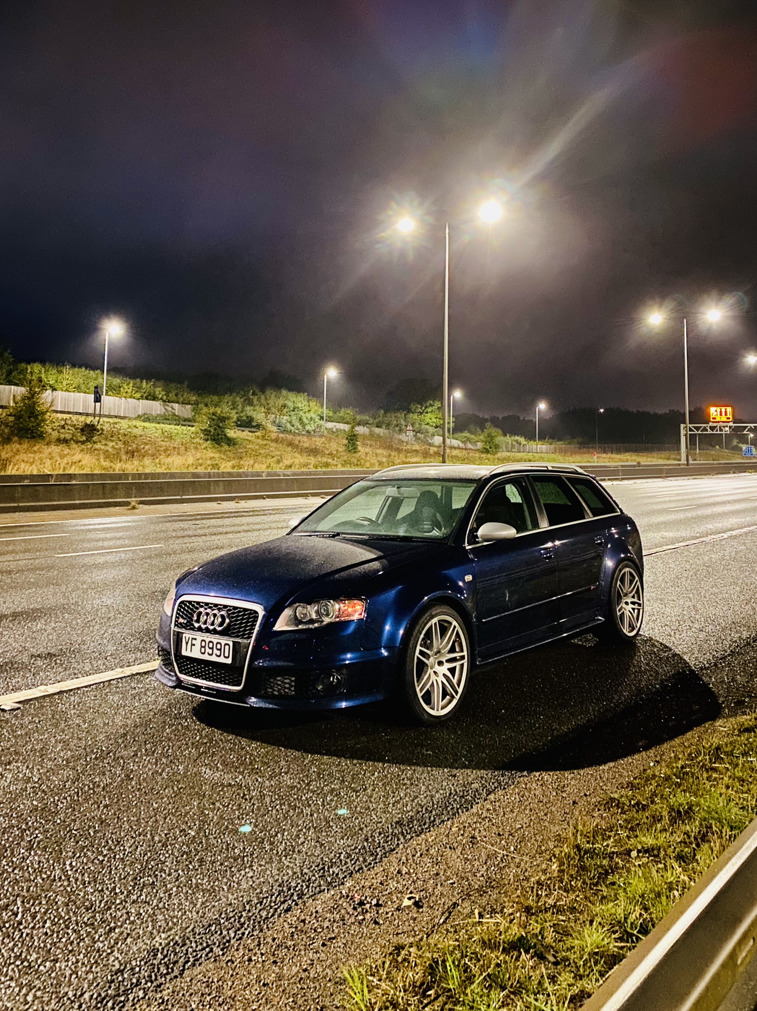

It was all going so well, to quote the notorious BIG "it was all a dream..." 1st of October 2021, heading down the M1 at 12:15 am. The engine lost all power and I felt my heart sink!
The one and half hour wait on the side of the M1 in the rain weren't the best but all I could think is please don't let it be anything big.

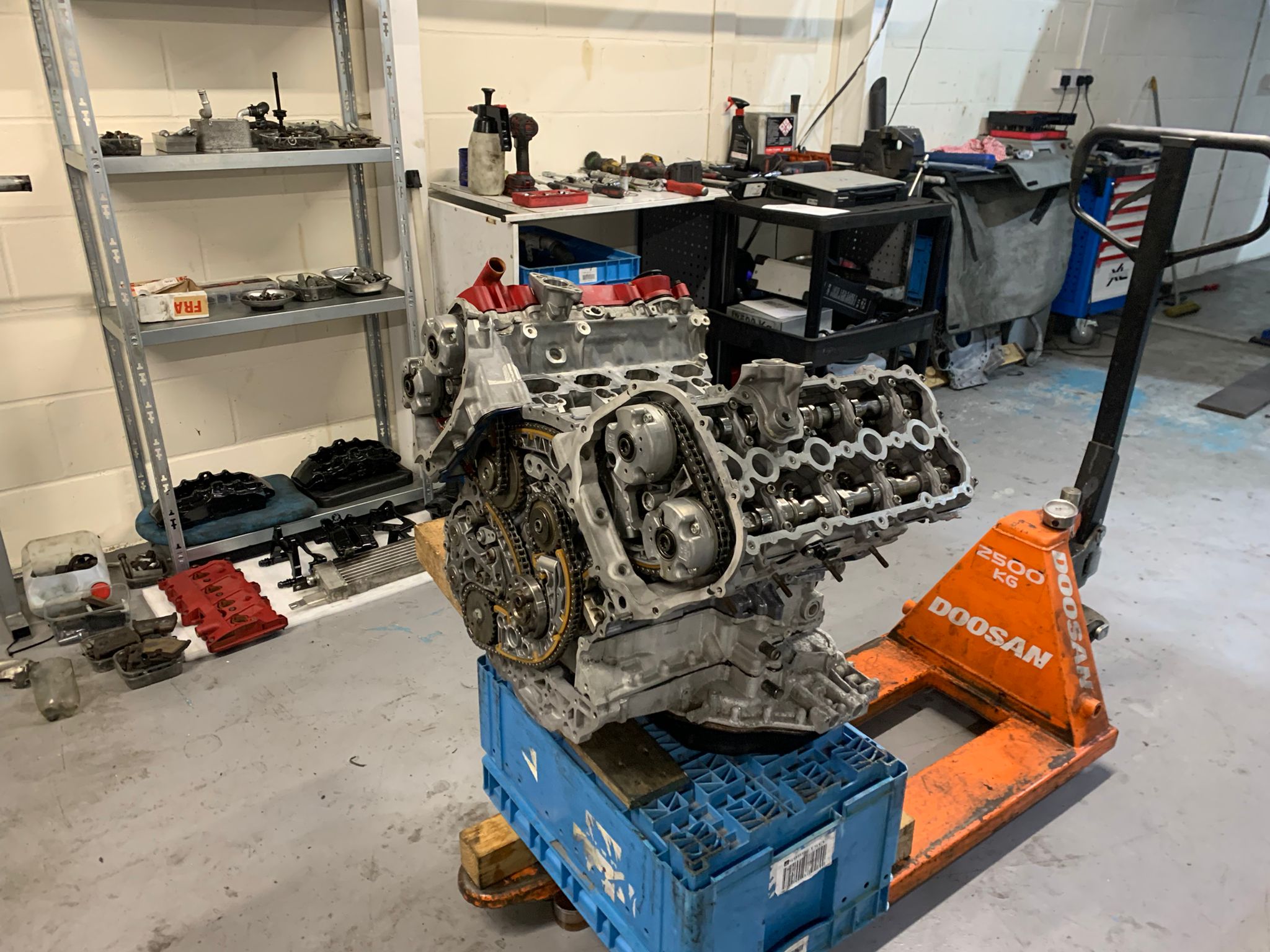

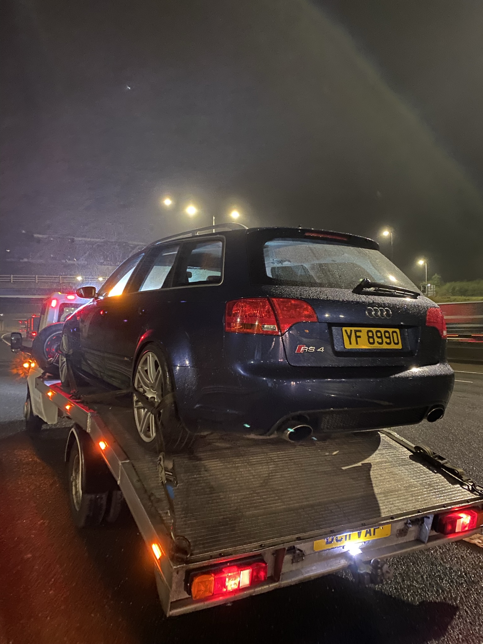

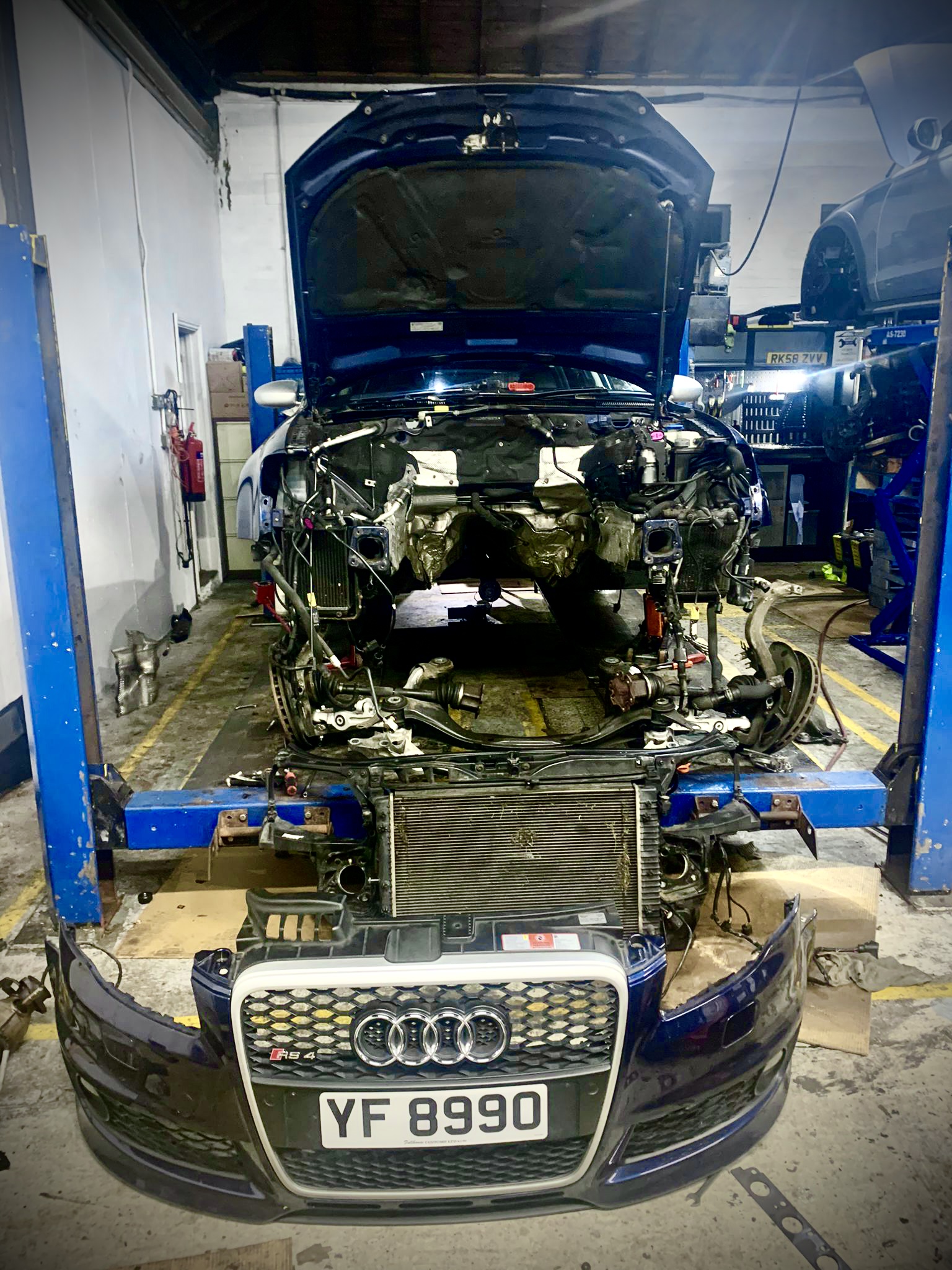

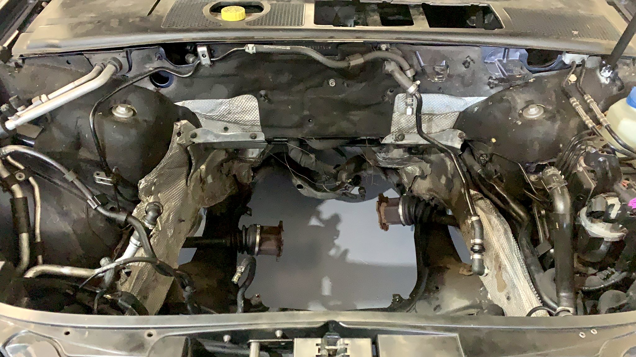

Now to pick up again from the RS on the back of the tow truck, the engine was seized, no turning it what so ever which was the worst possible news.
I was still hopeful but had a word with the mechanic, considering the engine wouldn't turn it would need pulling out to inspect how bad the damage was.

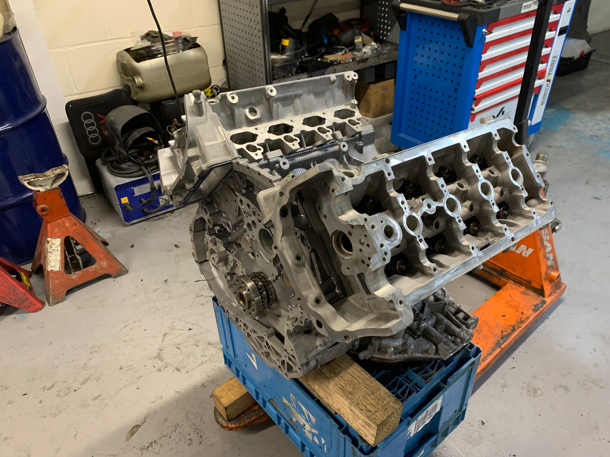

Everything was unplugged, cleared and the engine was ready to come out - this is what we were left with.

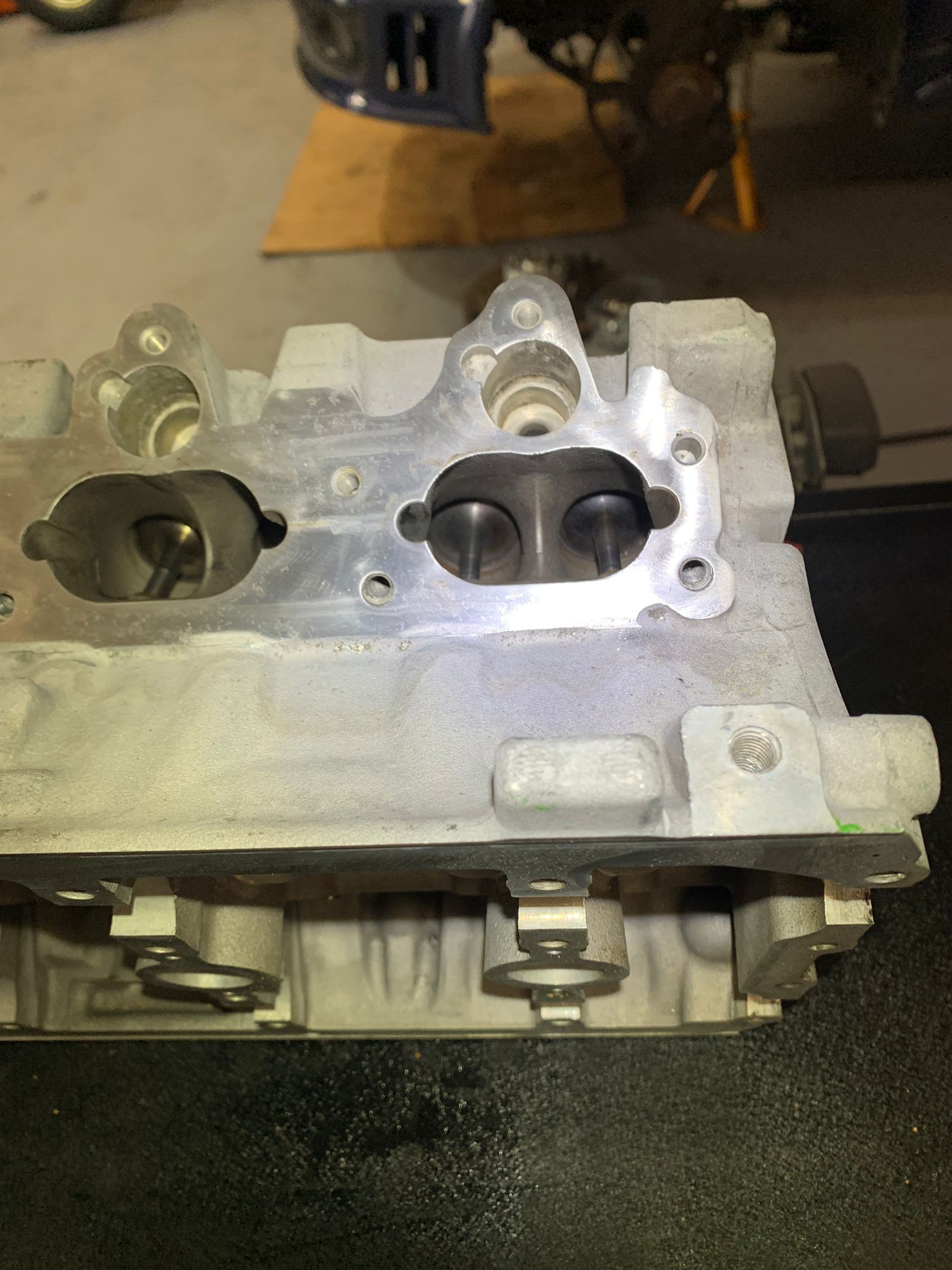

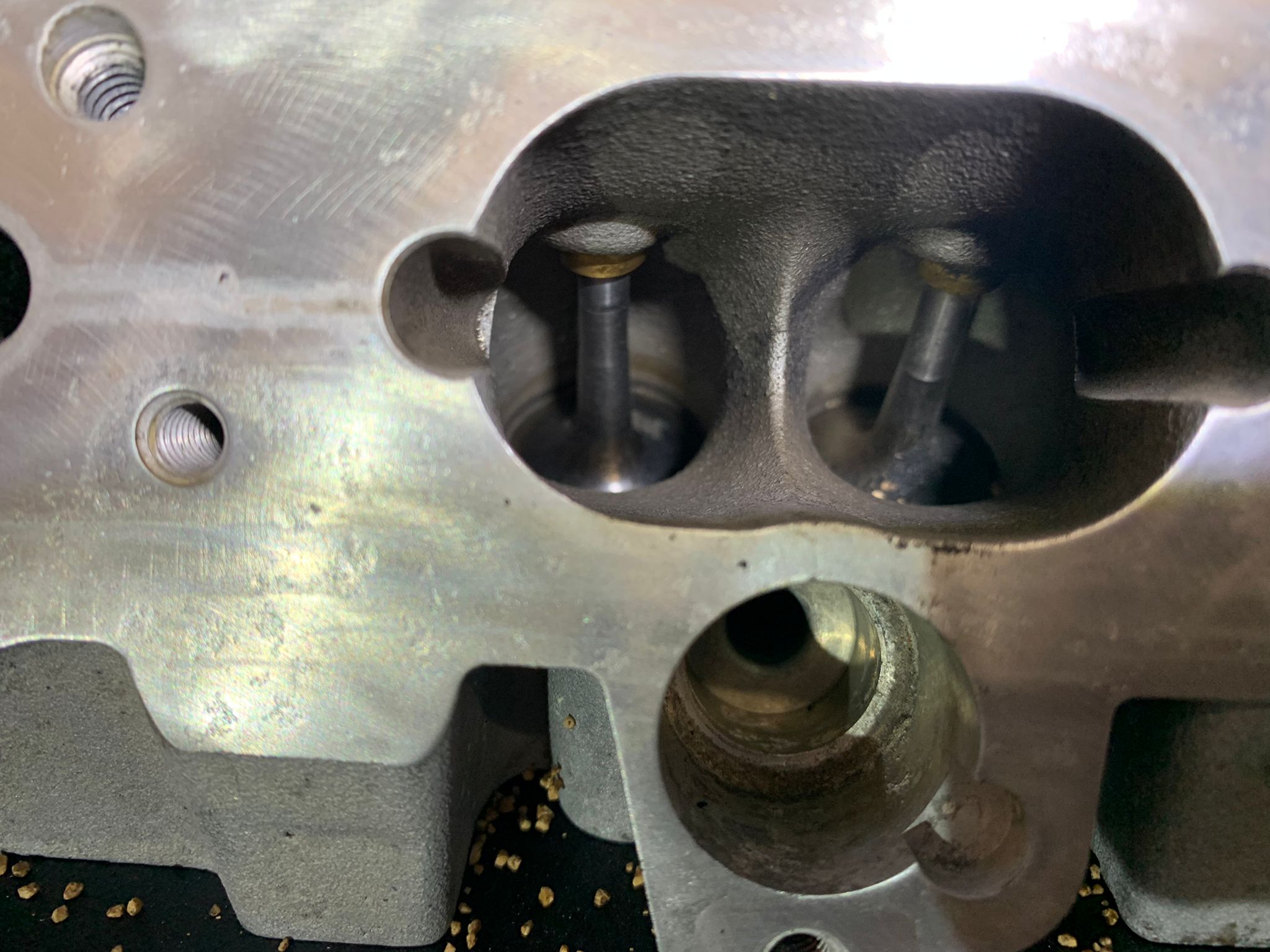

The heads came off and it was clear as day, we had a big and I mean BIG problem!
Yes, that's not meant to be bent! :rant: :rant: :rant:
it was slowly sinking in, this wasn't going to be easy nor was it going to be cheap!

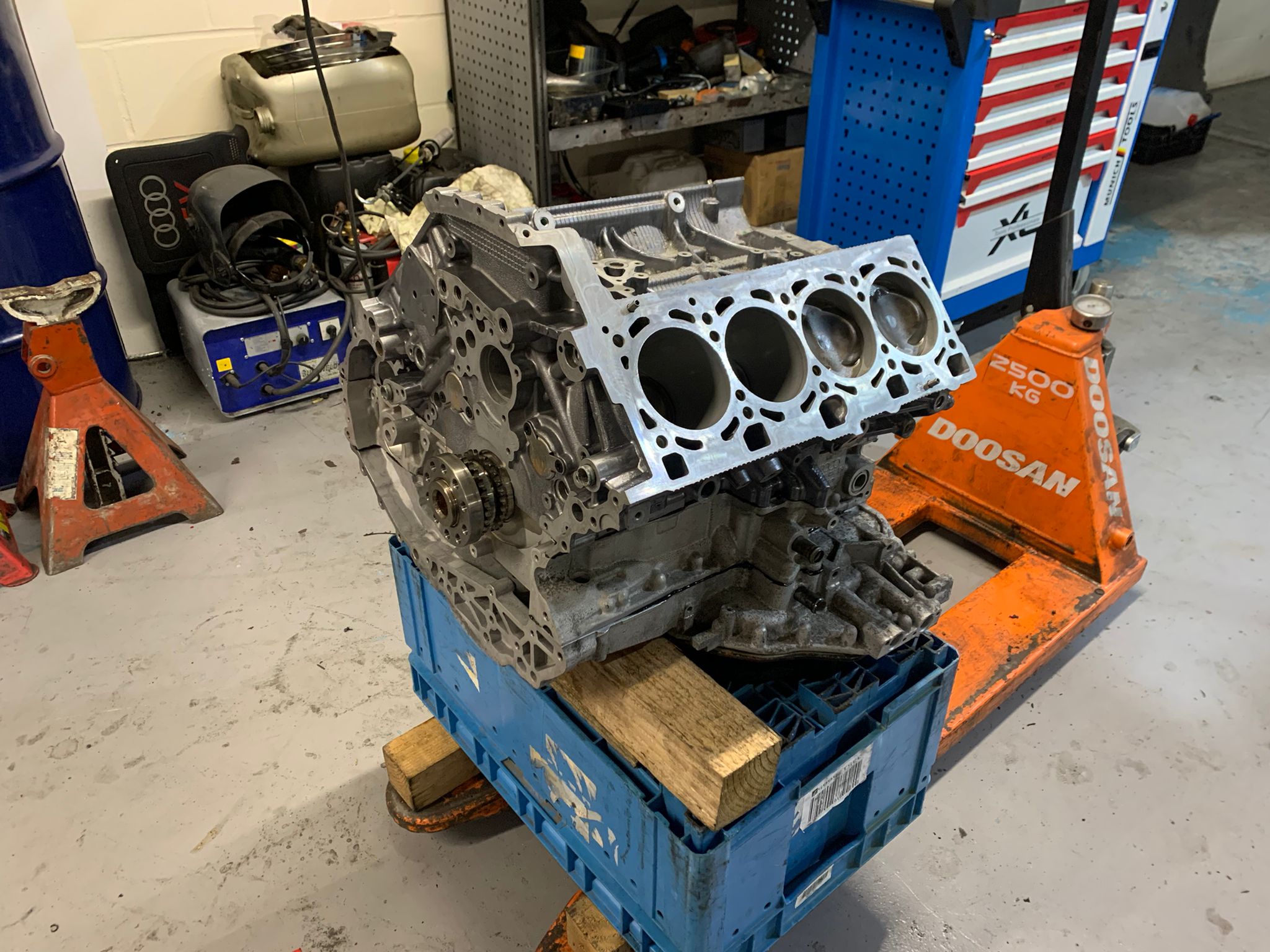

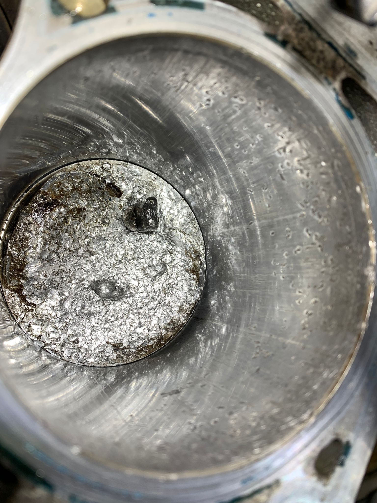

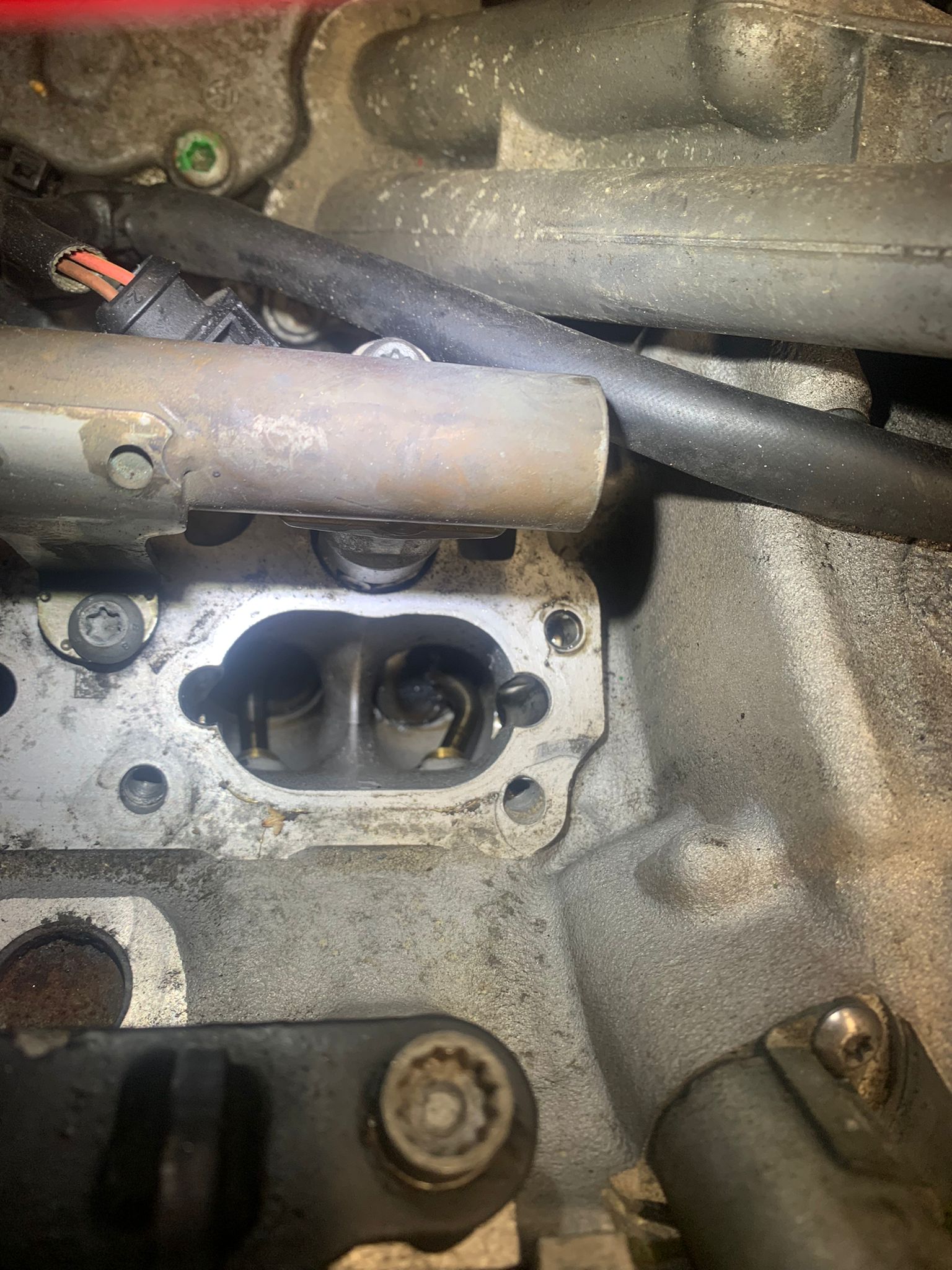

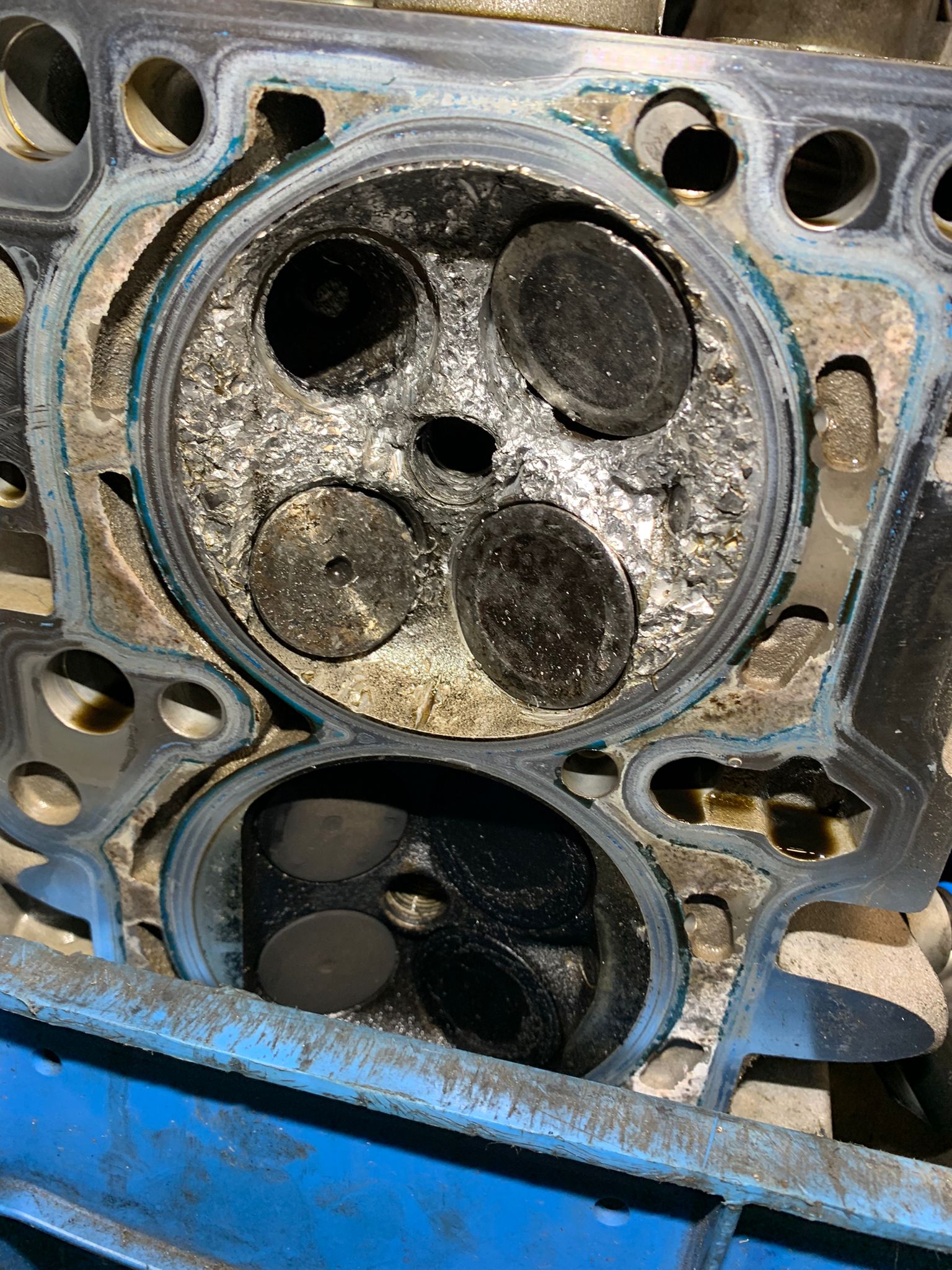

So the head on bank b was pulled off and instantly there was a pretty seismic gulp!
I'm no mathematician but this doesn't add up!

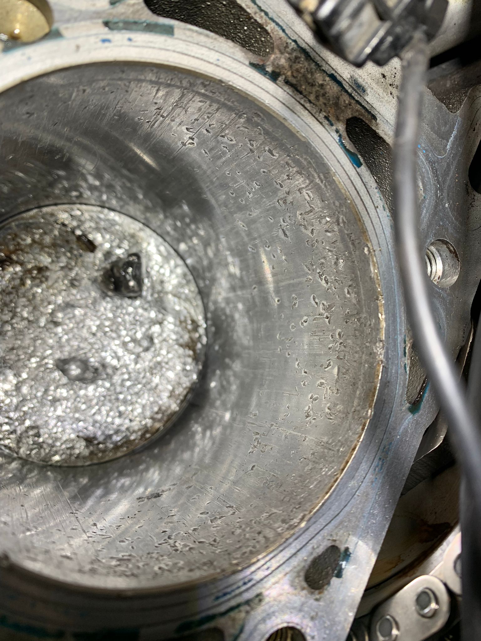

Found it! ya bastid! or what was left of the valve at least :bash:
Maybe it will look less upsetting from another angle? Nope!

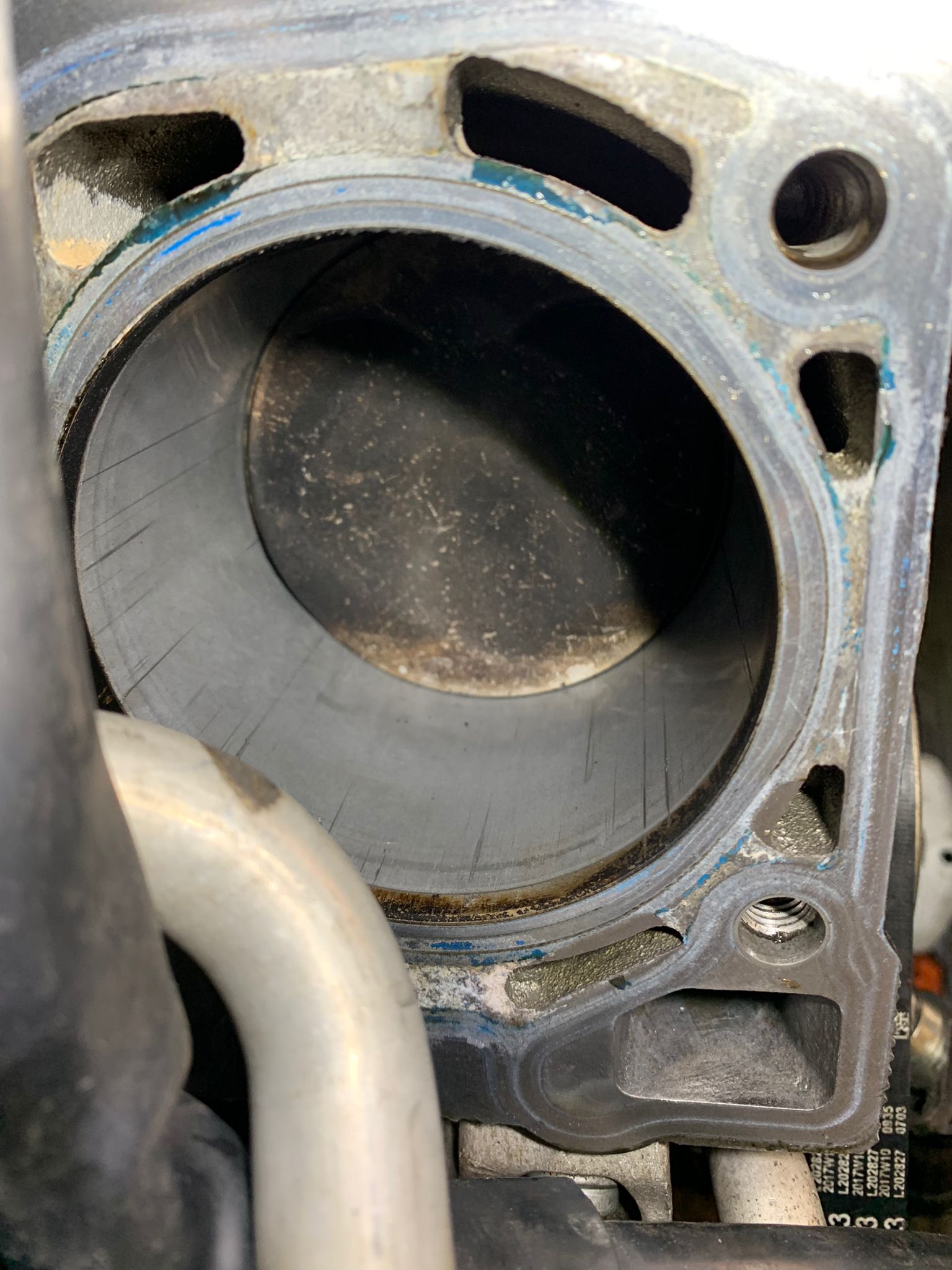

The other cylinders looked to have some scoring too - nothing as bad as cylinder 8 mind!
Now I was faced with a dilemma, what the flip do I do?! I did think about sourcing another engine, there wasn't a lot available but anything that was available would need a rebuild for me to know it had been worth it. You just can't trust anyone selling an engine I have come to find, despite the 1 lady owner that never went over 2k rev claims!
second-hand engines were coming in at 6-8k then will need a rebuild! I thought let's see if Audi stock a replacement block for the BNS - they didn't! They did however say they could build a base engine to the tune of 15K! after I had changed my pants, I discussed it over with the mechanic and ultimately came to an agreement to seek advice from a machine Shop. I thought if we sleeved the damaged cylinder, and replaced the piston, con, and head on bank b that would not only save the block but also mean most of what came out, went back in.

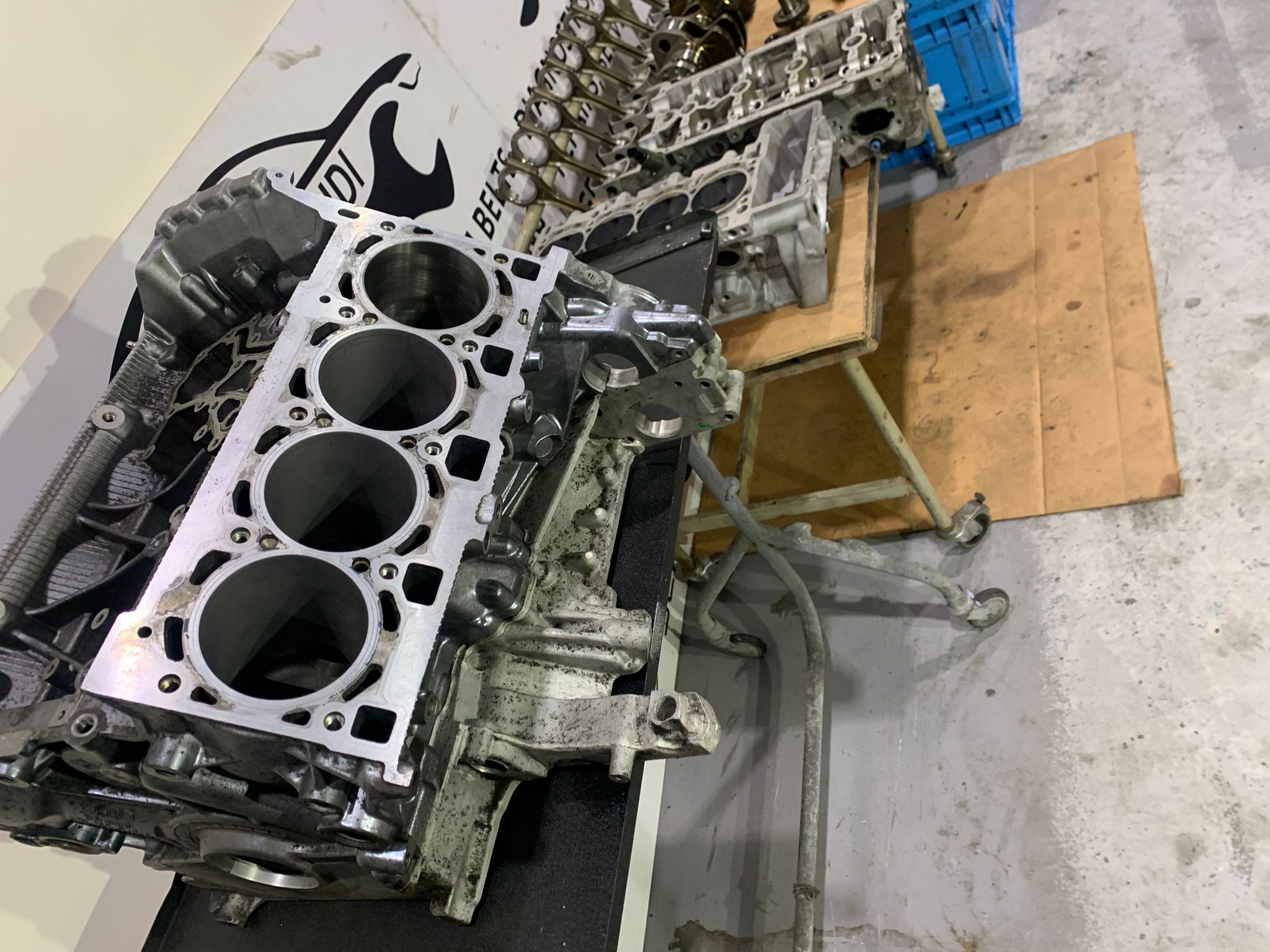

A couple of machine shops were contacted and shown the block. The first point blank said there is no way in hell you're saving that! The second wanted to take the job on but after the block sat with them for 3 months and no progress had even been attempted, we took it back. The third machine Shop looked at the block and rather surprisingly said yeah we can sort that! They agreed to take on the work and we left the block with them.
YF 8990 looked a sad sight!

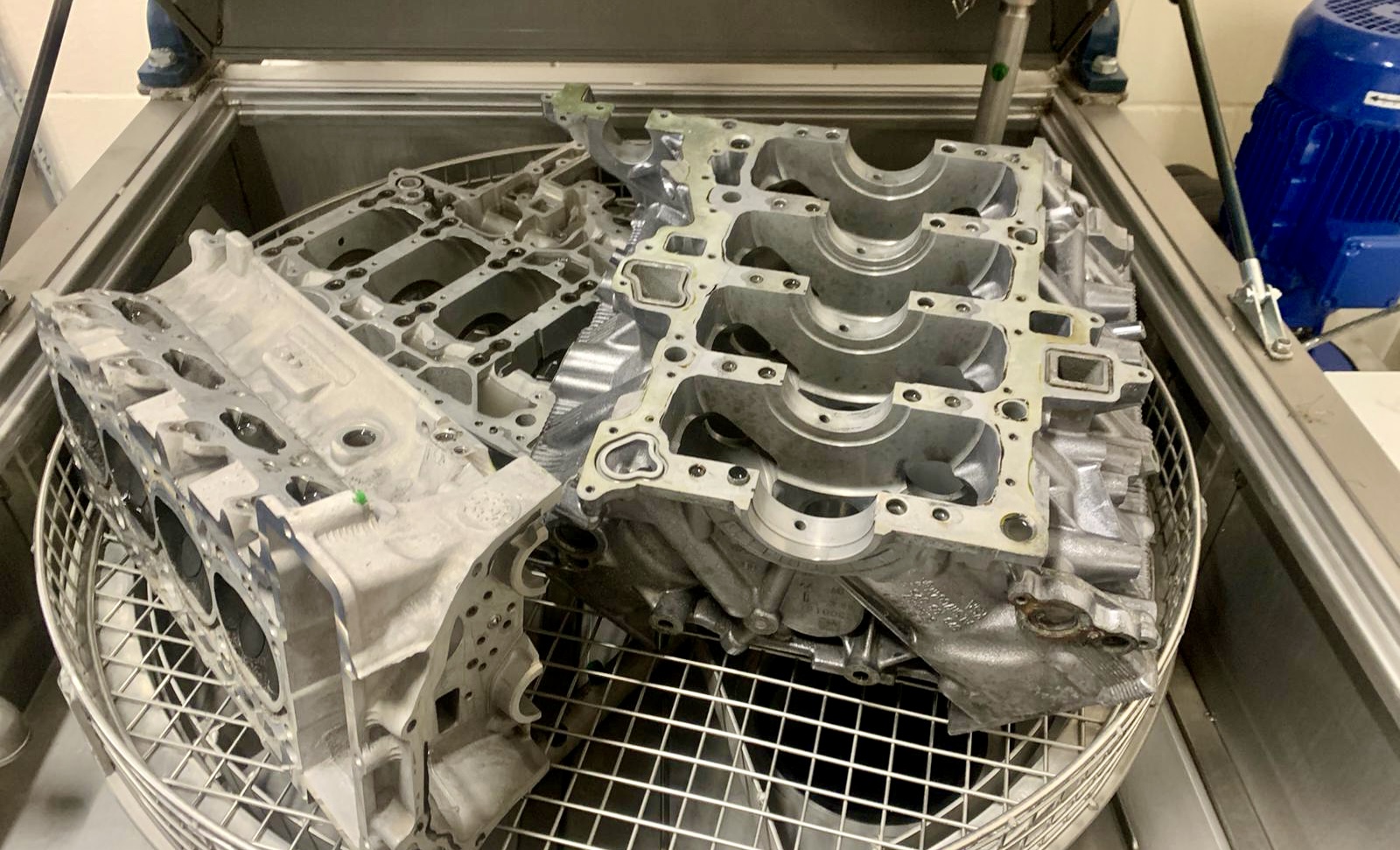

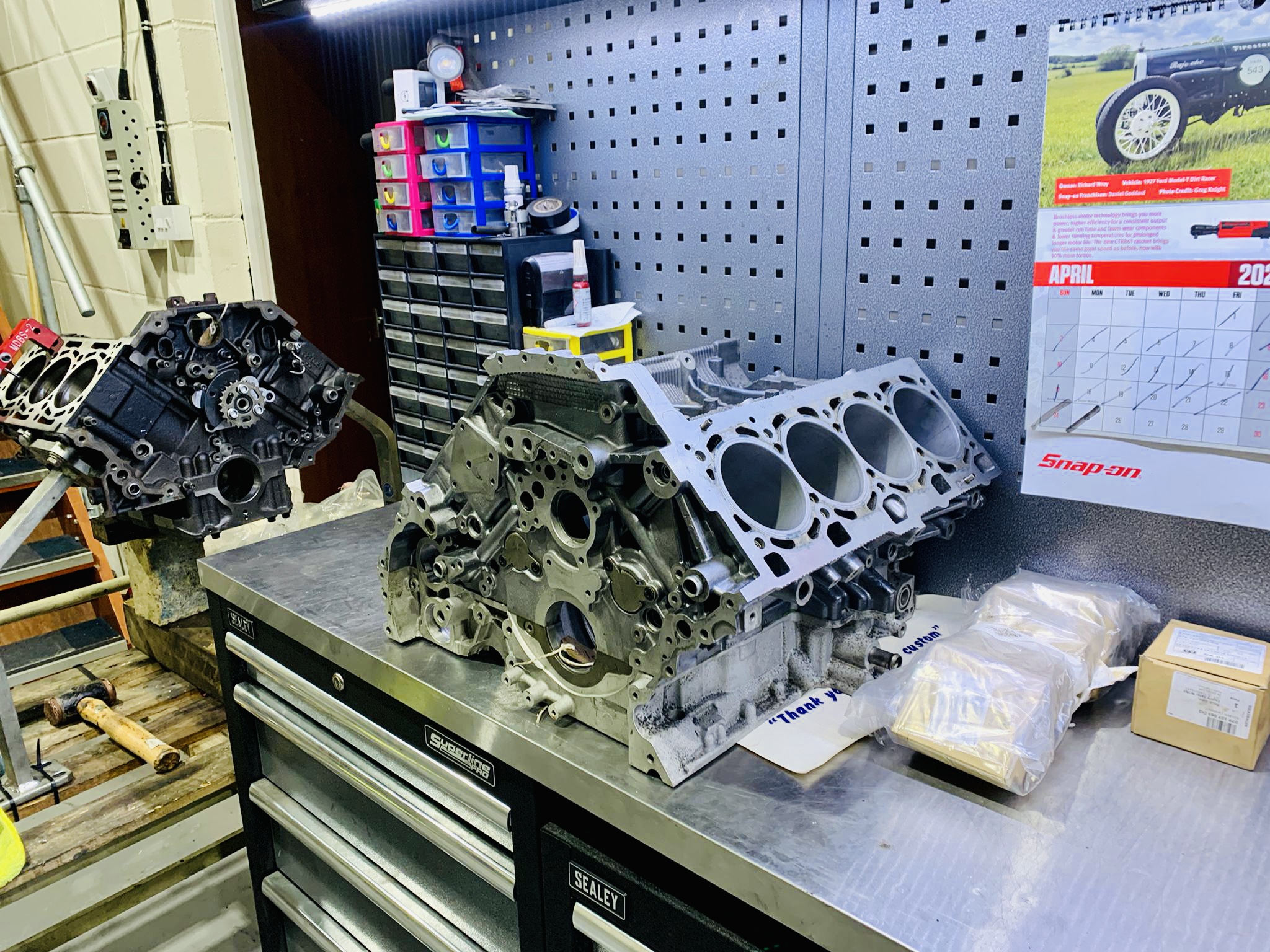

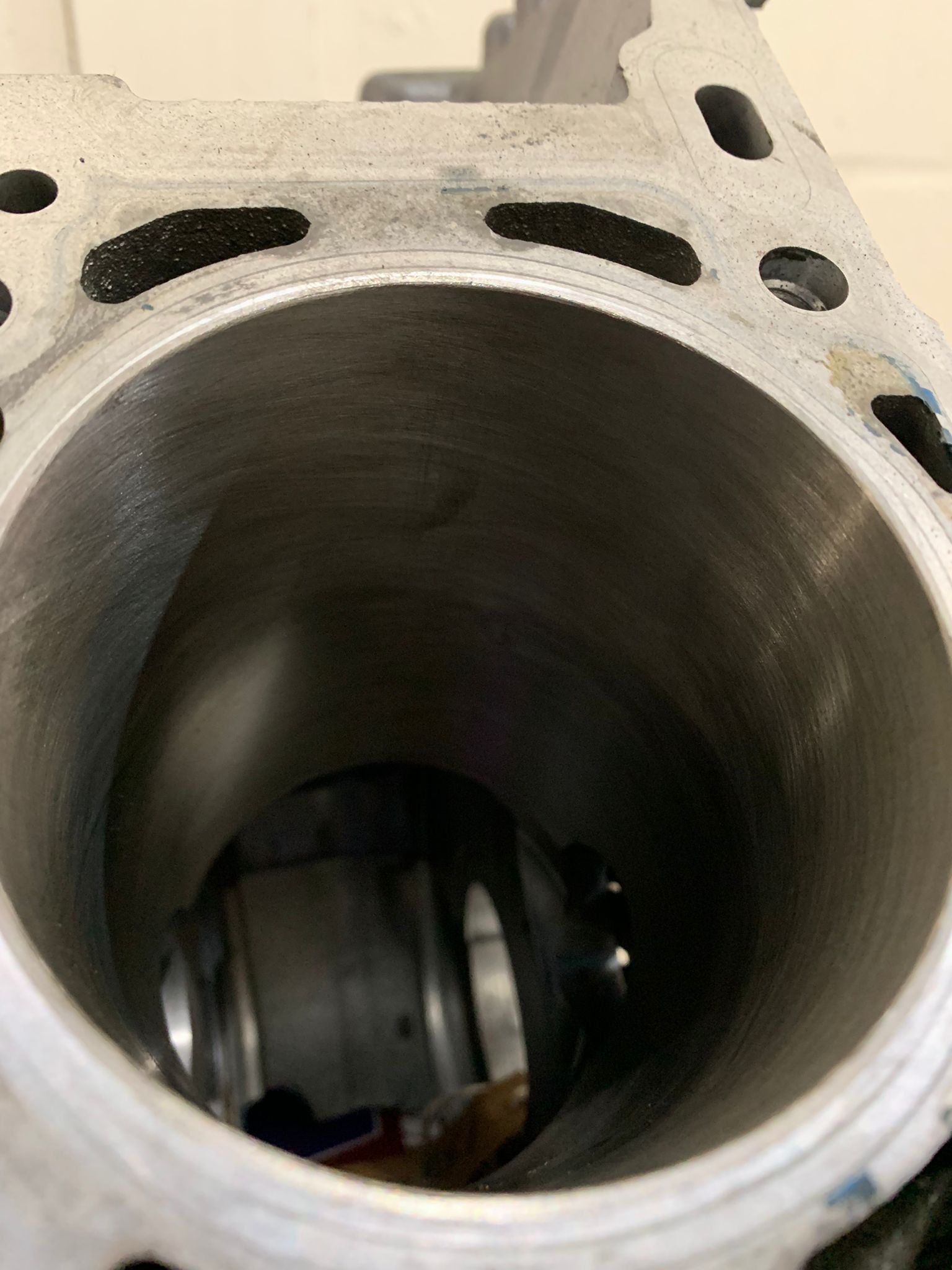

Now it was clear we needed a block and a new head, I looked at eBay to see what was available engine-wise. While there were a few options for between £6000-£9000, there was no way of confirming what life they had spent or how they were driven. I would still go down the route of a rebuild on a secondhand engine but financially it didn't make sense to spend that on a replacement engine and then have it rebuilt.
We got a quote from Audi UK who said a base engine could be with us for just over £16,000 BUT the eta was around two years and that felt like a crazy amount of time.

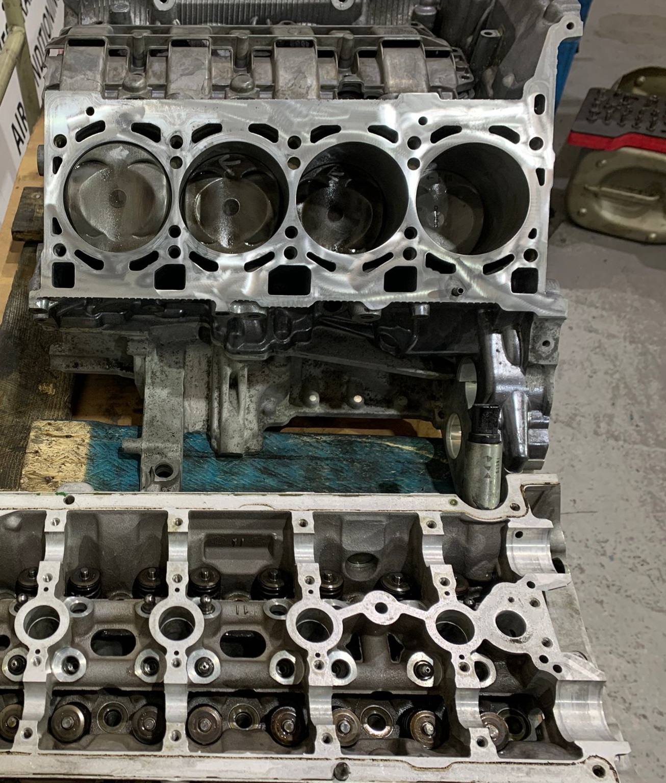

A few machine shops were consulted and they were confident the block could be saved by machining and sleeving, this felt like the way to go as it meant we salvaged the original block.
So off it went, annoyingly there were some crossed wires between the garage that undertook the work and the machine Shop. This resulted in the block sitting around for some six weeks without anything having been done with it. Another machine Shop was consulted who again confidently said they could do the work but also turn it around in a couple of weeks.

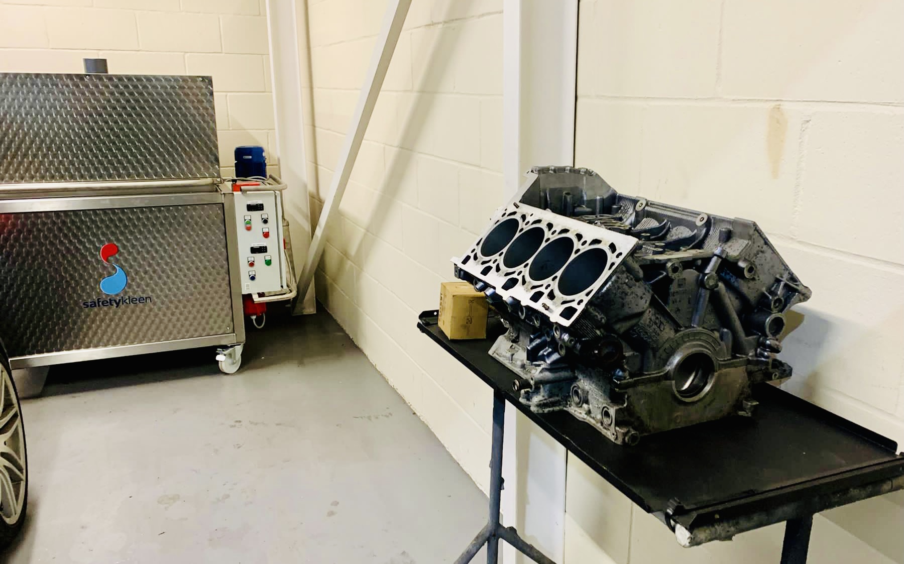

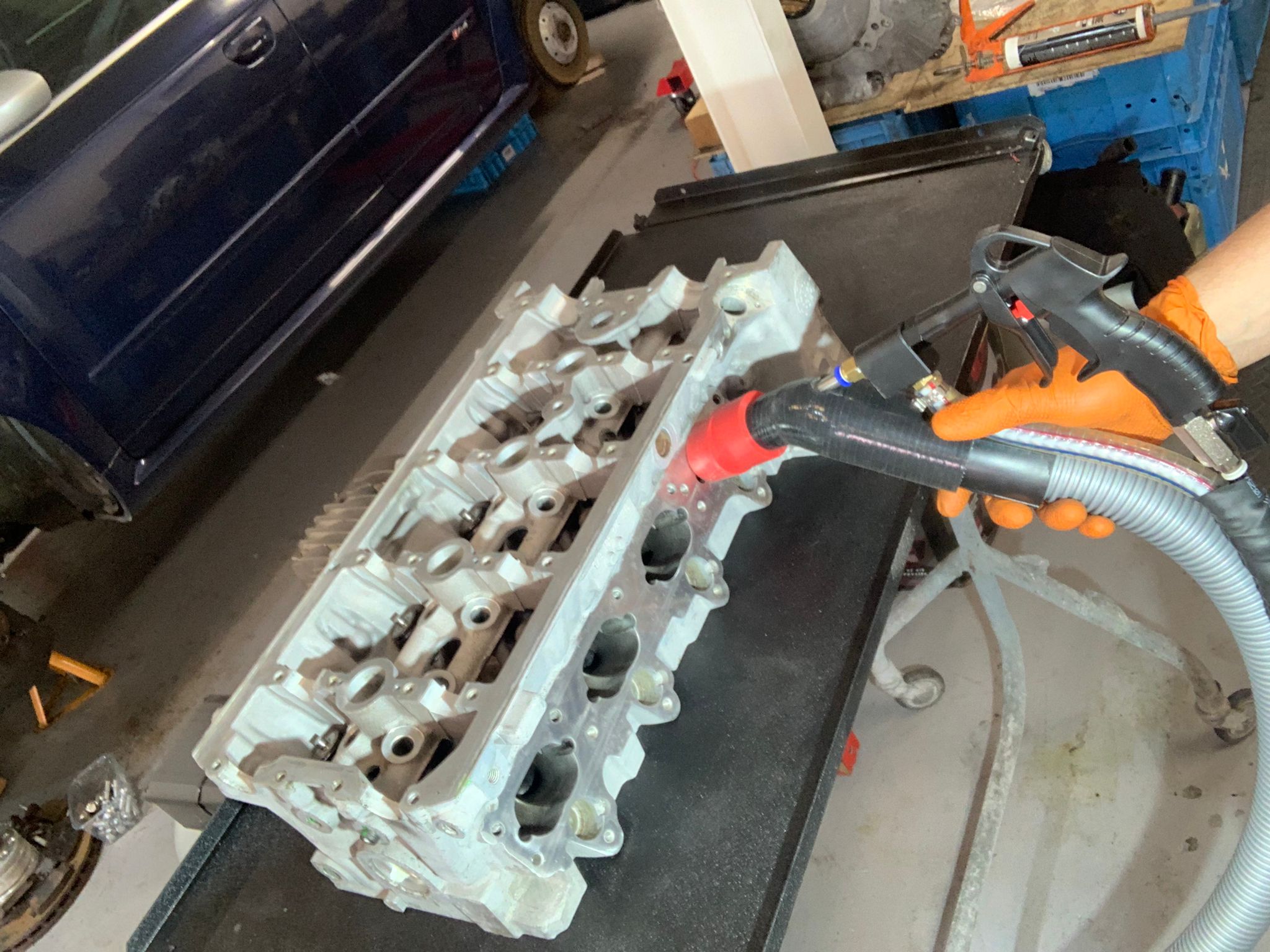

Here are some pics of the block as it came back from the machine Shop, all sorted and looking pretty!
Now it was time to clean the block and rid it of any substances it picked up from the machining process.

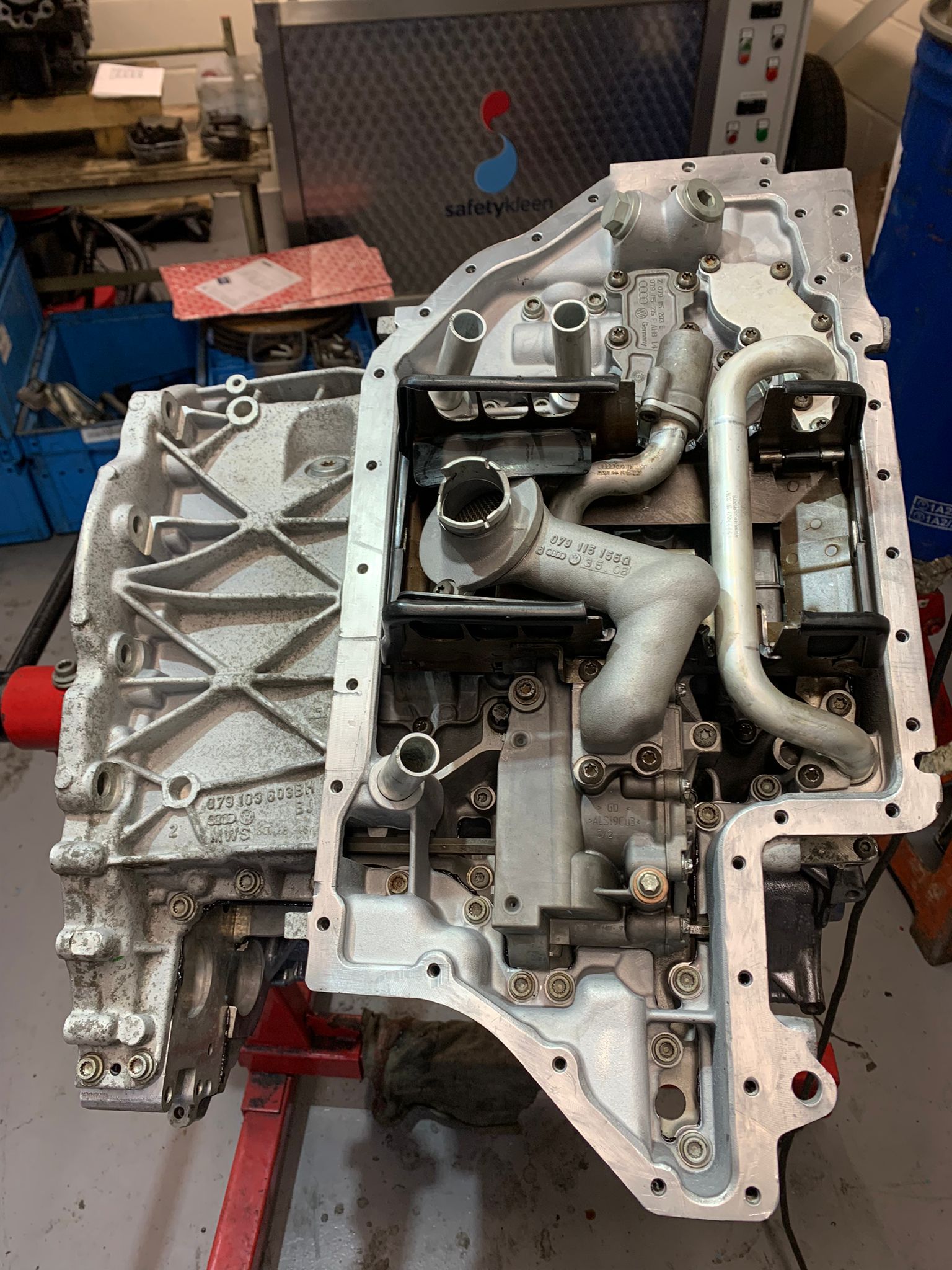

The other engine components got a clean too pre-build

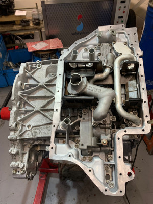

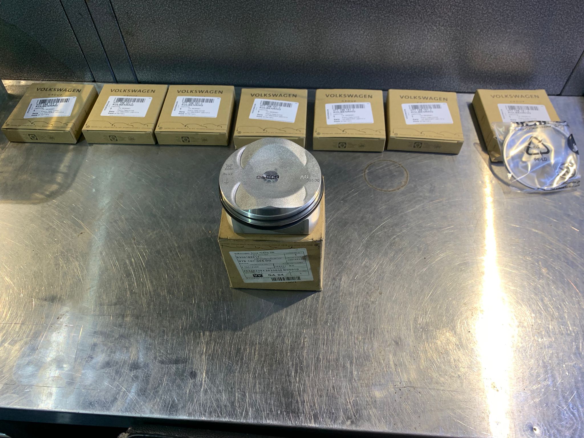

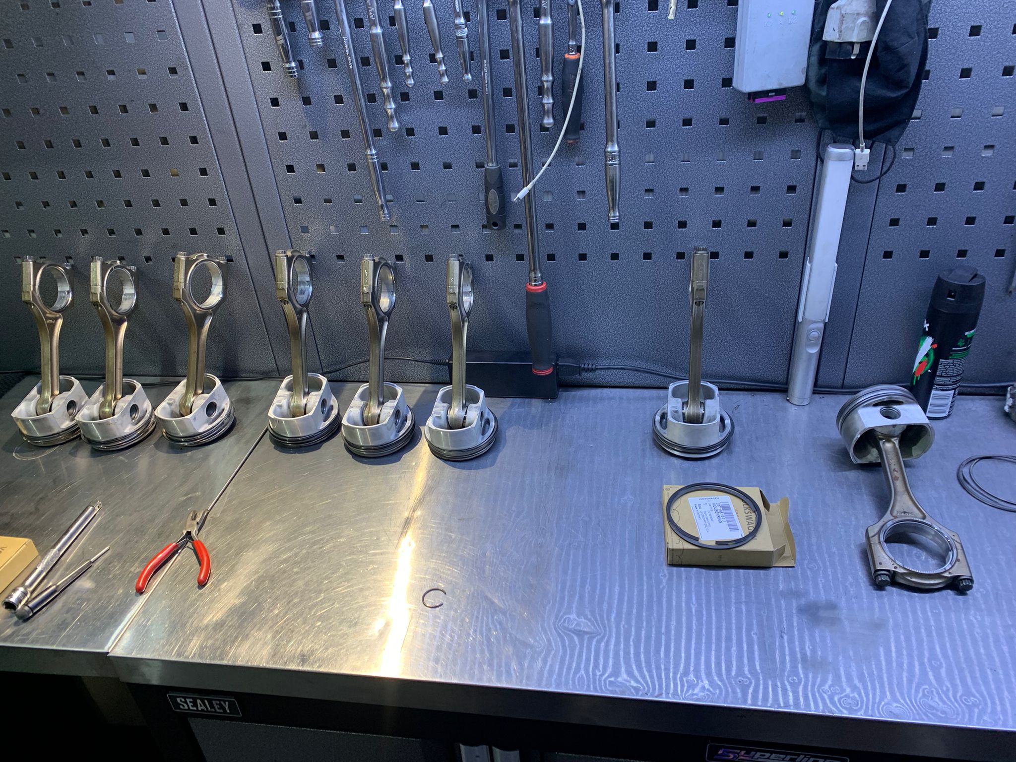

everything was lined up and ready for the build, including existing parts along with replacement parts.

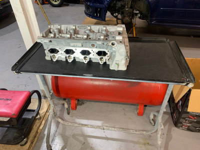

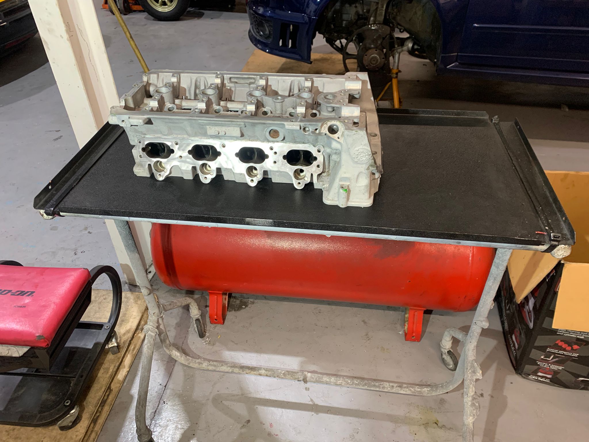

Both heads had some blasting so everything was as clean as possible before assembly.
Luckily the original heads were pretty clean I had them blasted not too long ago.
Could eat your dinner off that!
head casings went on
chains, guides, and cams went on next. This was the most "like an engine" it looked since it was pulled out and opened up!
will leave this here for now, took a lot to get here and finally i was seeing some actual tangible progress on the build.
