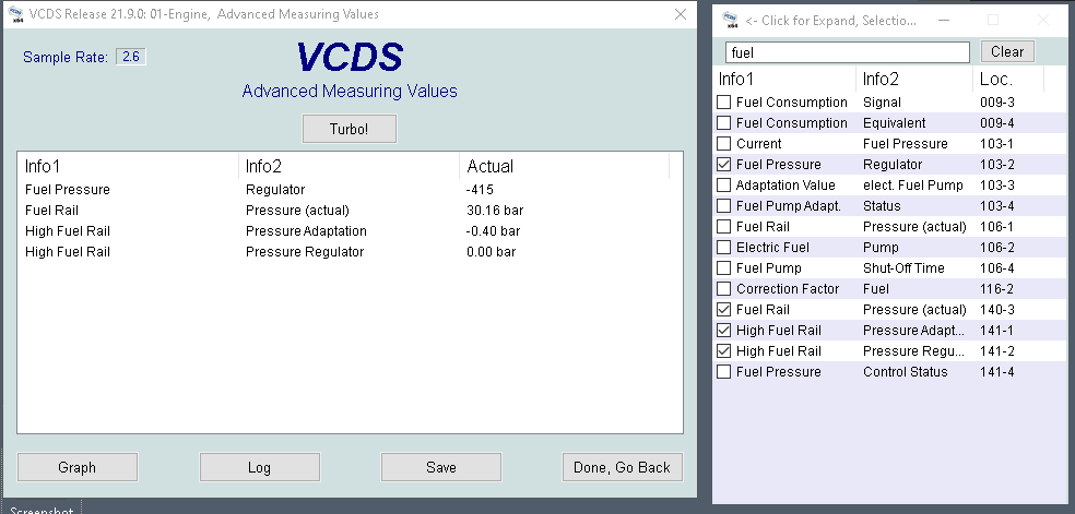

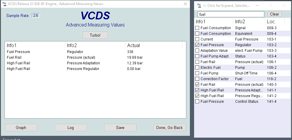

Been having slight issues with rough idling and such so decided to check the fuel pressure using VCDS.
​​​​​​See attached images. First is on idle and second is with ign on only.
Question is, how do I know if its hpfp's or injectors thats leaking? 🤔

I had poor spray pattern and a couple leaking injectors at about 90k miles. If you are taking the inlet off, I think it's worth sending them away for a service to a place that knows them. There's a plastic filter in them that can apparently disintegrate. They should replace that with a metal one. Just be careful taking them out, the injector bodies will be brittle.
That is a good suggestion! I will prob send them away for a full service. Roughly 350 bucks for a complete overhaul so well worth it.
Btw.
When looking in VCDS, can I check fuel pressure for each bank? If so, which values are those in VCDS?
