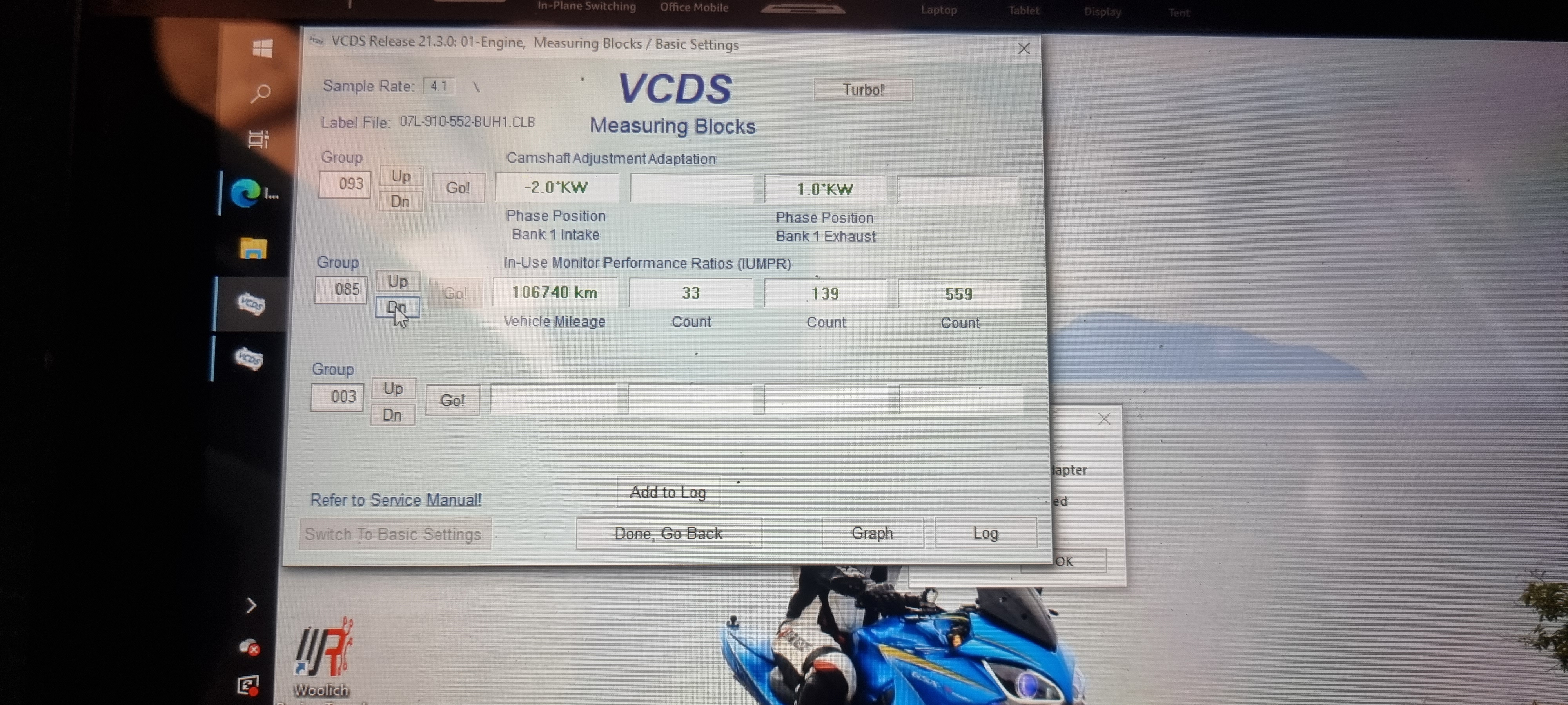

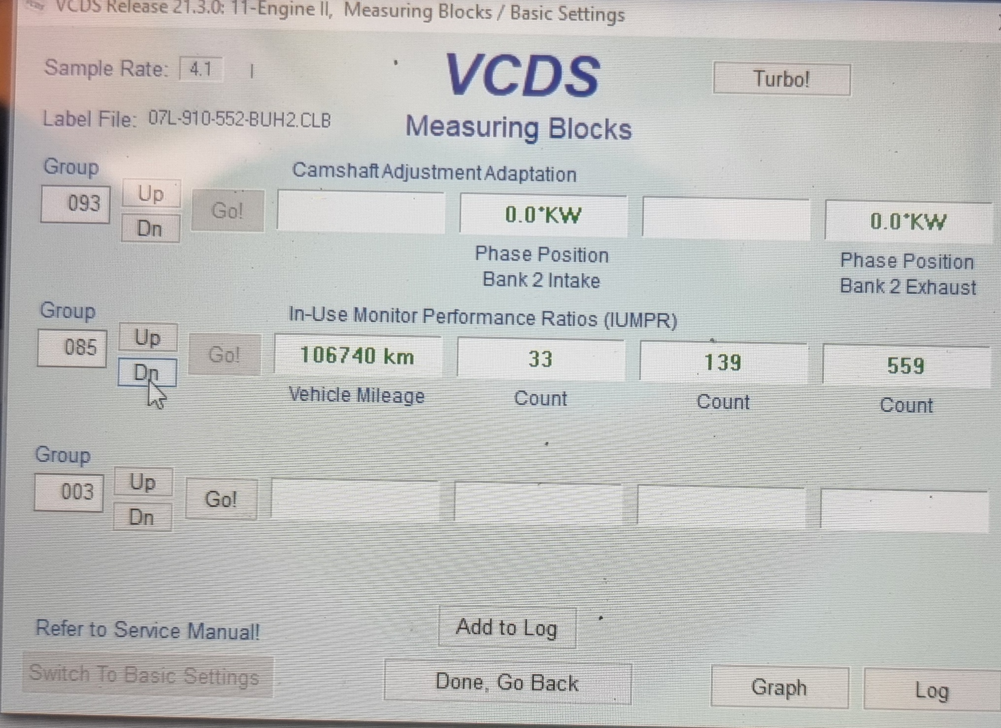

Post by Phuketpaul » Mon Jun 07, 2021 12:15 pm
Hope this is of some use, Car is 2010 and has done 66,000 miles
2010 RS6 plus Avant, MRC Stage 2 747bhp 1059Nm

Post by ruedisrs6 » Mon Jun 07, 2021 1:01 pm
This is definitely of use ! Many thanks for it. Seems that your bank 2 is perfect ! And seems that I need to prepare myself for a chain change.
