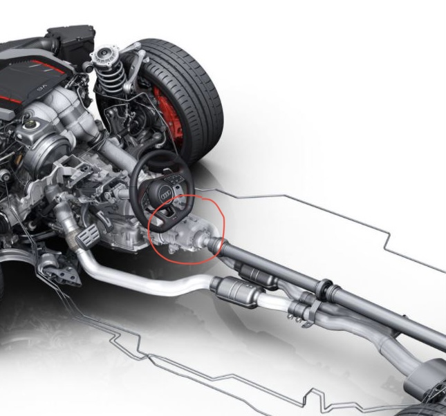

Doesn't look like it in this diagram - RS4 is identical.

This so:

RS4John ? What is the point your trying to convey in this image?
Do you believe you can see the internals of the centre diff in the image you have posted? (and now reposted)

It just looks like a conventional prop-shaft centre coupling - agree with you I thought the B9s had full-fat Quattro - perhaps the illustration is incorrect?

B9 do have full fat Quattro. Your illustration looks OK but it doesn't show if the centre diff is crown wheel or of another type. In fact it barely shows the centre diff at all. Someone would need to remove the outer casing to determine the type.

Centre diff...was expecting something...well in the middle! Thanks. J

The center differential, be it Torsen or Crown Gear, is located where I’ve circled in the image below. My question is whether the B9 RS4 is a Torsen or a Crown Gear type. The B8 RS4 was a Crown Gear. I suspect that the B9 is back to Torsen. Hence my question from the original post, seeking information from those in the know.

Post by diuleiloumou » Thu Mar 31, 2022 4:00 am
Torsen (gen ?? forgot). fitted with zf8.

Post by diuleiloumou » Wed Apr 06, 2022 1:46 pm
Nope, it should be Torsen C type.
