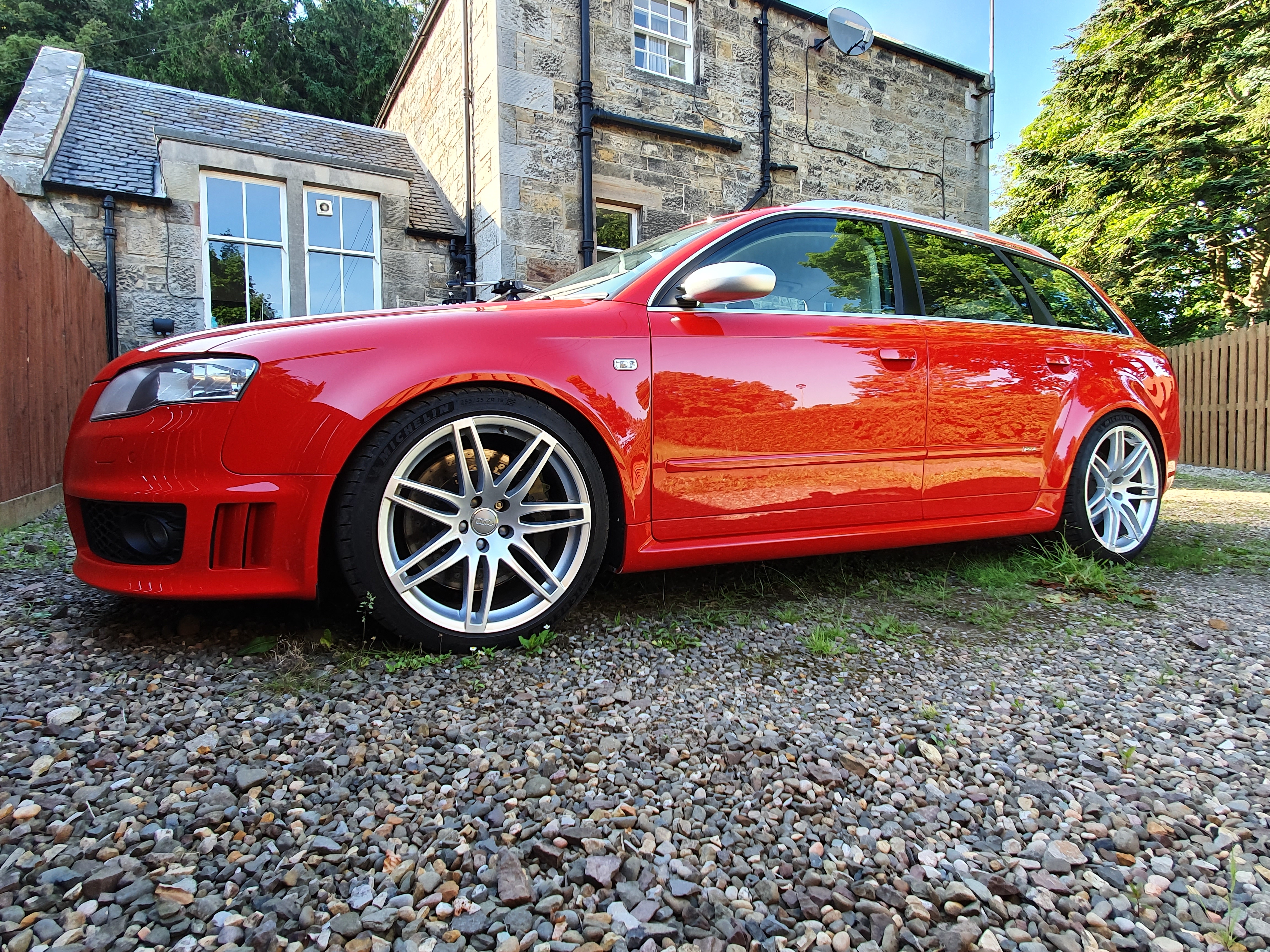

I am on KW V3's but set to SS+ height.
667mm front, 650mm rear (floor to centre of arch).

The H&R coil over kit cant get to standard height regardless of what it is , The kit like all coil overs does LOW and even lower . NOT standard height , the body and shock shaft are shortened to allow for excessive drops ( RS4 50 mm is excessive ) thats why they dont get to standard height .
The other problem is if you wind the adjsuters to the top ( as high as they go ) the car ( shocks ) will top out over bigger bumps
Hope that helps
The best set up fpor the RS 4 to guarantee comfort is the KONI shocks and 20 mm H&R sport springs or standard springs . Peach to drive once that is done
