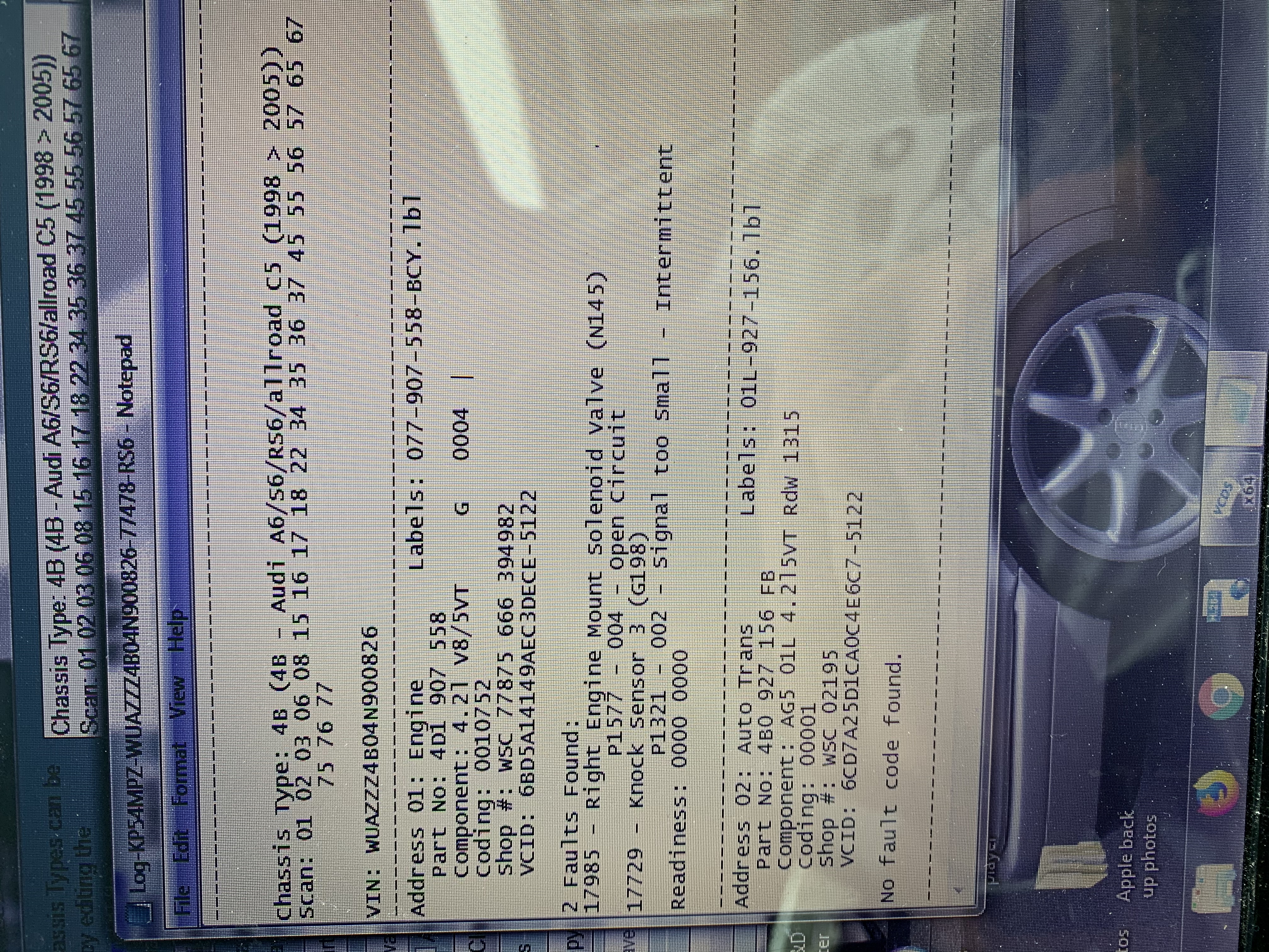

Afternoon all. There always seems to be things to keep us busy. VCDS threw this code today
For knock sensor 3. Cleared the code and drove it to work. Went so much quicker. Went to accelerate again and it almost coughed and the tone of the engine changed and it felt restricted again. Which I presume was the fault reappearing. Will confirm later by checking the code again.
Just wondered how much hassle is involved with knock sensor 3 and it’s location etc. Or is there something else that may cause the code

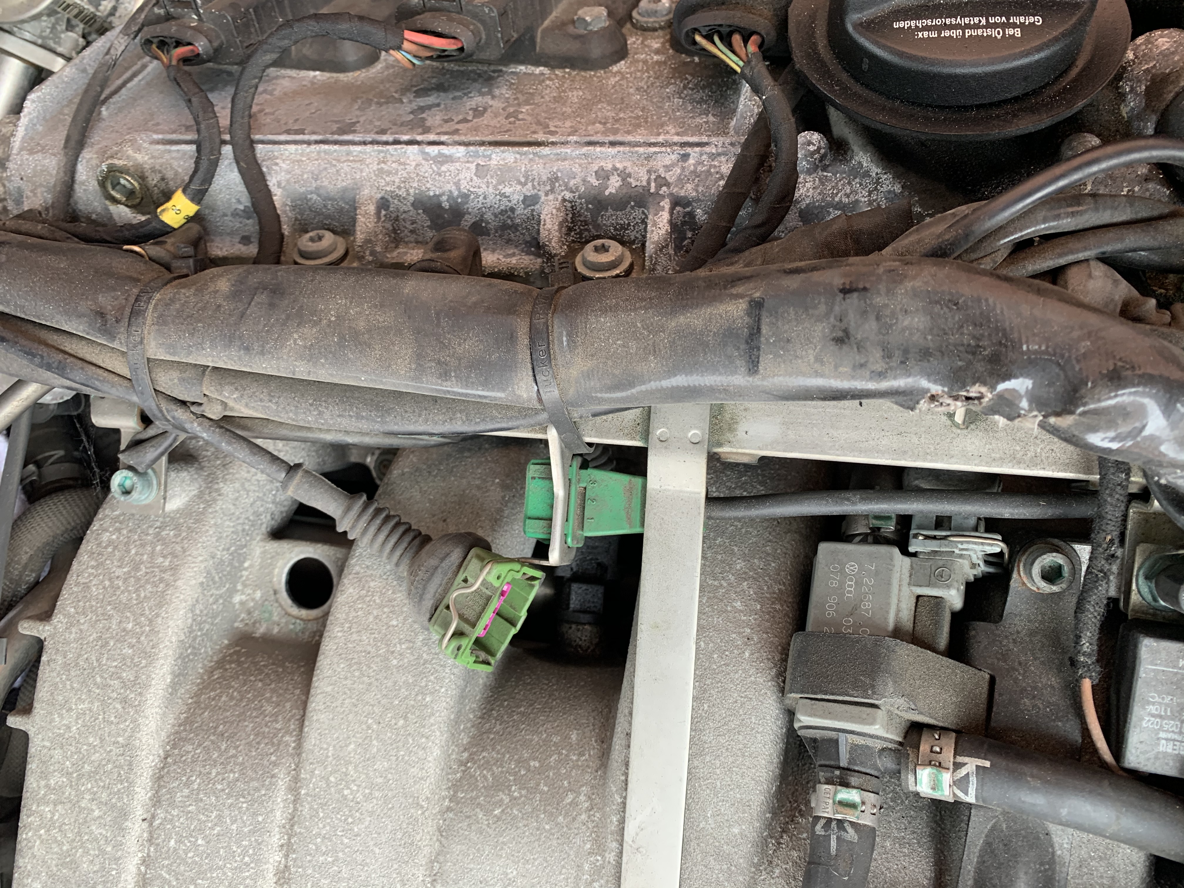

2 of them are under the inlet manifold. The other one is down under the exhaust manifold on bank 5-8.
Check the green connectors that are mounted on the top of the inlet manifold first. I had to replace 2 of these connectors.

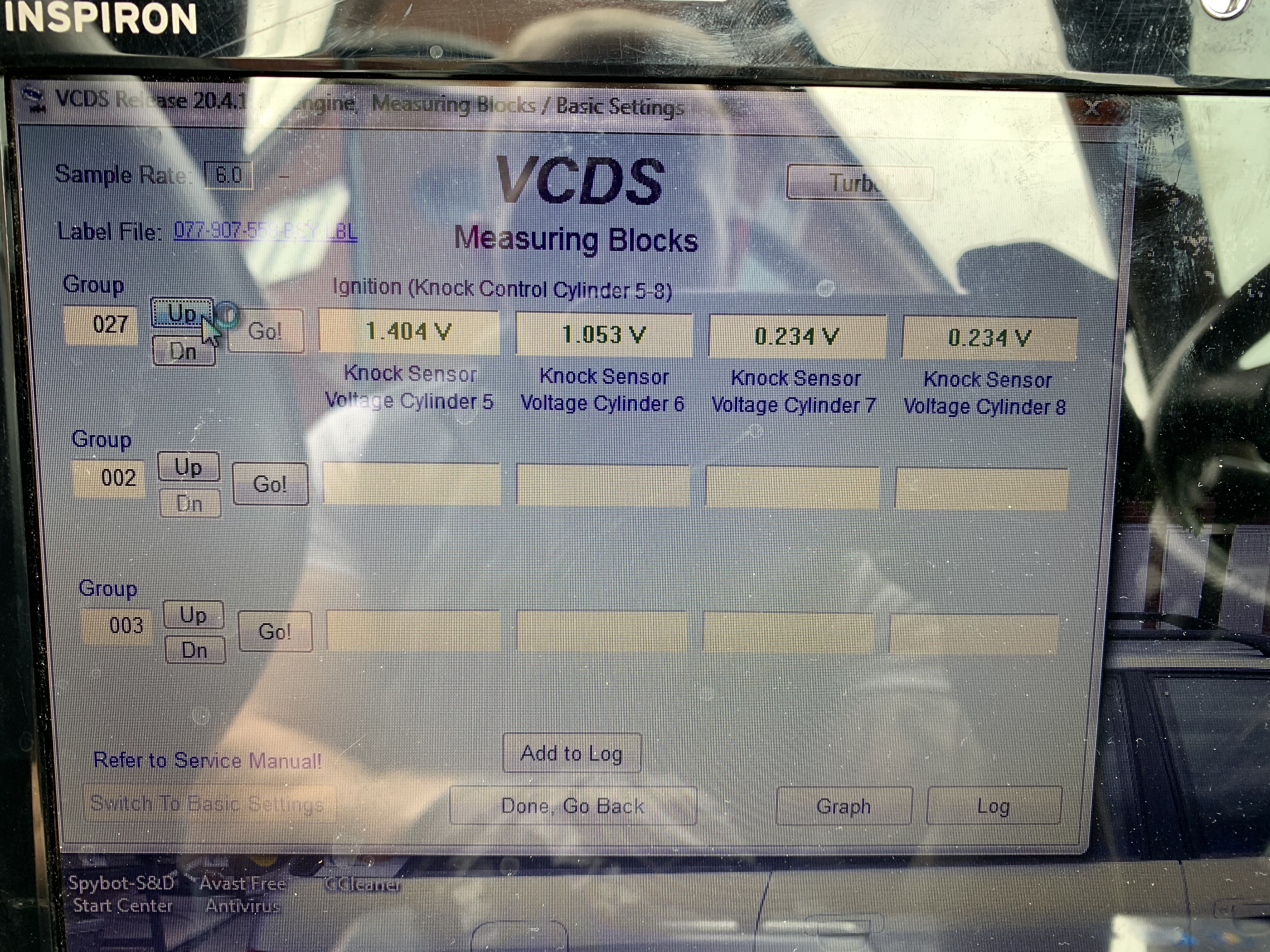

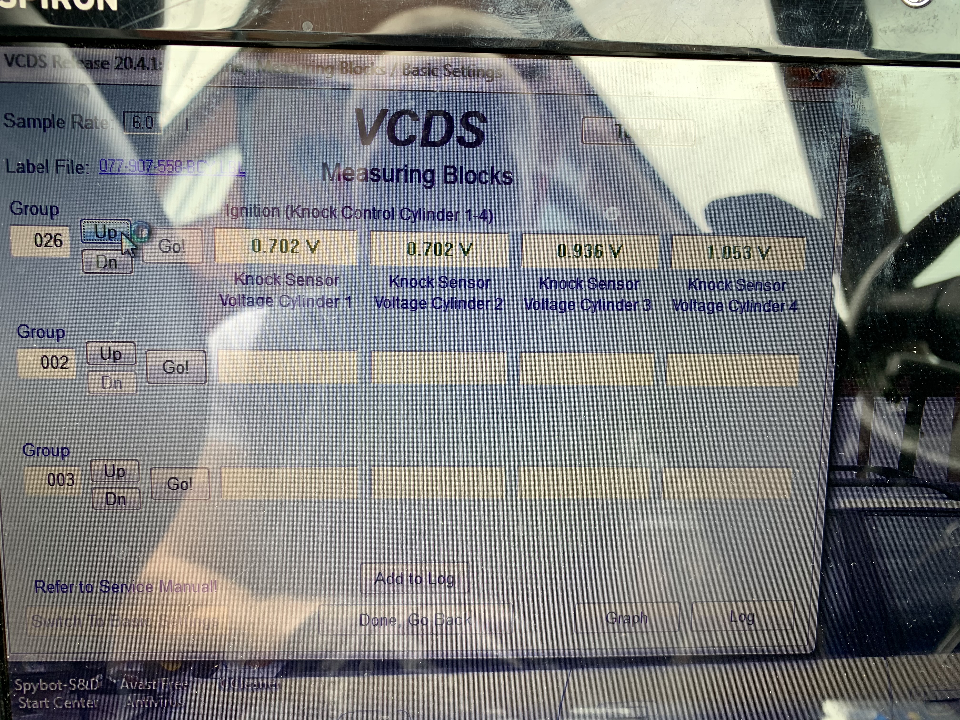

The connectors look ok as does what I can see of the wiring. From what I have researched this is knock sensor 3
My readings on them are Looks like cylinders 7-8 are giving lower readings. Also 1-6 were fluctuating with the engine running. And 7-8 stationary.
Has anyone changed them or any advice for what needs removing to get to them. Looks like inlet manifold off and then accessible. But any help appreciated
the wire from this disappears down the front of the inlet manifold out of sight. My readings on them are Looks like cylinders 7-8 are giving lower readings. Also 1-6 were fluctuating with the engine running. And 7-8 stationary.
Re: Knock sensor help please
Yeah, 7 and 8 are checked by knock sensor 3 (G198).
You could check the connections at the knock sensor, but you'll have to get to it first and it's under the inlet manifold.
