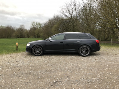

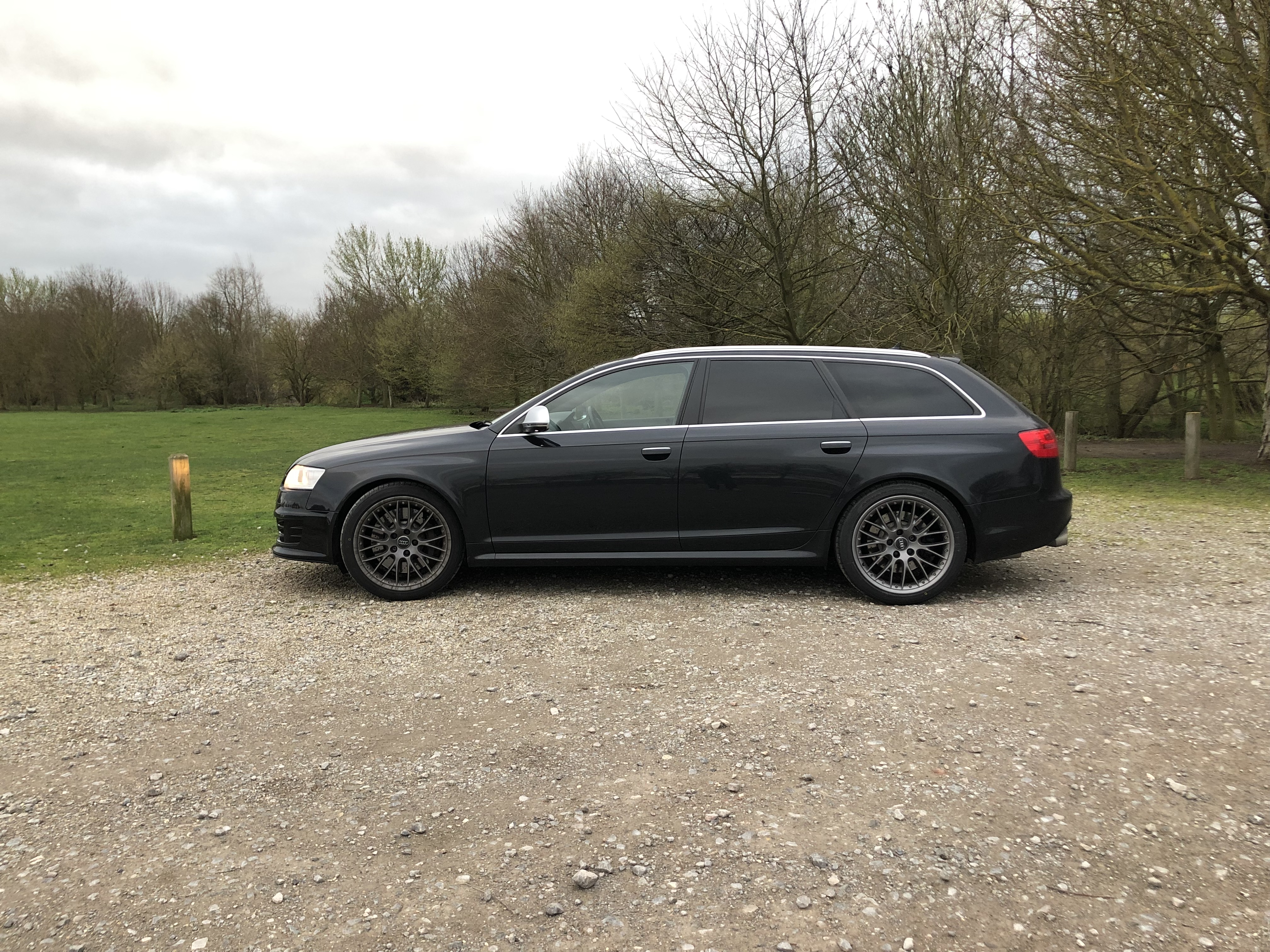

Thanks, much appreciated. Tempted to try and get a set as I think it would potentially make a nice OEM+ look.
