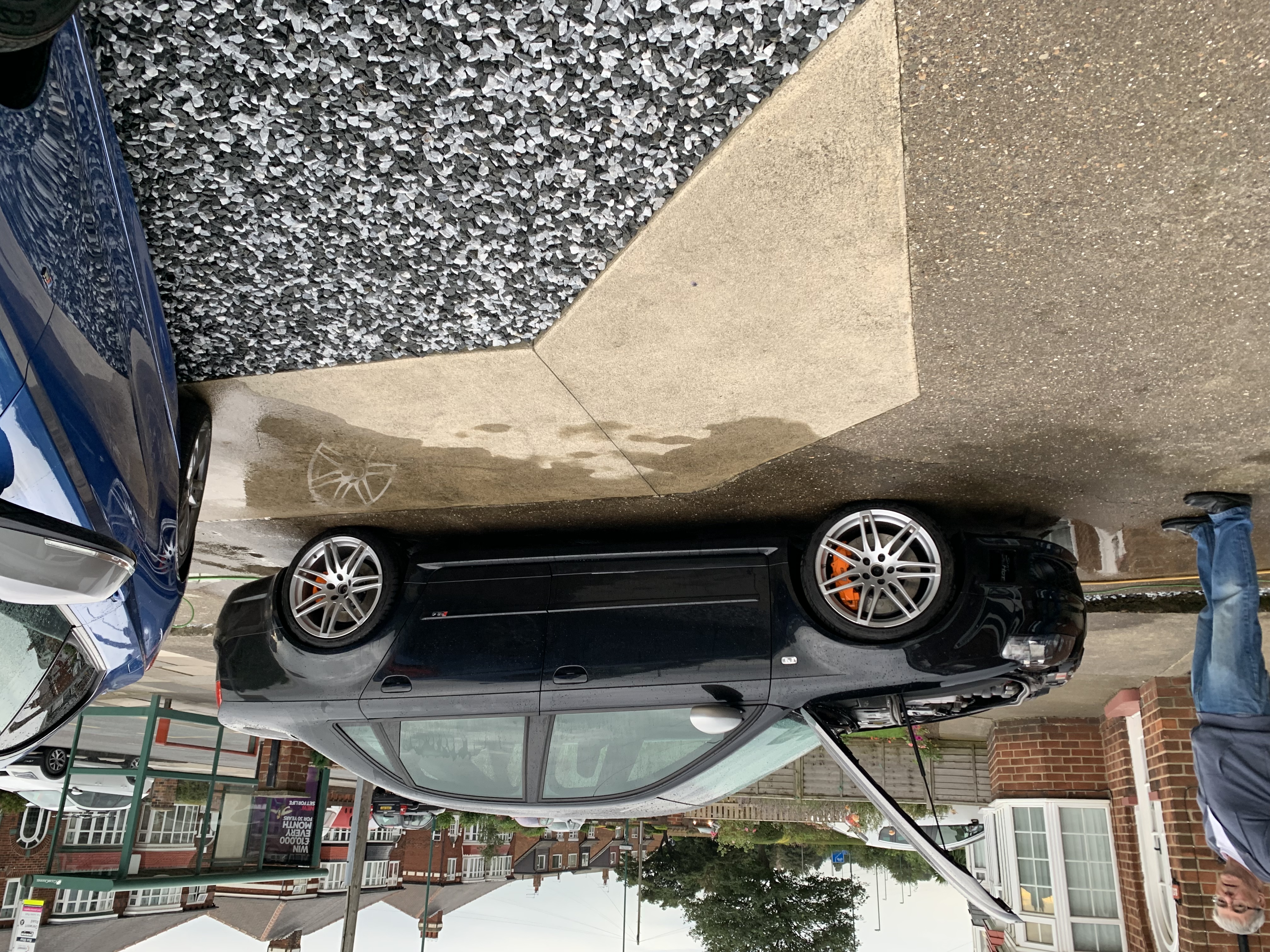

Is it lower than that? Mines on H&R too
That’s my measurements from top of wheel rim to arch
2007 B7 RS4 Saloon, Phantom Black, Forge Oil Cooler Kit, custom home made air feed, H&R Coilovers, H&R anti roll bars, 10mm H&R Spacers, Milltek decat downpipes, Milltek Non Res Valved Exhaust, Reyland Motorsports front & rear discs with Hel braided Hoses, full underbody overhauled inc powdercoated subframes and arms, 034 solid subframe bushes and every joint, arm or bush replaced.

That's weird because looking at the photo it looks at a pretty similar height. Im at work at the moment but when I get home i'll park on some level ground and get some measurements on here- maybe even some pictures too If I can get my browser to upload them :shock:
