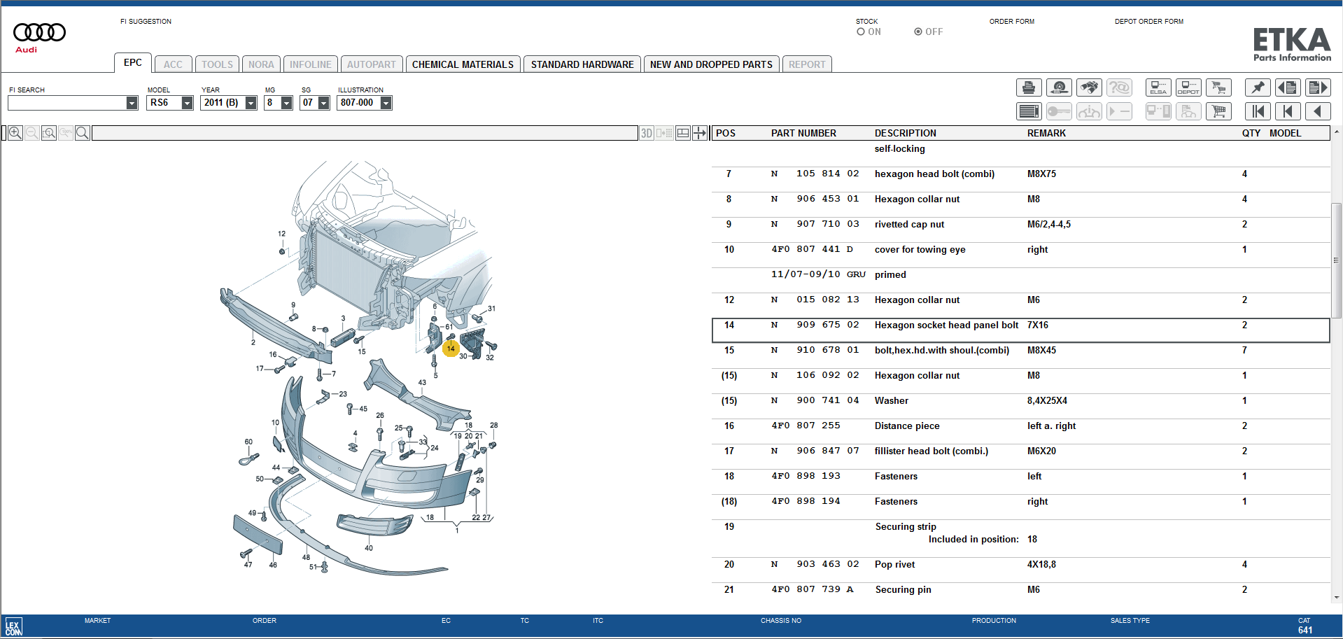

Spoke too soon - I think I've found it;
N 909 675 02
https://www.ecstuning.com/b-genuine-vol ... n90967502/
That looks like it hopefully.

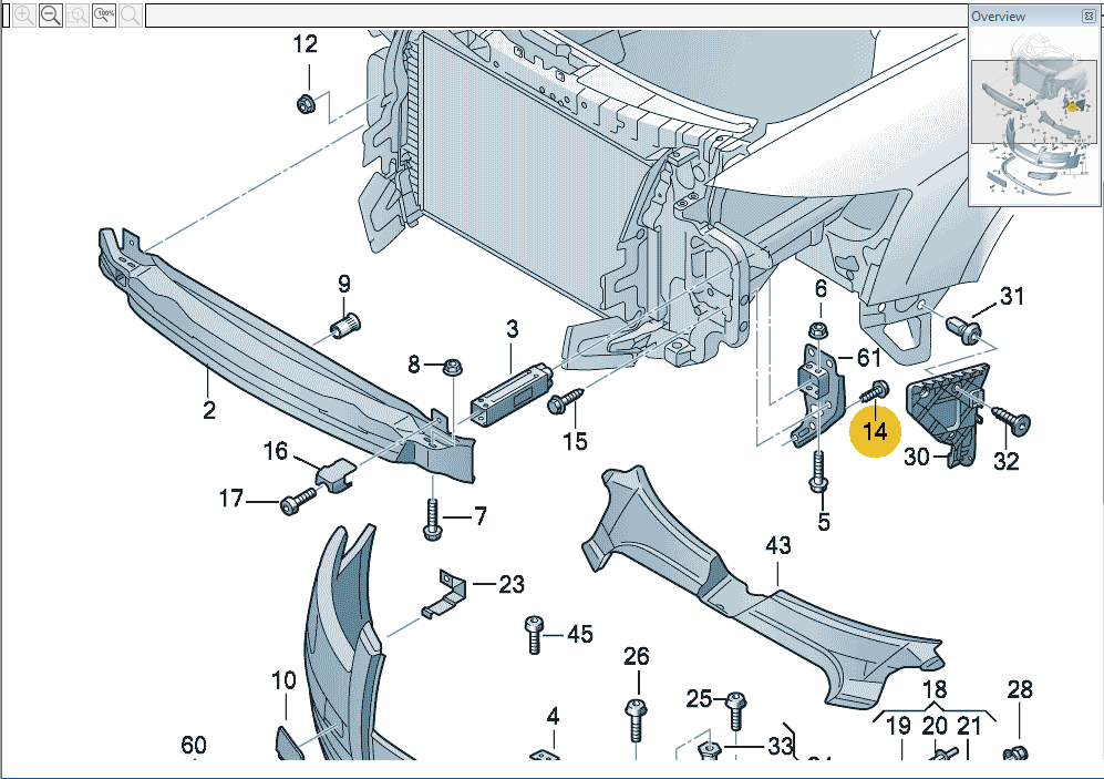

Post by douglas96 » Tue Jul 30, 2019 10:54 pm
Closer look at the placement.

They're 7mm. I independantly found the same part - I'll take a look tomorrow because if those are actually the screws I can't for the life of me think why I removed them.
Jim Haseltine
Posts: 908
Re: Parts left over - quiz - solution
Post by Jim Haseltine » Wed Jul 31, 2019 3:51 pm
And that was them.
Just above the 'r' in share and below the rad pipe. I certainly don't remember removing them but maybe it was the only way to get the radiator off. Very awkward to refit with everything else in place.
