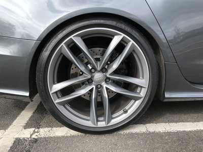

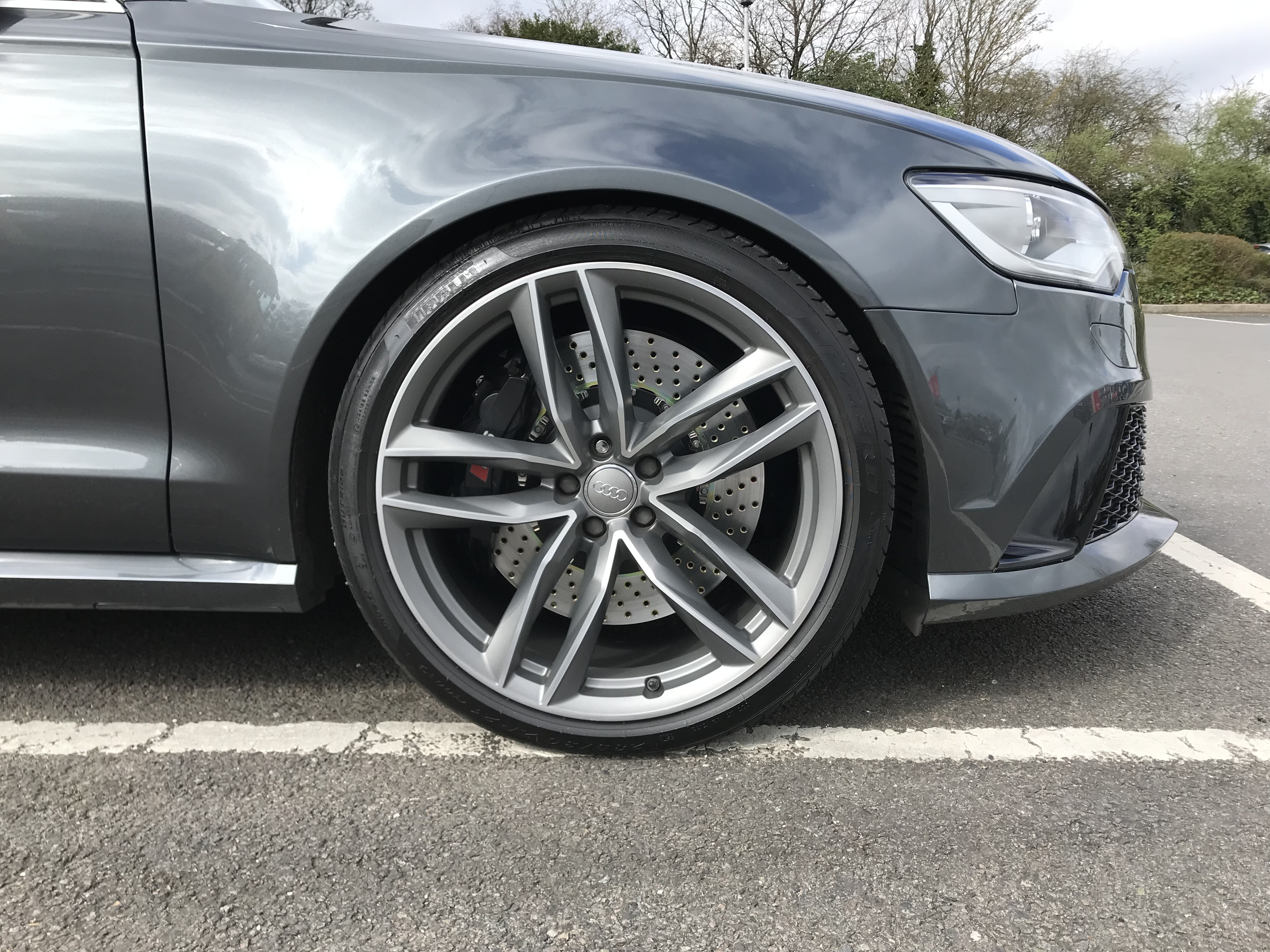

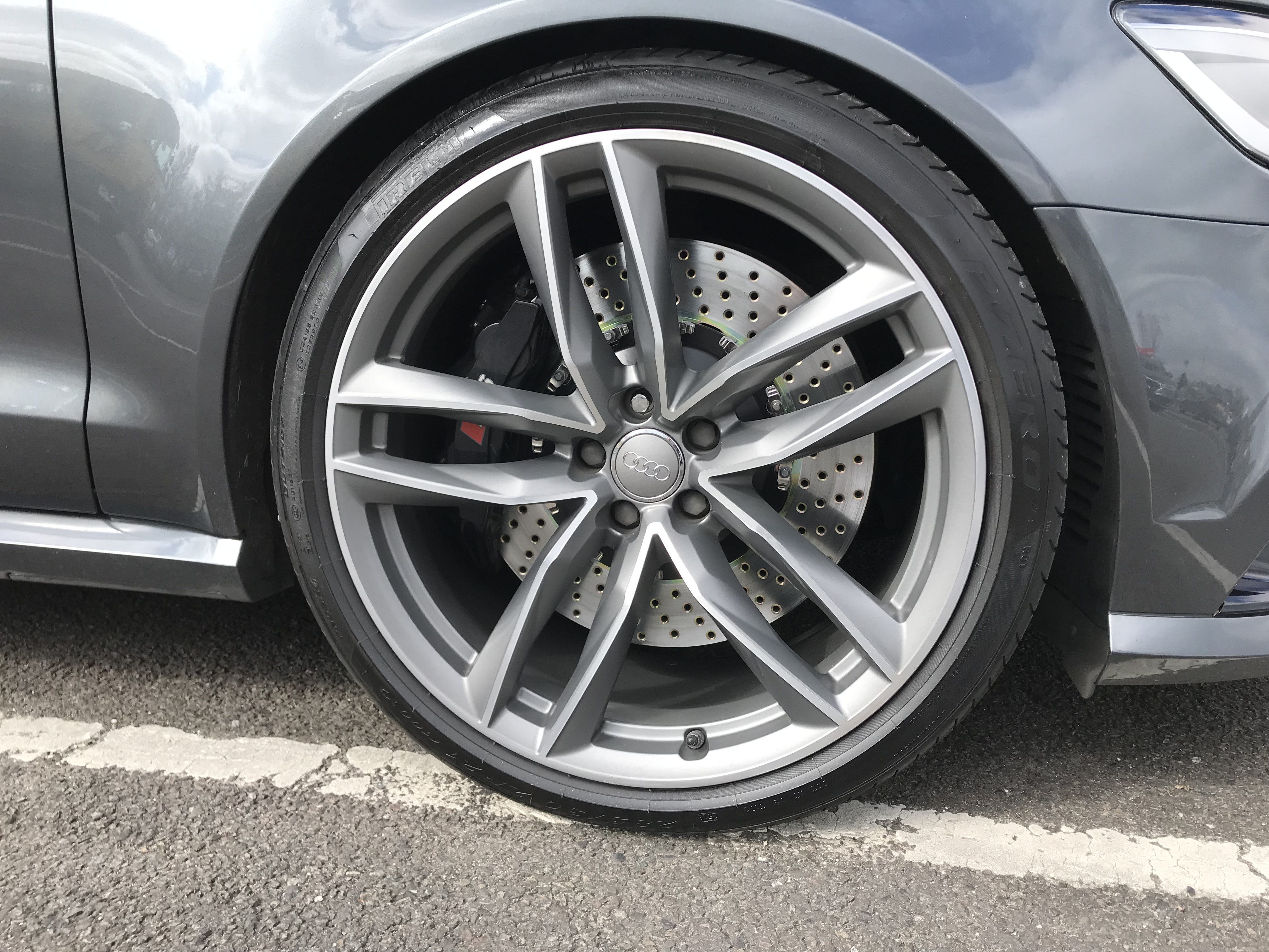

Finally got round to fitting the new brakes! Bells and Rotors, cross drilled. Larger 410 discs on the front using spacers on the calipers. Brembo Pads all round.
Big thanks, to Jamie at RB Racing for supply of the discs 😉, MikeFish for sorting me a good deal 😉, and LeeRS6 for pointing me in the right direction for some good priced front Brembo pads 😉
Still bedding the discs and pads in so can’t comment on performance.
Fitting of discs and pads was all straight forward, and no Vagcom was needed. (Unbolted the rear handbrake motors to do the rears). :thumbs:

That is impressive. Interested to see what the durability and resistance to warp is, wonder if there is any play in the calliper under full braking with the spacers.

Why are there spacers on the calipers?
Re: Friday Brake Porn! RB Racing Discs
Post by MikeFish » Thu May 30, 2019 10:57 am
bam_bam wrote:
Thu May 30, 2019 10:25 am
These discs are 20mm bigger than OEM (410mm) so spacers are needed to move the caliper into the right position.
More of an adapter bracket than a spacer.
Post by bam_bam » Thu May 30, 2019 11:19 am
Ah, got it. So not a whole new bracket?
Post by MikeFish » Thu May 30, 2019 12:12 pm
No I don't think so. Seem to recall just a small adapter. Can't find a photo of it now.
welwynnick
Posts: 573
Post by welwynnick » Sun Jun 16, 2019 11:00 am
I think you just use long calliper mounting bolts plus the spacers to move the callipers.
The spacers probably aren't exactly 10mm because of the geometry.
It's a mod I did on another car. It took a bit of iteration, but it turned out to be very effective.
You can only do it this way, using spacers instead of brackets, if the calliper mounting bolts are longitudinal rather than transverse. The vast majority are transverse.
