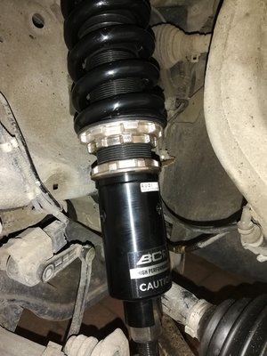

Hi Guys,
Thought I would put up a post as I am just in the process of completing my swap from DRC to BC Racing coilovers. Potentially a risky choice to move away from the well documented Bilsteins/KW's. I thought I would give them a go as I have friends who've been very happy with them in the past on other marques and was interested due to the same price bracket as B14's but with the adjustable damping and the ability to rebuild/overhaul them should it be needed in the future relatively easily.
Anyway I thought I would put up a post detailing how I get on with them as I go for anyone that may be interested as there isn't a lot of info from people running these on our cars outside of a couple of US posts.
They are currently fitted and the first thing that I will say is the can certainly go low, they are set a bit too low out of the box for me so I'm just waiting on a bit of time to get it up in the air and set the height to where I would like it before I can go out and really test them in anger. Not the easiest with a new baby but hopefully this weekend I can get it all done and get some feedback.

So far I'm happy with the quality for sure and the fact that you adjust the ride height without altering the preload on the spring is definitely a nice touch. Once I've got it setup and I've corrected for the added camber as best as I can i think I may well go and get it corner weighted to make sure it's all corrrect.
Am I right in thinking that I can correct the camber on the rear with what looks like an eccentric bolt on the upper arm?

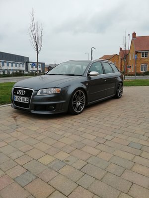

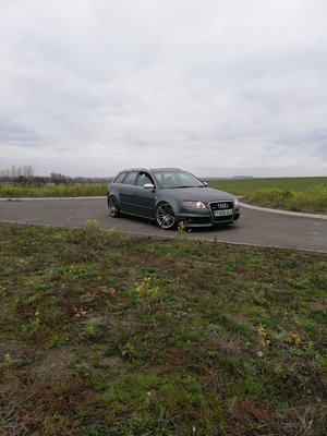

So this is where it's at as I start today.
Its 62.cm at the front and 61.5 at the back. To be honest I quite like how the front sits so I'm going to raise it only til it doesn't catch maybe 5mm and the the back 15mm so its all levelled up

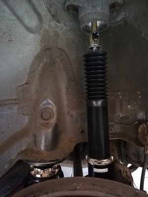

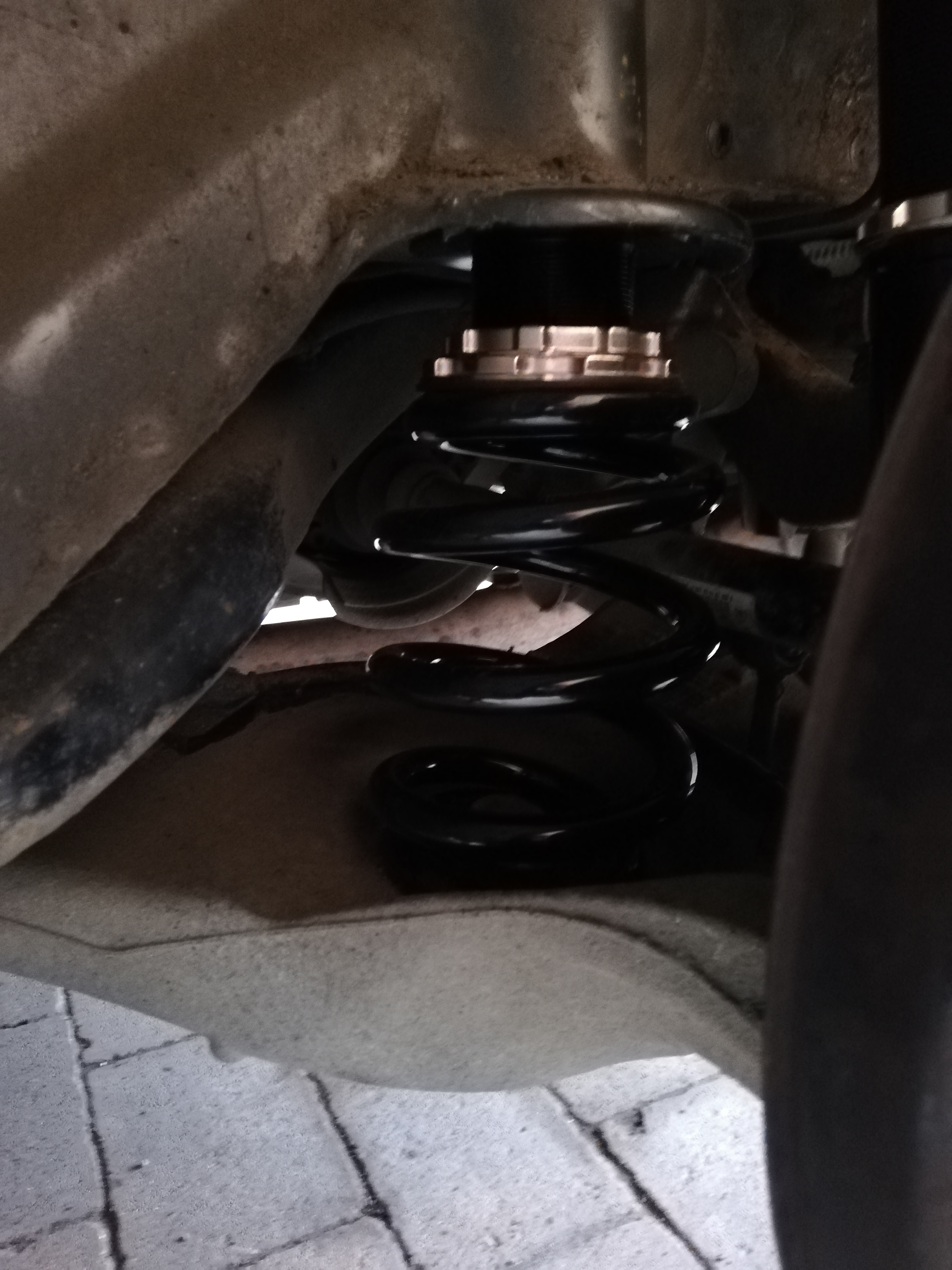

Here's a couple of pics of the rears, I've mounted the adjuster on the top so I shouldn't have to drop the subframe if I want to make any future adjustments.

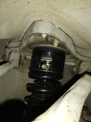

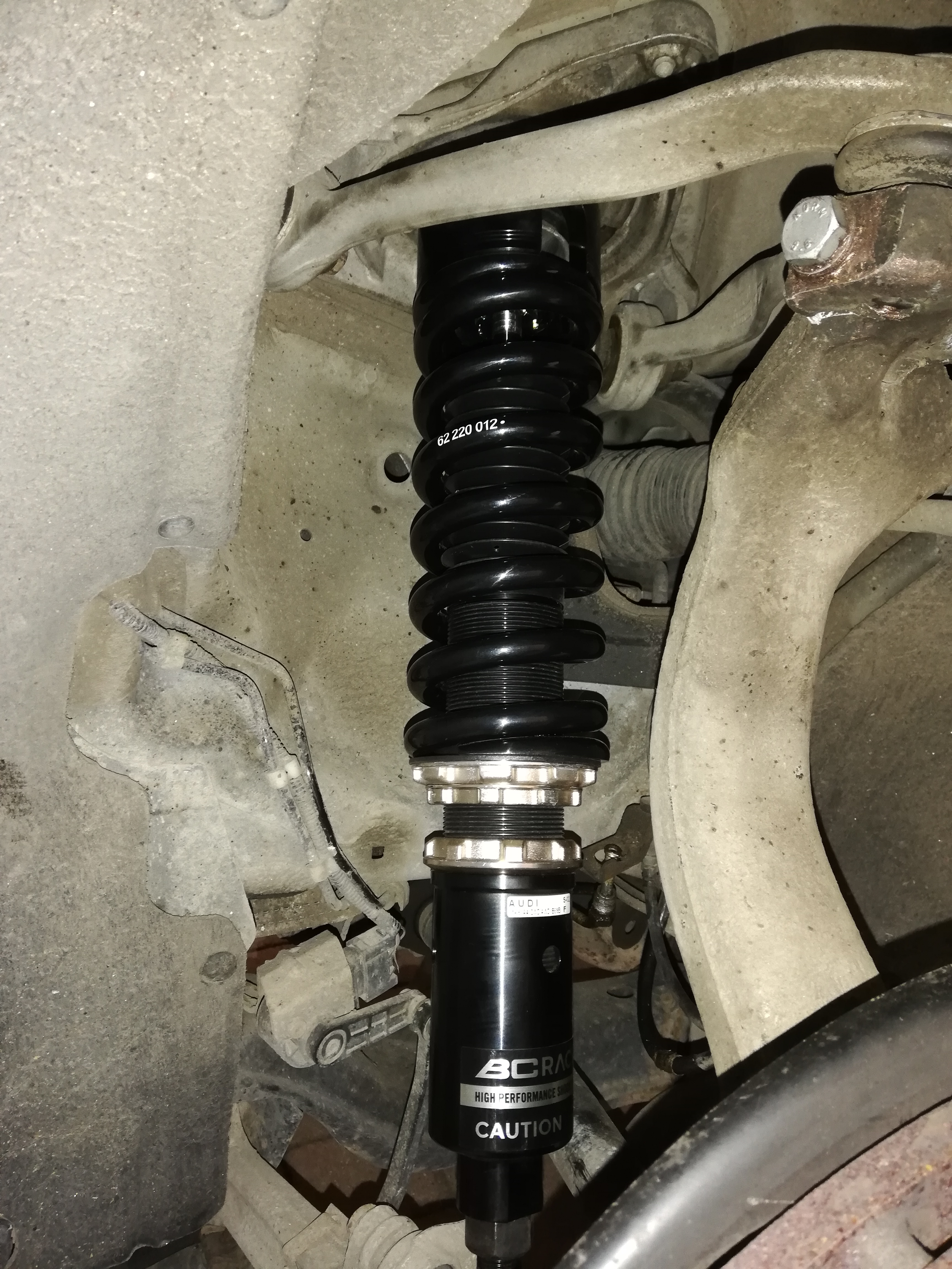

And the front,
I've raised the rear 15mm and the front 5mm and I've also stiffened the damping as it was a bit soft when I went round the block the other day.
Currently I'm 10 clicks from hard in the from and 6 from hard in the back. For some reason it's sitting about 25mm higher now at the back even though I've only wound it up 15mm and closer to 15mm higher than the 5mm i wound at the front
Maybe it's because I've stiffened the damper up, who knows. Gonna go out for some fuel and a drive and will take some photos see how it feels. Now sat at 63ish at the front just a smidge under 64 at the back so will see how it settles.

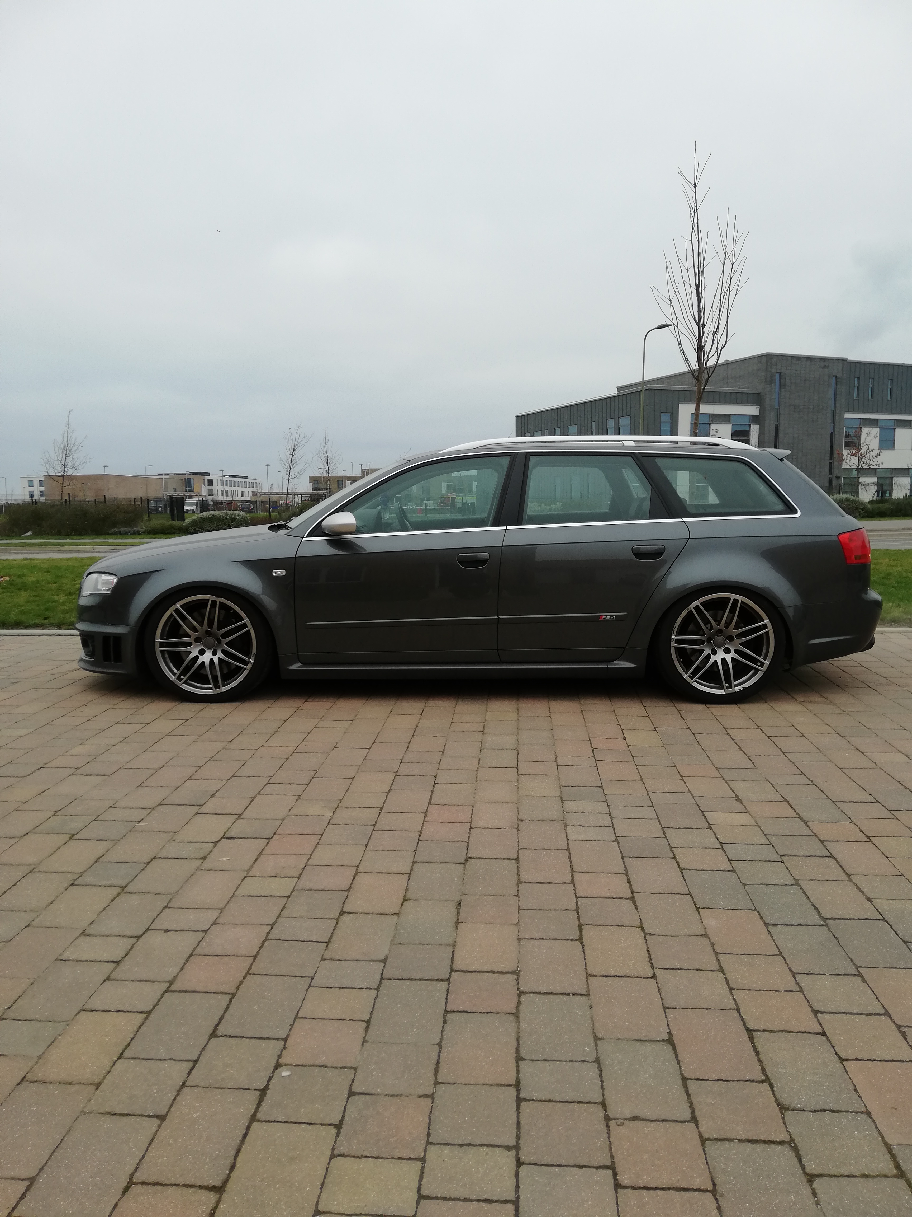

Re: BC Racing Coilovers

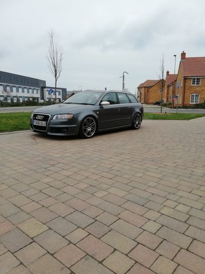

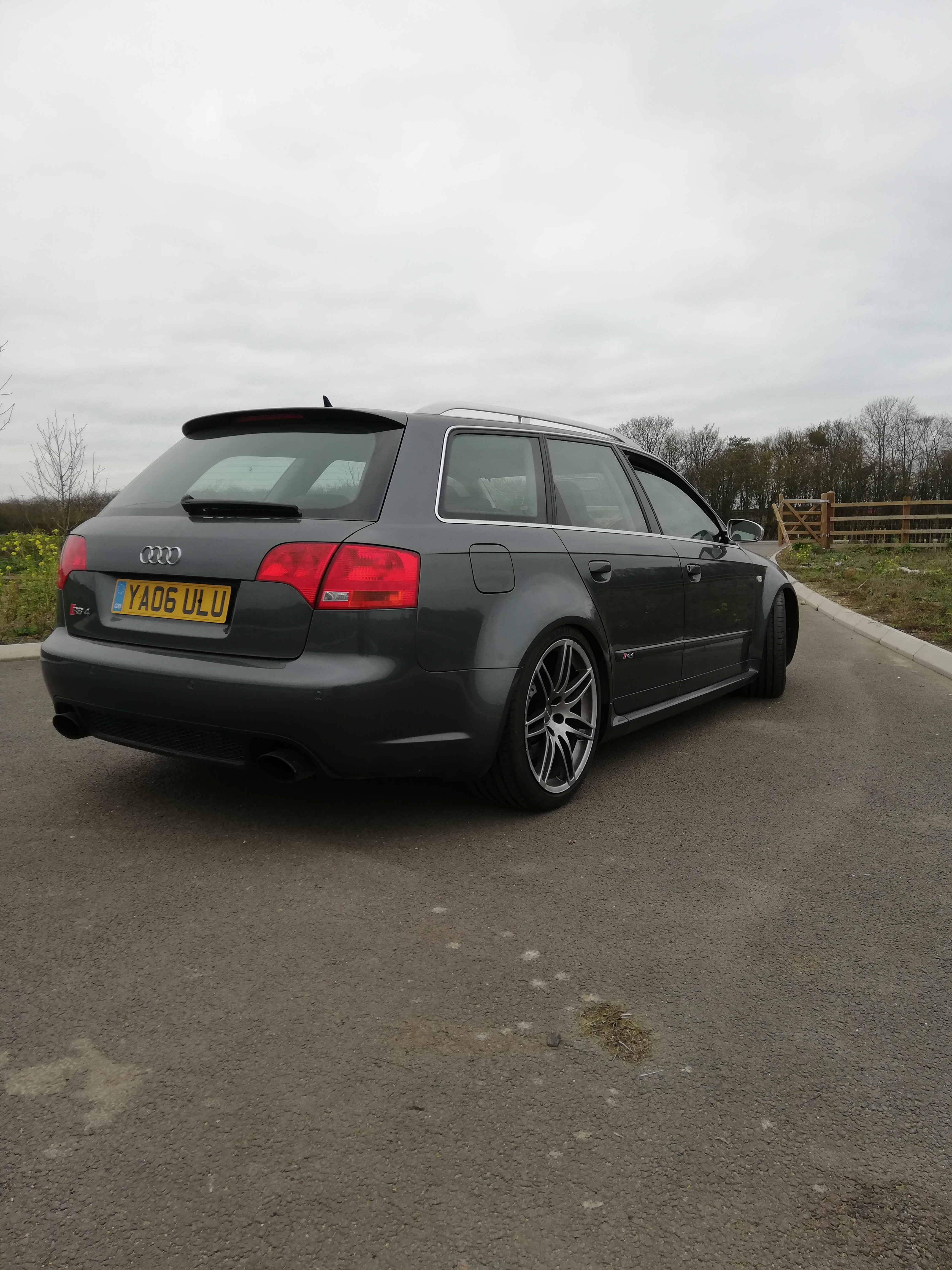

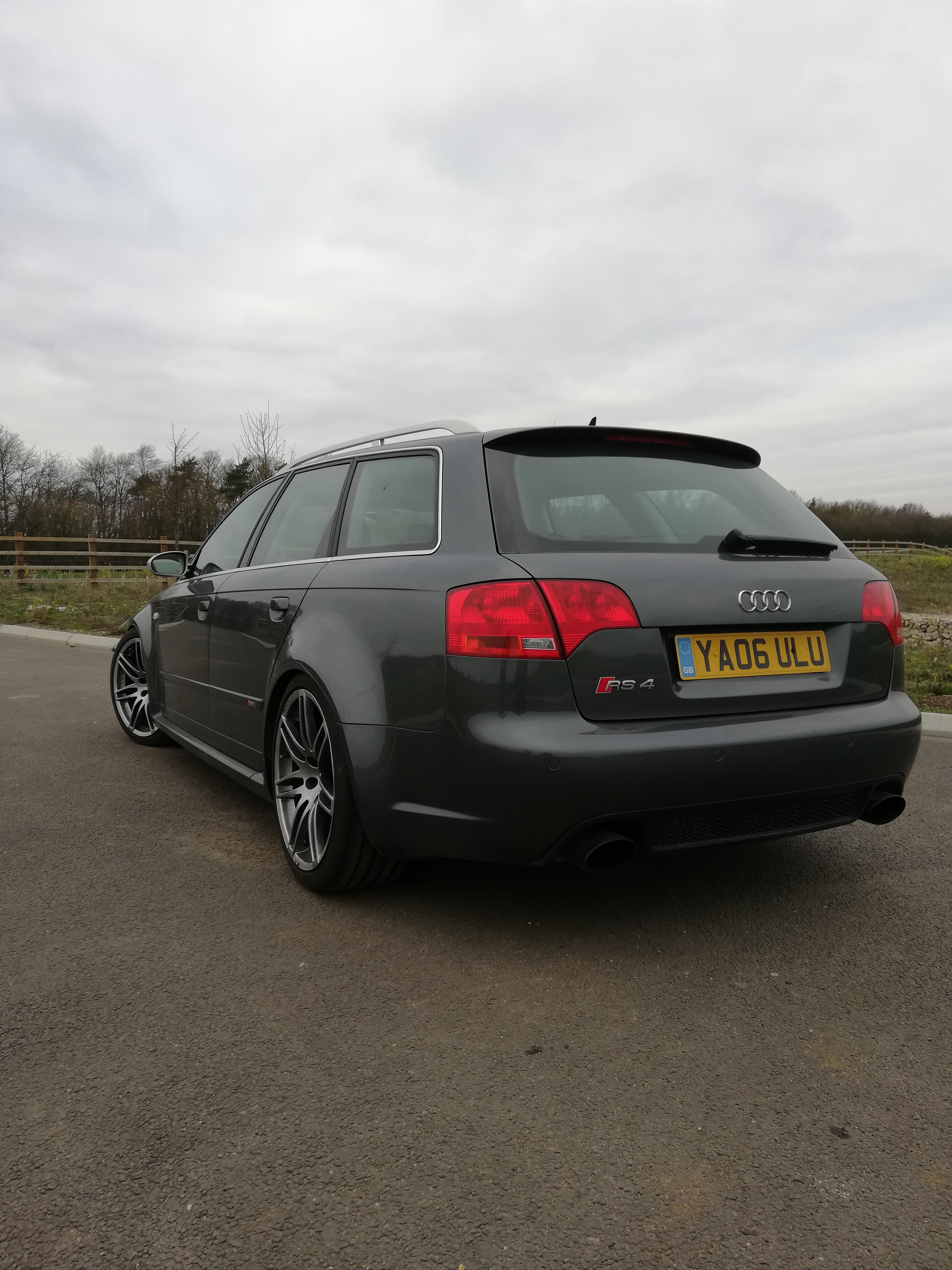

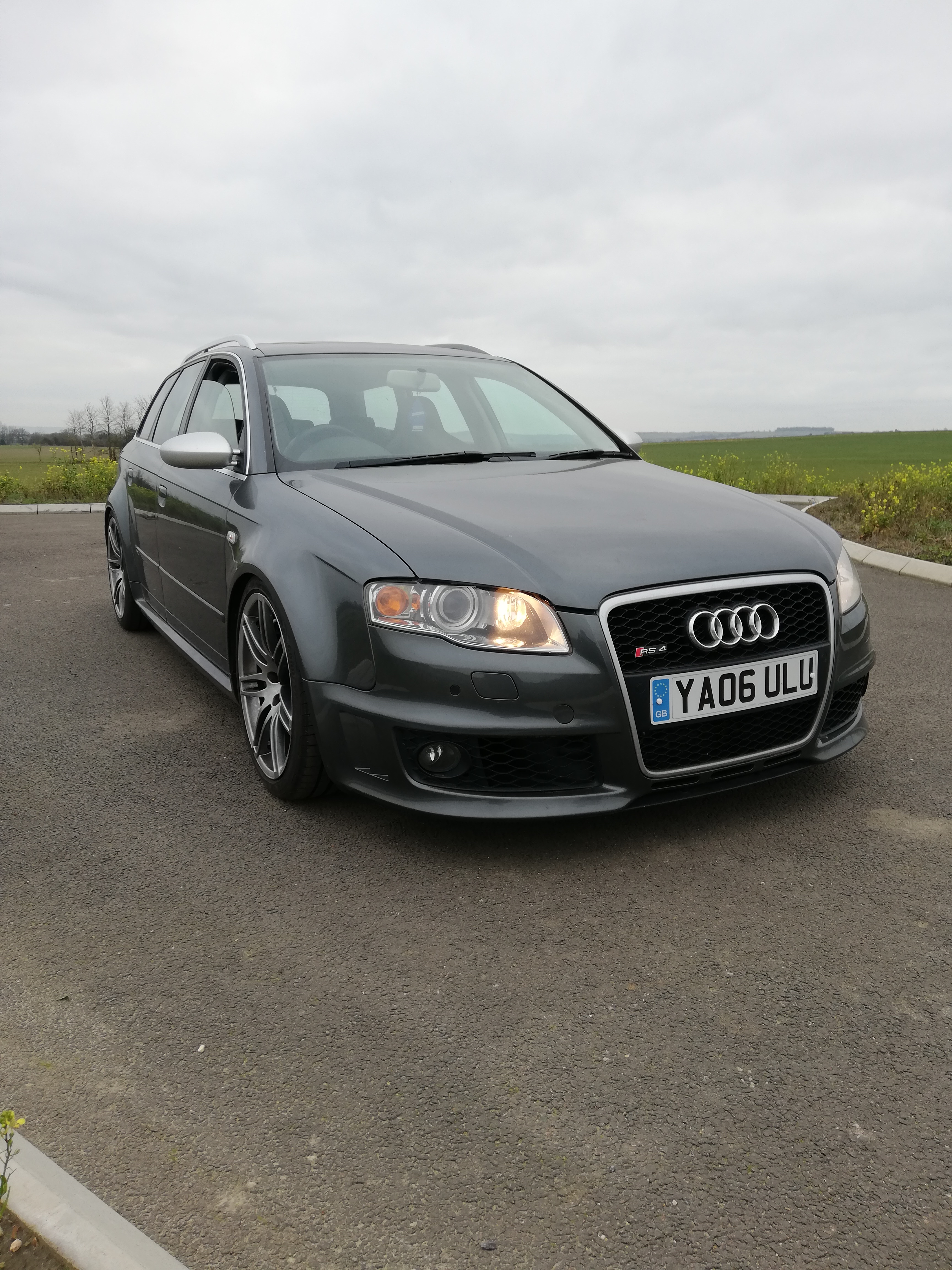

So a few pics from a little drive today, she's settled a little bit now as well.
It feels very good, slightly firmer than DRC I'd say but handles very well. Very planted, I was worried it would be about wallowy but it doesn't seem to feel that way at the minute will have to see as I get used to it again and if so then I'll look into doing the anti roll bars.
One thing I'm getting is a bit of rubbing on partial lock when cornering or turning on an incline for example, the drivers side only weirdly. I'm holding back from pushing too hard til I can sort that.
I've removed the arch liner screw and it's not resolved it as it seems to be either side of the centre of the arch. I'm happy the coils are set within about 0.5mm of each other. I have adjusted the preload when changing the ride height and am fairly confident I set it back to as it came both sides but will double check that also.
They're definitely seems to be less room on the drivers side when going from lock to lock even though wheel to arch measures the same. Will see what an alignment reveals and go from there, but realistically I'm going to either raise it another 5mm or have the arches rolled.
The stance looks great, don't roll your arches; you're heading for a world of pain. Have them heated and tapped back at a decent body Shop as I did. These cars look super menacing when low.
Ride height looks great to me, shame about the rubbing.

Hi there , Just a quick bit of info on the height changes not being the same as the adjustments you made . Due to the Motion ratio on the suspension on these cars ( the shock doesnt move the same distance up and down as the wheels do ) the adjustment on the actual shock will always relate to much more height in reality . There fore if you want a 15 mm lift 7 to 10 on the shock will do it . Very hit and miss unfortunately because when you adjust the rear up and down you change the weight on the front which also makes the car go up and down . Good luck with the set up . My personal experience with BC coilies is that they run too hard. But hope you are happy .

Cheers Shocker, now that you say that and thinking about the position where the shock mounts to the lower arm it makes sense.
A fair bit of trial and error it seems to get it set right although it is fairly close now I feel. It is definitely firmer than DRC but having run some truly awful setups on low cars in the past it still feels plenty compliant enough for my tastes.
