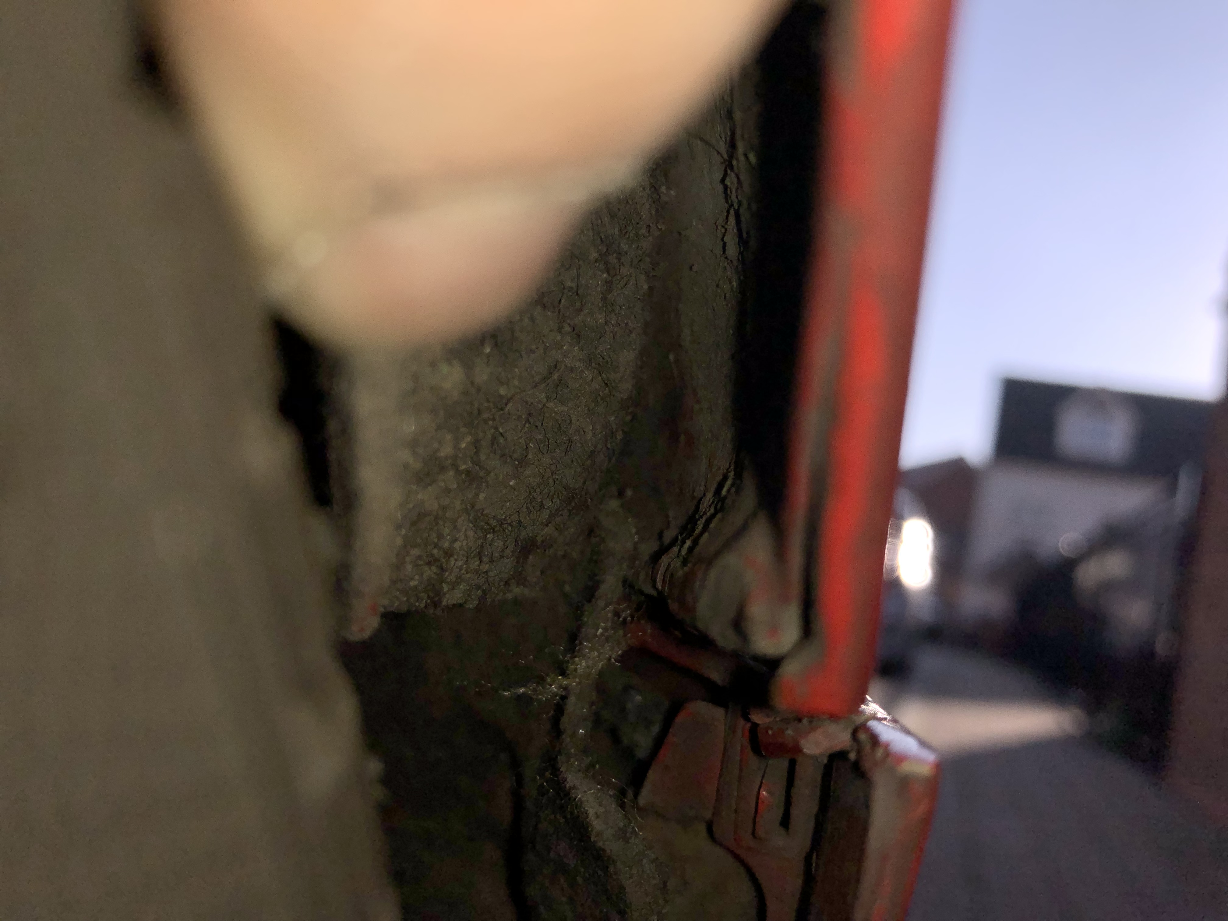

Was wondering if I could sort this out as it’s really bugging me?

There should be a small torx head screw behind the arch liner which holds the bumper to the wing. It looks like it’s missing from the pics.

More pics here
Thanks for any help

I’ve not got mine anymore, sold it recently for an RS6. From what I can remember, if you remove a few of the arch lining screws you’ll be able to pull the arch liner back enough so you can see behind.Image
The screw should be roughly where I’ve circled the picture although from looking at your pictures it seems like your bumper has some damage so maybe this fixing point & screw has been broken off.

Looks as if your fixing point is broken off . You will have to fabricate something to make a new fixing point or secure your old one if it's still there .
