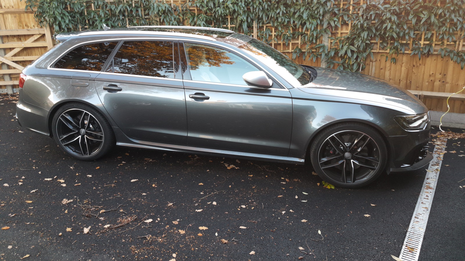

She looks like this currently, already booked in for the usual lightest window tints on the front to sort that out -
