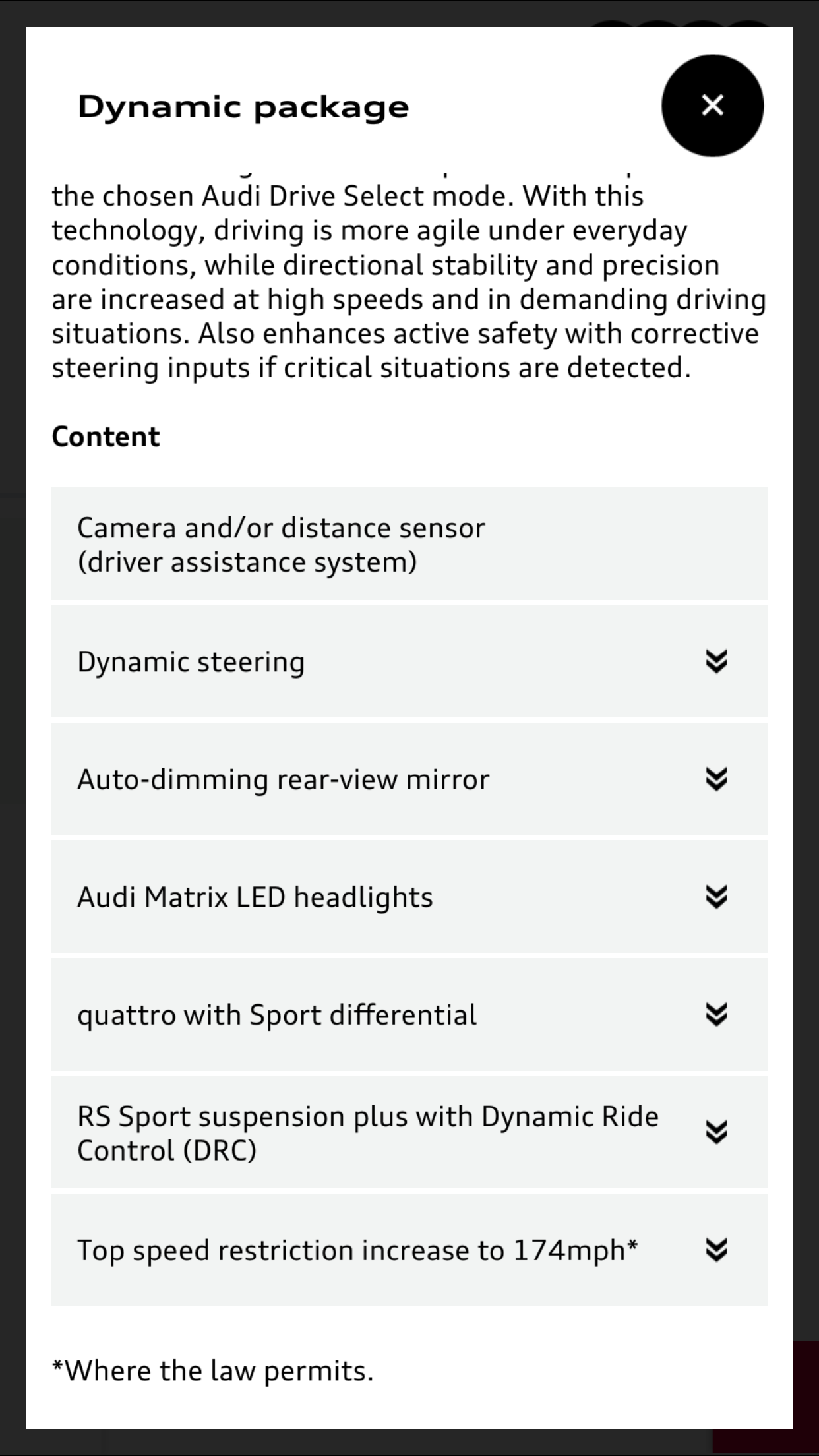

Details of pack

That is not right. Clever LED lights, sport diff, dimming mirror etc are all standard on current RS6. It is just speed limit, dynamic steering and DRC.

But it is still wrong :) Ignore the pictures under the text, they are not right.
This is all it includes - which is what the text on the configurator actually says.
"Top speed restriction increase to 174mph*
RS Sport suspension plus with Dynamic Ride Control (DRC)
Enhanced suspension set-up which consists of a special shock absorber system that counteracts pitch and body roll movement without using any electronic devices. With DRC, diagonally opposed shock absorbers on the car are linked together hydraulically. A central valve varies the shock absorber operating characteristic, for example when the steering wheel is turned and the car is cornering, so that movement around the longitudinal axis (roll) is significantly reduced. DRC uses the same principle to counteract body movement around the transverse axis (pitch) when the car is accelerated or braked. There is a choice of three settings: Comfort, Dynamic or Auto.
Dynamic steering
Improves comfort and handling by dynamically regulating steering according to the driving situation. Allows steering feel to be adapted to road speed and the chosen Audi Drive Select mode. With this technology, driving is more agile under everyday conditions, while directional stability and precision are increased at high speeds and in demanding driving situations. Also enhances active safety with corrective steering inputs if critical situations are detected."
