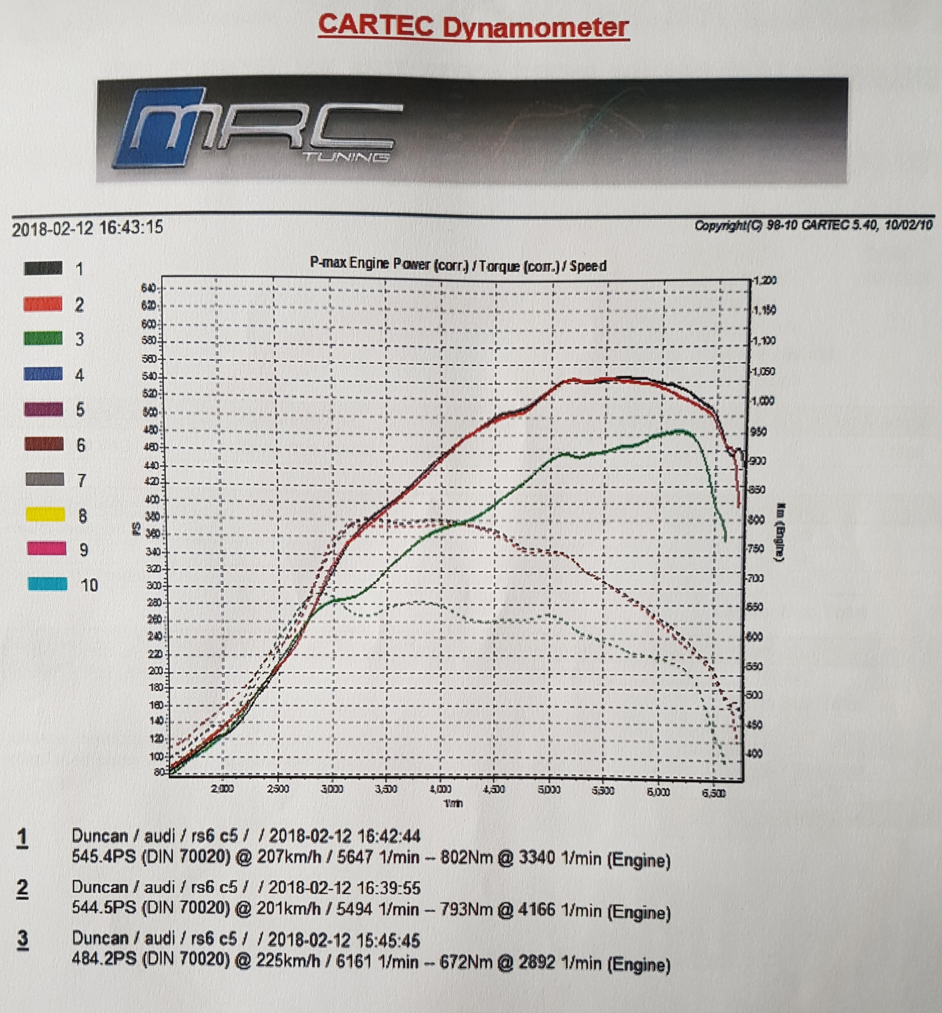

So got the car back from MRC today after they worked their magic on it and fixed the F125 switch.
They did the health check first and found that the car still has the stock downpipes and intercoolers, found no codes in the gearbox and no boost leaks. It is on coilovers, with red unbranded spings which they think is older h&r or other, as they were fitted 2005 I would assume they were the older h&r. The one thing they did find was the bank1 mafsensor boot is split.
The notes on the old remap found it was running .08 bar flat.
Now on to the MRC remap, below is the dyno read...
Oh lord! The MRC tune runs 1.05 bar. The car feels so much better now, also for my piece of mind I am happy now I know what type of tune she is running. A very happy man right now. :jump:

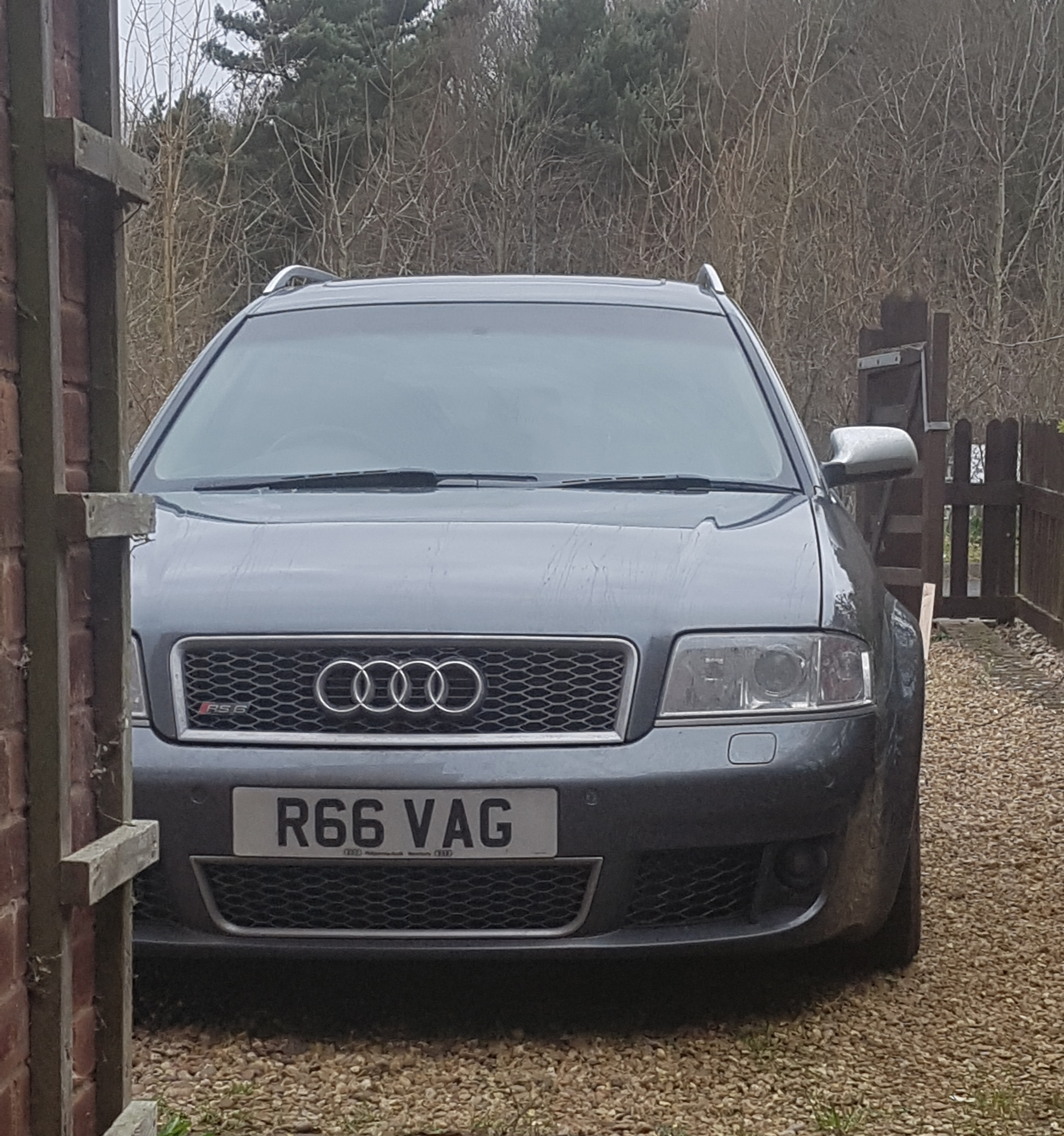

Obligatory picture of the beast after coming home.

I remember when an MRC stg1 tune was 0.9bar - 545PS on stock DPs and ICs is amazing. Have you got another sheet showing DT losses?

Unfortunately not.
I have the above dyno sheet & the health check sheet.

bam_bam wrote:I remember when an MRC stg1 tune was 0.9bar - 545PS on stock DPs and ICs is amazing. Have you got another sheet showing DT losses?
^this!
MRC Stg1 used to result in around 500ps on the dyno (with torque similarly limited to around 800Nm to help preserve the transmission)... and a bit more with catback, but stock DPs.
That's quite an increase!
Simply down to v.low IAT (it's been pretty cold!) and higher boost? Or are we missing something from the history (e.g. hybrid turbos/Wagners/gutted pre-cats/aftermarket cats)...?
DuncRS6
Posts: 285
Re: New C5 Owner
Post by DuncRS6 » Fri Feb 23, 2018 9:20 am
TechNick wrote:
Fri Feb 23, 2018 8:10 am
To be honest with you I was a surprised as you with those figures. I was expecting it just to scratch the 500 mark. Probably should have asked Doug when I picked it up but I was probably a little too excited to drive it after seeing those figures.
As I said in the OP it had Stage 3 AMD Tune and aftermarket DP's but they were removed to stock and de-tuned to Stage 1 by the owner that owned it before the guy I bought it from due to it being to loud for him. The Stage 3 tune and aftermarket DP's were added in 2005 but not sure when it was de-tuned though, there doesn't seem to be any paperwork I can find for that, hence the reason for taking it to MRC alongside the F125 switch that was failing.
Will go through the paperwork again to see if I have missed anything, which is entirely possible but even then the previous owner wasn't aware of it ever having hybrid turbos or Wagners. I will do some more digging and speak to the previous owner again just to double check.
