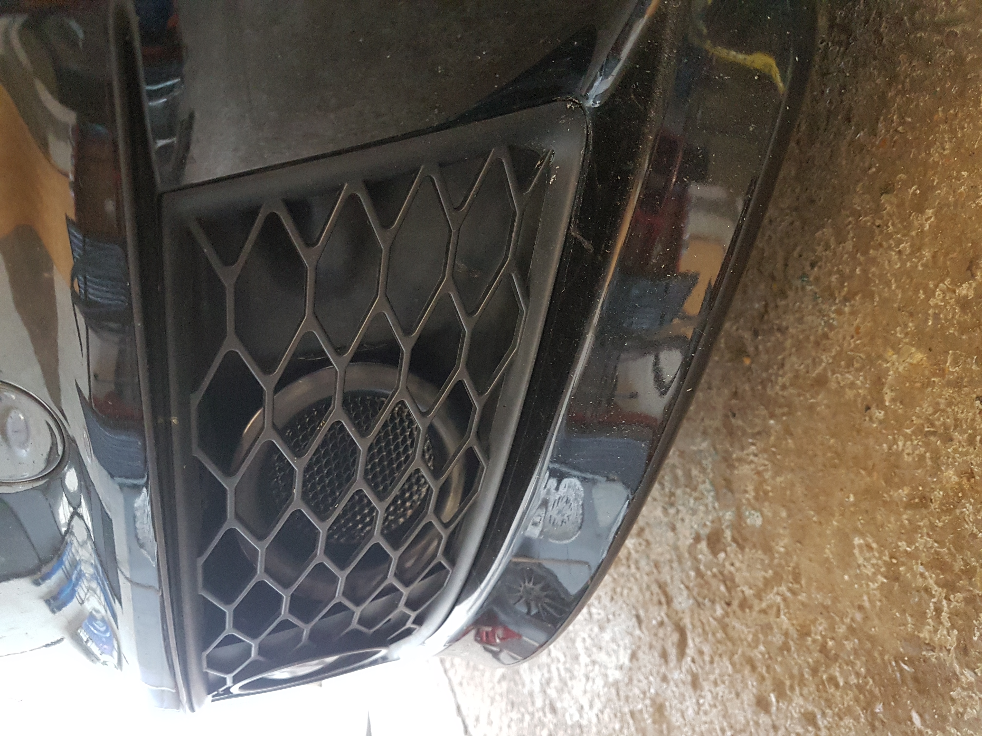

Post by Fun and games » Fri May 19, 2017 8:58 pm
My finished example instead of replacing with another aux rad
