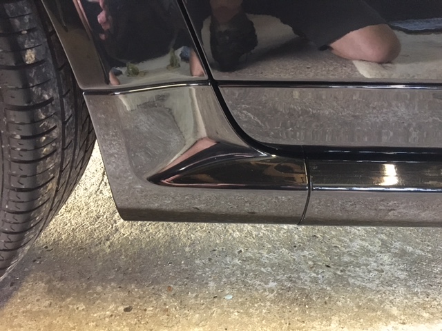

Hi all,
Anyone know how to remove this section of the side skirt?
Cheers,
Simon

looks to be a number of screws holding it in place...
Have a look at this and see if you can work it out :)
http://www.oemepc.com/audi/part_single/ ... g/e#sec_17

Once you've taken the screws out from underneath, in the wheel arch and from inside the door jam, you'll have to carefully ease it off the double-sided tape it is also stuck on with.
Very easy to distort the plastic and cause crazing in the paintwork as the tape is really strong.
