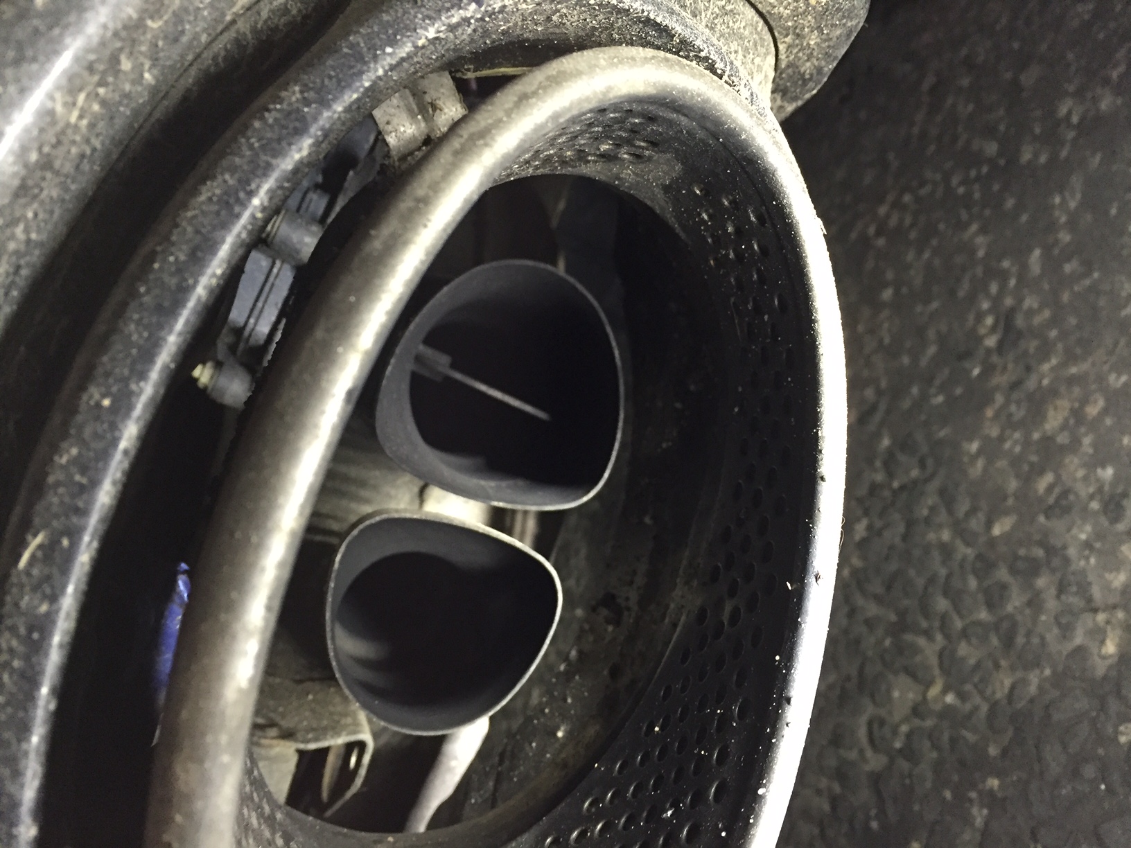

I have run around 300 miles with the flaps open.
Sounds much better, you can hear the exhaust all the time but not intrusive. When running around 50 or 60 and it goes into 4 cylinder mode the drone is deffo louder than standard but again nothing bad. Even when standard that noise annoyed me, the tone is different now and weirdly not so annoying on my ears.
The plus side as it gives an easy +2 mpg. I guess the standard pipe is pretty restrictive when the flaps are closed. No real difference when nailing it as the flaps will be open anyway but wafting around (town and rubbish "A" roads) I continually see over 22mpg I used to see 19 ish before.
Pops and bangs on overrun are deffo louder, I wonder if they only open a certain % in standard form. Sound loud and mean now.
anyway not found any downside as yet.

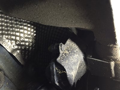

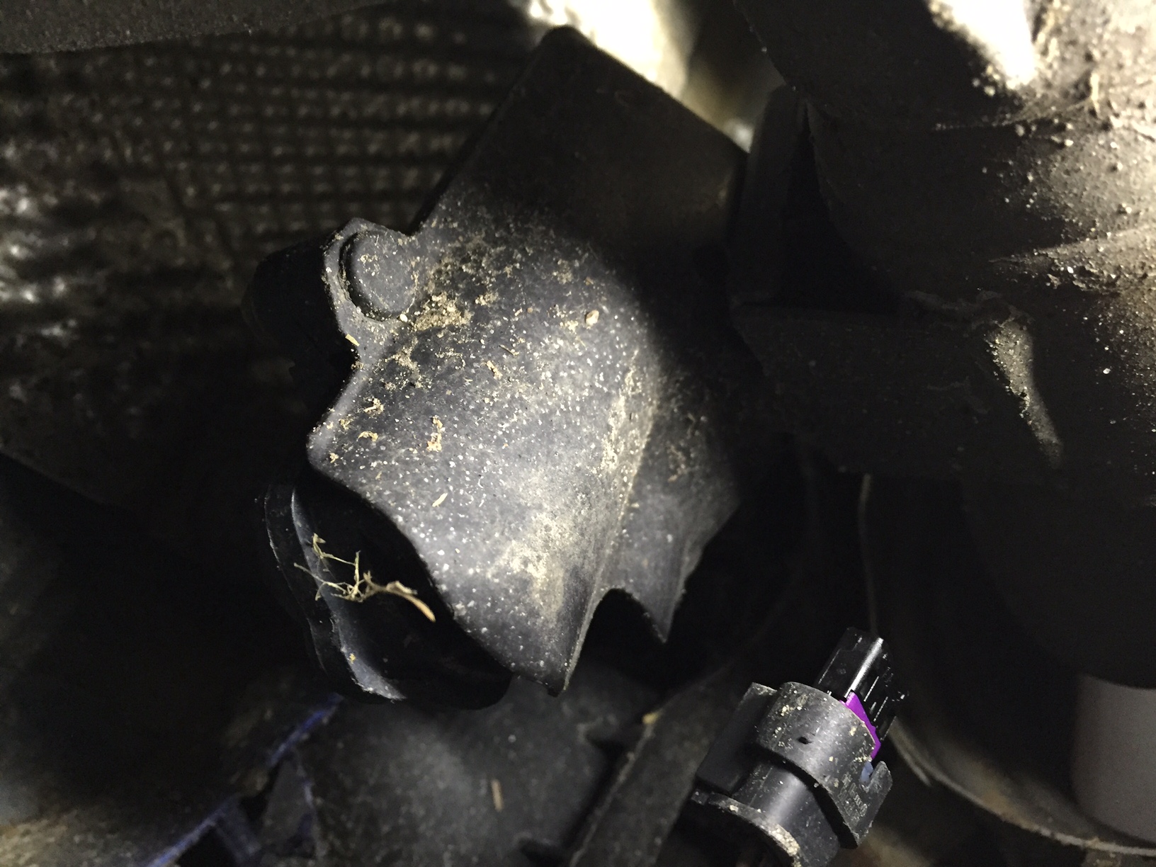

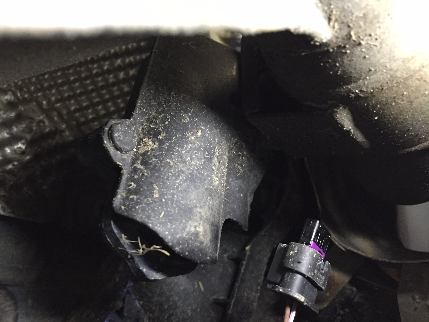

Any pictures to guide me gents?

yes but not very good onesLewy wrote:Any pictures to guide me gents?

Re: Exhaust flap continually open findings
I dare say photos are not required. There is a plug on each valve. Disconnect it. The valves are at the business end of the exhaust i.e. the tailpipes just behind the rear silencers.Lewy wrote:Any pictures to guide me gents?
I think there were some photos on here but I doubt it'll help you much. If you know where the valves are then you are almost done.
Edit: I just noticed there are photos in the post above!
