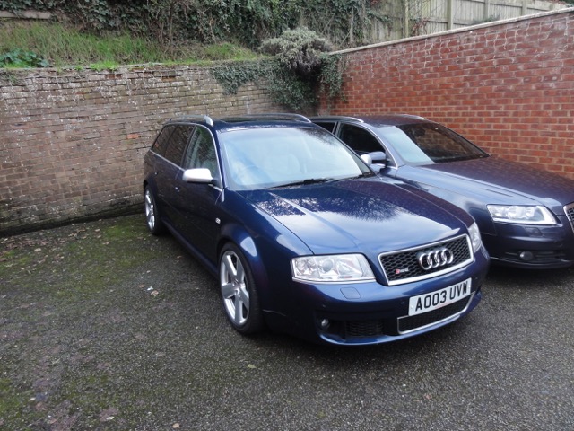

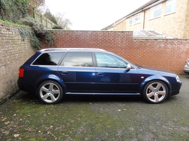

Having succumbed to RS ownership last June, i've eventually plucked up the courage to join the club with a first post:
In order to maintain what's left of our childrens savings, I have a daily commuter (Octavia); leaving the RS6 for weekend fun. A good plan, you're probably thinking - except for the fact that my wife and children hate it when we go fast...doh!
74,000 miles on the clock, and a healthy 538 BHP.
A few bad pictures: I am thrilled with my "investment" (please don't tell the wife the truth!), except for a couple of issues which I would welcome peoples thoughts on. Firstly however, a few words about the car:
Work done by previous owner(s)
Stage 2 remap by MRC - inc. gearbox
Wagner intercoolers
Hotchkis ARB's
Alternator + battery replaced
DRC re-built by Audi
Original gearbox serviced twice by MRC
Miltek exhaust
Dodgy TV fitted
Bits done by me
Alloys refurbished by SWW - very pleased with their service.
Calipers stripped down, painted and re-built with all new seals
MAF's, DV's & N75 replaced
Fuel injectors ultrasonically cleaned and seals replaced
All small bore vacuum lines replaced with silicone tubing
Front discs replaced with Girodisc's and DS2500 pads fitted
Nice new "RS6" mats and SRP racing pedals fitted
Dodgy TV un-fitted (at huge expense), now left with ipod connector

Welcome and FON!
looks nice and in the fastest colour.

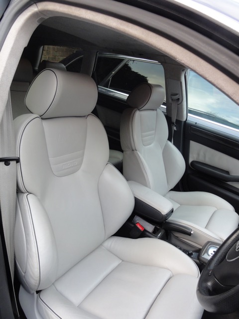

Forgot to mention the best value upgrade to the car (which appeals to my OCD)...Liquid Leather! I love that stuff! It's transformed the old grubby cow skin to some gleaming white, nice-whiffing, prime hide! Don't think it's done much to help with my other "issues" however.

Very nice! Same colour combination as mine. Your leather looks in much better condition than mine though! Can't help on the white smoke front but with regards to brakes- mine also feel a bit naff I've changed the fluid and put DS2500 pads on the front and I'm still convinced that the brakes are better on my missus MK5 golf Gti. I'm going to try some braided lines when it goes back up to MRC, but I'm not holding out much hope.

Welcome to the forum, the car looks great!
