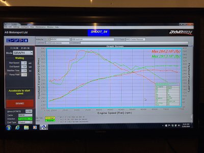

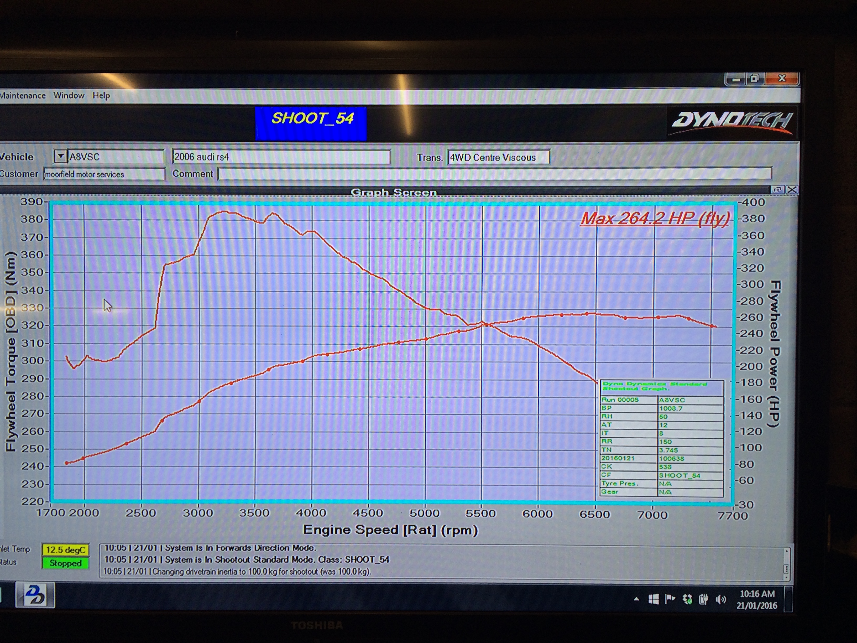

So I decided after having my car since I bought it in October there I would like to get it on the rollers to see what power it was putting out. Just for my own piece of mind. So I got the car booked in and it went on the rollers this morning.
To say I got a shock was an understatement. After the first 4 consistent runs it returned a result of 264.2 HP at the fly wheel. Holy :dung: are you kidding me on is that all....
After some trouble shooting there was a vacuum leak detected at the air box intake valve. This was sorted and then another 4 consistent runs were carried out. This time returning the reading of 291.3 HP at the fly wheel.
Very disappointed as I was hoping it would have been running around the mid 300's.
I'm looking for some advise on to why it is so down on power. I have read a bit about the carbon build up on the intake manifold and that it helps to have it cleaned. But is it normal seeing a reading as low as 291.3 HP?
Thanks for all your help.

Might be worthwhile getting it on the dyno somewhere else just to compare.
Also, have you driven other rs4s to get a feel how quick they should be and is yours any different?
I'm interested as I've done none of the above and mine seems to do the 3rd gear test about right.

mikep99 wrote:Might be worthwhile getting it on the dyno somewhere else just to compare.
Mike
Good idea Mike to get a comparison done, although you would expect the readings to be accurate.
I've never driven another RS4 so I can't compare. What do you mean by the 3rd gear test?

If you have VCDS and a laptop or a Bluetooth OBD dongle and a smartphone / tablet you could log some mass air flow readings which will tell you if you are really down on power or had a bad dyno.
