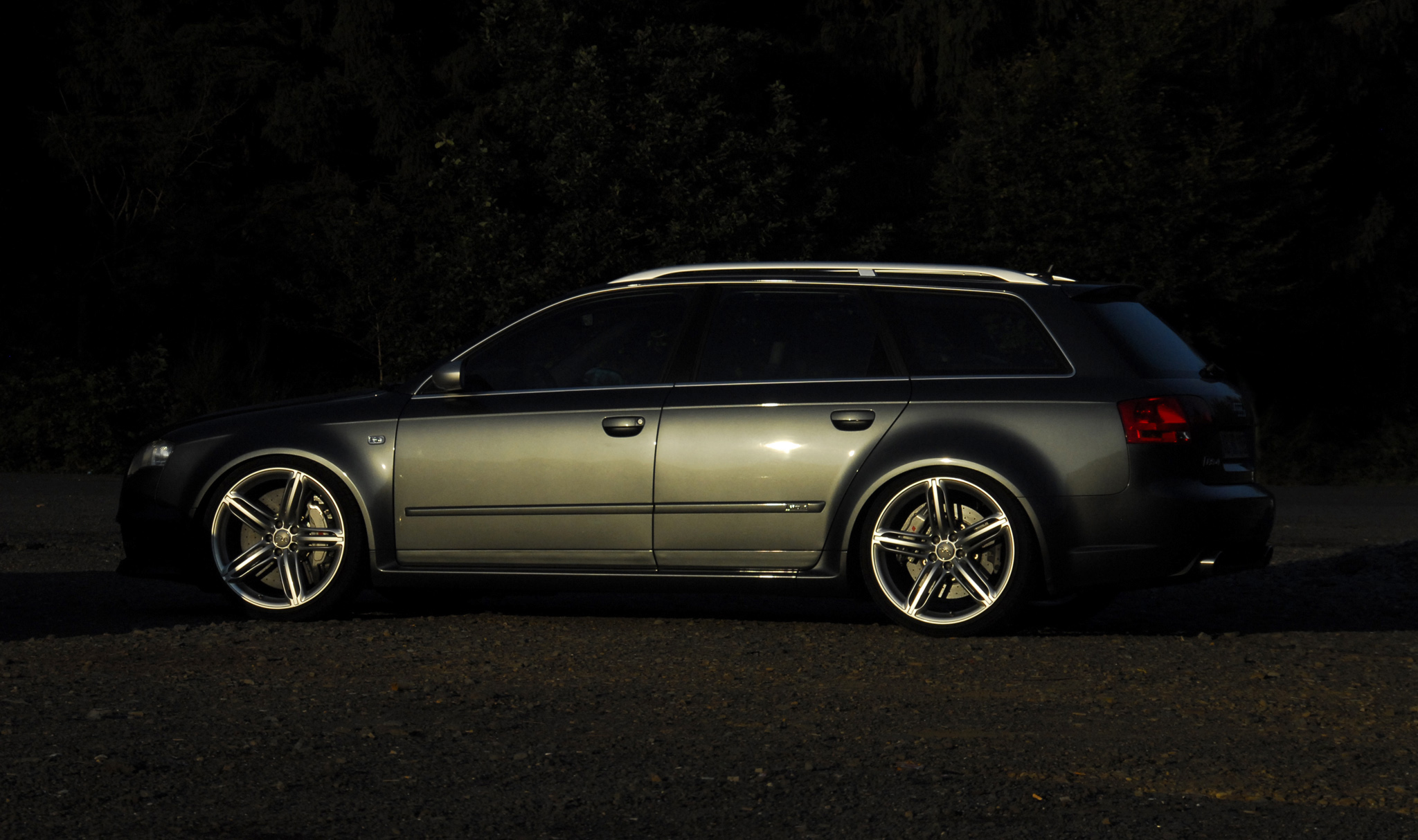

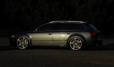

Here are couple pictures of my previous and current rides.
2007 Daytona Grey RS4 Sedan (Canadian Spec, shipped back to Taiwan in 2011, sold in 2014...)
Mods:
Euro steering wheel, 19" BBS CH-R in satin black, blacked out grille and window trim, Bilstein PSS9,
Milltek non-resonated valved catback exhaust, custom 200 cell cat.
Really loved the car, the 6-speed manual, NA V8, AWD, and the sexy wide body.
So here comes the 2nd one...
2007 Sprint Blue RS4 Avant (Euro spec, acquired in 2014)
Mods:
Retrofit R8 front ceramic brake, rear Brembo 4-pot and 380 disc, KW V3 Clubsport, 20" OEM RS4 style rims,
custom suede bucket seats, Milltek non-resonated valved full exhaust (Soon to be MTM full exhaust),
and list shall go on...
