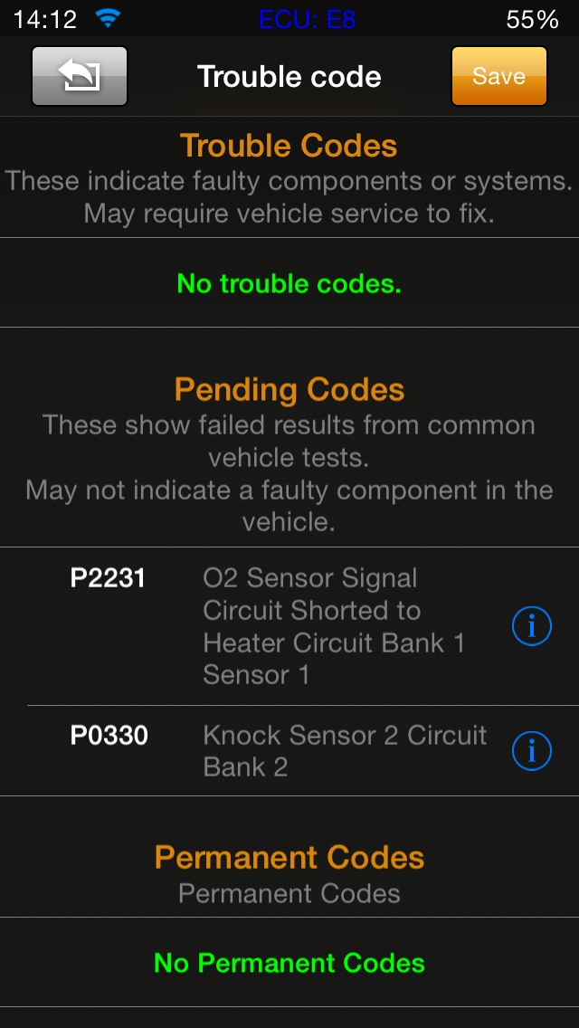

P0330 - knock sensor 2 circuit,bank 2
P2231 - O2 sensor signal circuit shorted to heater circuit bank 1 sensor 1

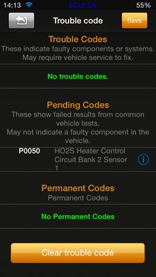

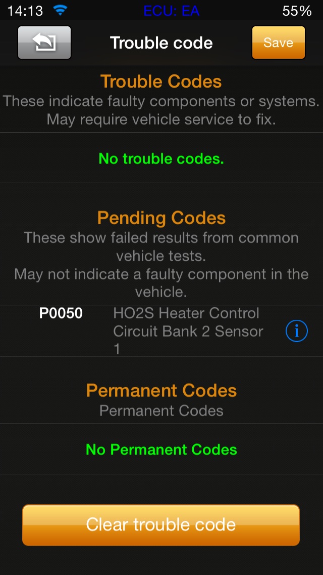

P0050 - HO2S heater control circuit bank 2 sensor 1

P0330 - its about open circuit (wiring) in knock sensor 2,bank 2(there are 4 knock sensors).I was changing that sensor(carbon cleaning in the same time) and the error comeback.Sensor 2,bank 2 is the one from left when you are in the car(driver side in Europe or passenger in England).I was reading that are a error in audi documentation and is posible that i was changing the wrong sensor...
One more thing - im sure the knock sensor code have appear after i was replaceing a O2 sensor(precat) with one Bosch direct replacement.No vacuum leak.Maf sensor cleaned with Maf cleaner.New sparkplugs.
