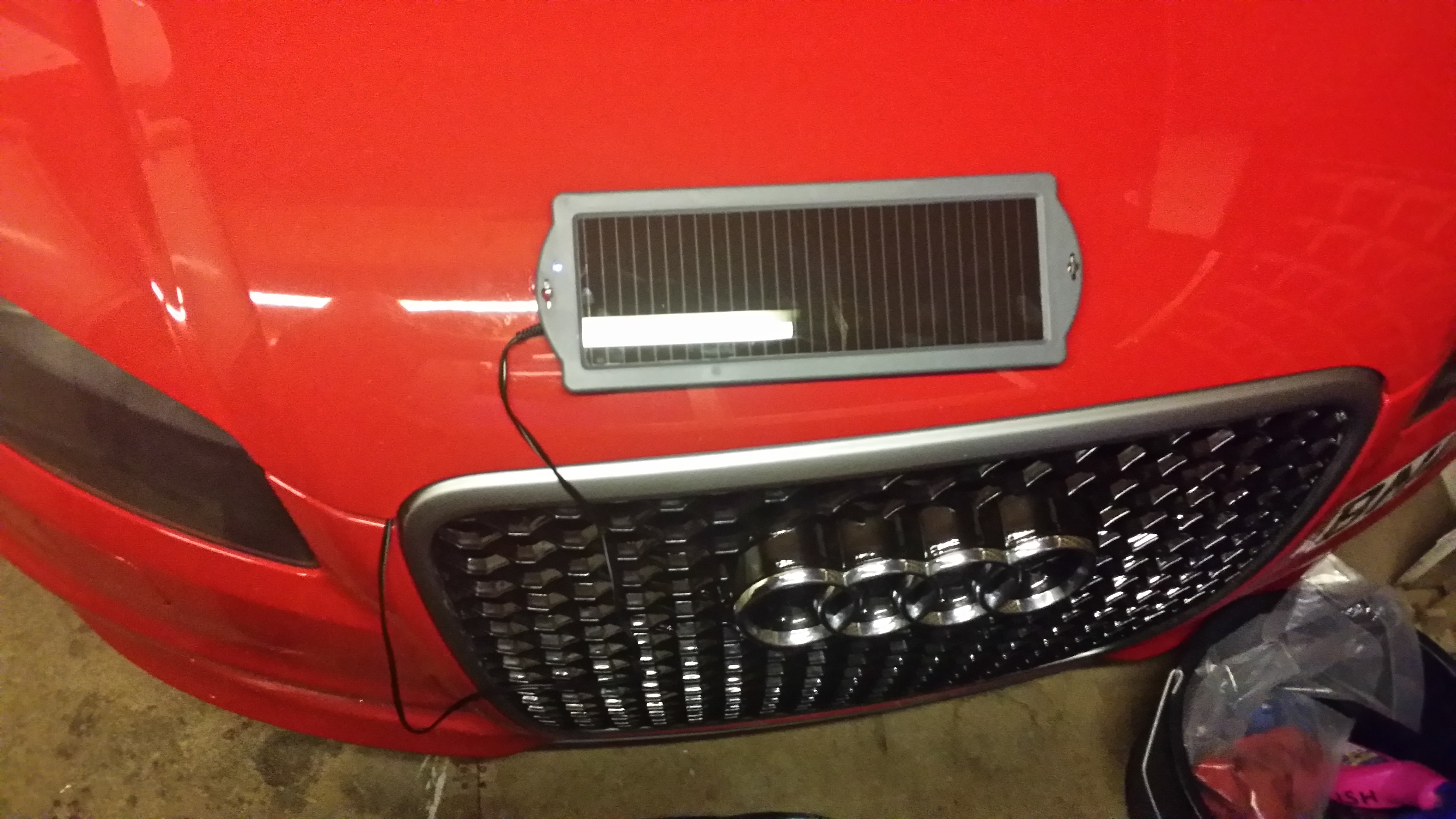

Just as an option for other readers of this thread I went this way. £8.99 from maplins....

I guess that'd work if you were keeping your car outside, not much use inside.

SuprSi wrote:I guess that'd work if you were keeping your car outside, not much use inside.
Yeah, I have windows at the back of Ruby's bedroom (garage) so picks up light from there.
